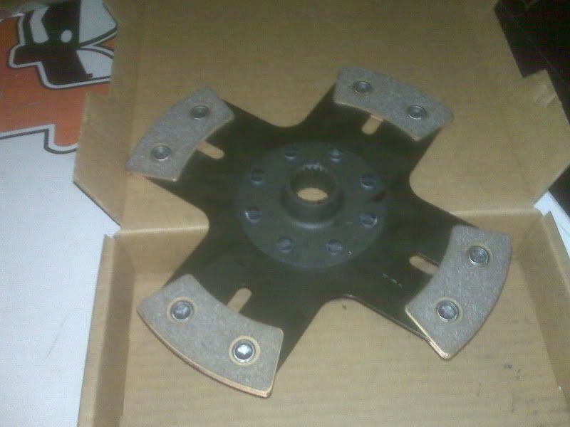

MDM clutch came in. Shit is tits. 88 si 21 spline count with 212mm disc.

mike hooked me up with a 212mm clutch for the 88 trans in the tprc. It was a act disc and his house brand pressure plate.

Yeah I have the same setup on my DX 4DR, 90 SI PP & Flywheel, 88 Prelude Disk Works Tits O0
thats a MDM clutch disc sir.  custom made to my specs.
