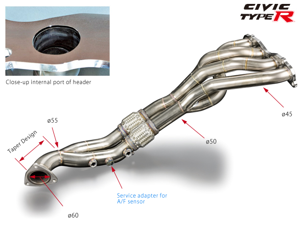

What tittle say, im lokoing for making next month a exhaust header for FN2 R k20 engine , like toda racing one.
but i was thinking about size of piping, since header should be used for supercharged application, so not sure if size of piping im thinking in use for make the header would be biggest..
this is sizes i think shuold be good for supercharger K20
Toda Racing - WR  ;D
45mm - 2" (50mm)
50mm - 2.25" (57mm)
60mm - 2.5" (63mm)
what do you think?

Not sure where you got your conversion from, but 45mm is 1.77", not 2".
I'd go with 1.7" primaries and 2" secondaries with a 2.3" collector to a 2.5"->3" piping.
i didnt any conversion really.
i just said toda racing size and the sizes im thinking in using.
toda racing uses 45mm for primaries, im looking for 2" (50.8mm) and so.

personally, i think 2" might be a bit on the big side, but i don't know much about s/c exhaust setups.  i'd probably go with 1.875" if you can find the bends, then 2.25" secondaries and a 2.75" out.

If you are assuming that their product is already good and close to what you want - just jumping up one size may be sufficient. Since their runners are 14 gauge (.083 wall) = 1.584 ID.. If you went with 16 gauge 1.875", (1.745 ID) you are effectively .161 larger already.
So maybe 1.875 -> 2.125 -> 2.50".

Walter, I've spent some time chilling at Rinehart Racing, who makes $1500+ sets of headers for domestics.  The blower cars get larger everything, starting with the primaries and all the way back to the collector.
For a K-series, with their mutant headflow, I'd start with the 2" primaries and work toward a 2.75" to 3" collector.

As JD said, use "oversized" primaries, shorter rather than longer, and a everything else a bit bigger. 1.75" is considered good for a 1.8L SC'd motor, so 2" is probably the best idea. A 4-1 collector will help move the powerband higher, which is ideal since the blower's inefficiency drops torque the higher you rev. You really won't need extra torque below 5k anyways, unless the dumbass designer is using an M45 on a k24...
The other main aspect behind shorter, wider piping is because you have so much more scavenging. There is practically zero backpressure like a turbo motor has, so the SC pushes your remnant exhaust out like nobody's business.
