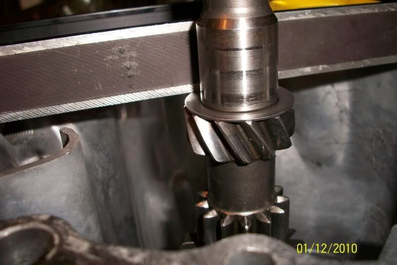

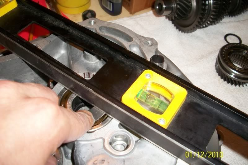

After changing the bearings and seals on my SOHC trans, I followed the Helm manual to measure for the mainshaft shim.
Helm instructions are to take two seperate readings and follow the formula:
B + C - 0.95 = shim thickness.

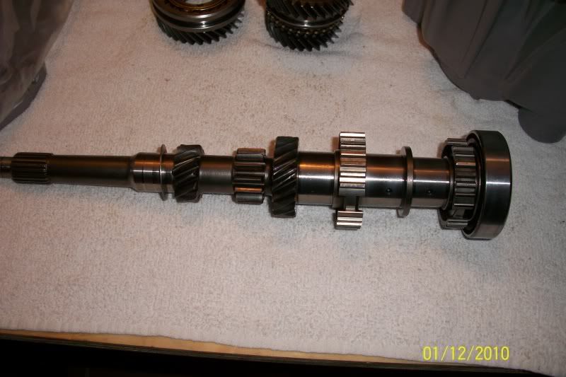

To determine factor "B" in the equation, the following must be installed onto the mainshaft as shown in my pic.
Thrust washer
3rd/4th Synchro Hub
Spacer Collar
5th Synchro Hub
Bearing
After the shim and oil guide plate are removed, the shaft is installed back into the housing.
A measurement is taken from the housing and the thrust washer.
The distance for "B" is Zero
The next factor is "C", and this is what we need to measure:
The measurement for "C" is 1.11mm
So the formula is A+B-0.95=shim size, right?
0 + 1.11 - 0.95 = 0.16mm
The only problem is there is no shim size less the 0.60mm.
I have no idea what I am doing wrong. If you have any suggestions I would appreciate hearing them. TIA

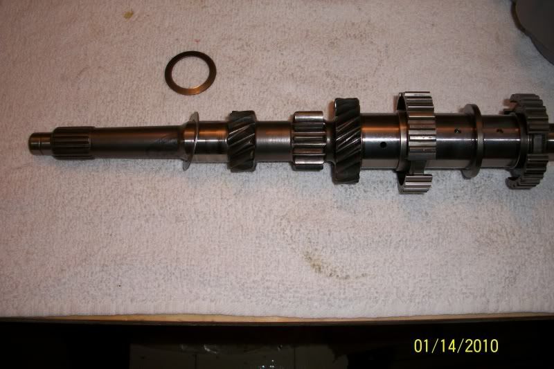

I am installing only one washer, the thrust washer (left in pic), not the spring washer.
I just remembered that when I disassembled the trans, there was no thrust washer. Only the spring washer was installed. That is most likely why I am having this obstacle.  :P

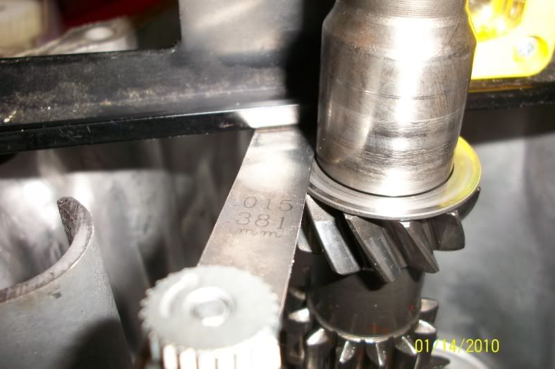

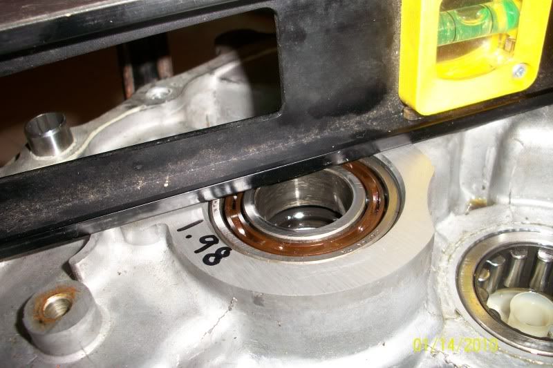

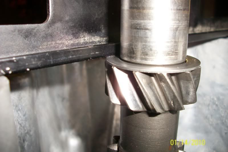

I had a spare trans, so I went ahead and did the same measurements.
The same parts were installed on the mainshaft.
Then once measured I got a reading of 0.381mm
On the other side of the case I got a reading of 1.98mm
I did the math and this is the conclusion:

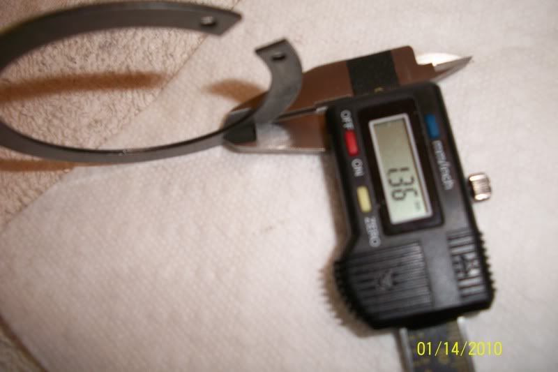

A+B - 0.95mm = shim size (On this trans Honda installed a 1.36mm shim)
1.98 + 0.38 = 2.36mm - 0.95 = 1.41mm
Honda installed a 1.36mm shim. This is pretty close to the figure I ended up with.
 8)

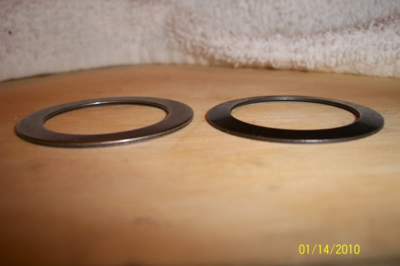

     I aim for .008-.010" case gap with just the mainshaft and washers properly installed.
My math, the spring washer is .030" thick material, but .046" tall, meaning it has .016" to crush.
.016" - .010" case gap = .006" left as would be measured with correct tools that Aquafina uses.

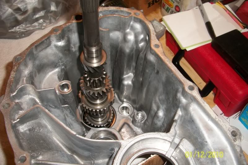

I understand the principle. The spring washer will only collapse so much, but, where exactly are you putting the feeler gauge if both of the halves of the trans case are together? A pic is worth a thousand words.
This is a pic of what the spare mainshaft looks like in the case I am rebuilding. There is no gap. It could be possible the case is defective.

I was just informed that 1989 trans do not use thrust washer, only spring washer.
DOH!
Re:SOLVED Cable D series Trans Help SOLVED
« Reply #11 on: January 15, 2010, 06:49:03 AM »
DOH!
spring washer = thrust washer
88-89 doesn't use spacer washer.
The feeler gauges measure the gap between the cases.
