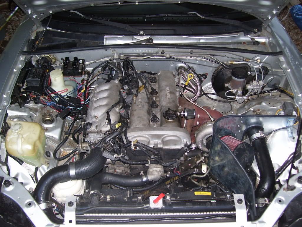

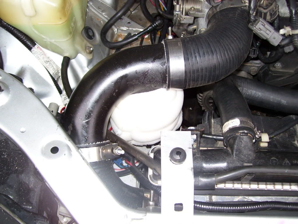

It was me.  :D I wrapped my knockoff tial 50mm BOV in foam. Makes in very quiet. Before, it was loud as balls. Now you don't hear it at all unless it's a full boost pull and I slam the throttle shut, and you barely hear it and just for like 0.1 seconds at that. Basically you don't hear it anymore.
Bought the foam at walmart for 12 bucks I think. Zip tied it on. Put a random hose clamp around it too for good measure.  :noel:
If you think it's gay, you're right. Have a cookie. And cry when your fail wheel drive honda gets waxed by a seemingly stock quiet gay miata.
