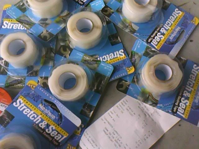

went to harbor freight and picked up some self-fusing silicone tape on sale foe 1.17 each. its rated up to 500 degrees.

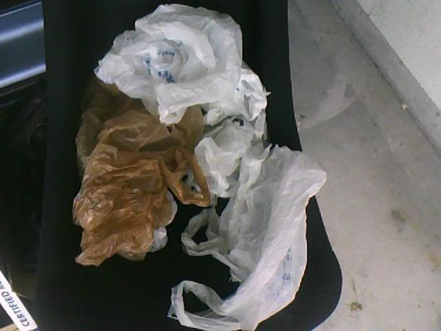

got some plastic bags to make a mold  from.

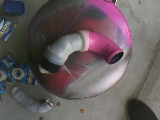

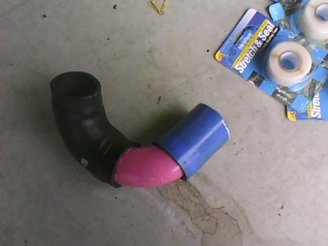

this is what i want to make from silicone

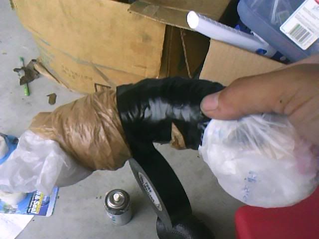

making the mold,. this is about the time i realized i should have got some foam rings from walmart. fuck it, keep going

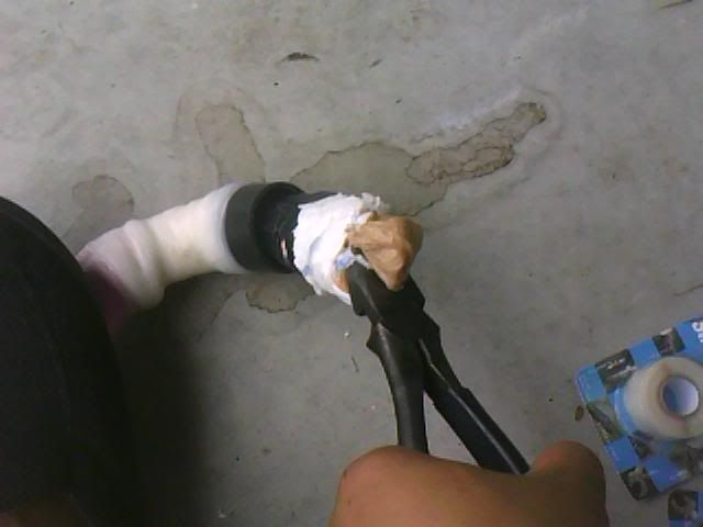

finished the bitch up with a scrap of silicone coupler on one end and coated with wax for easy removal.

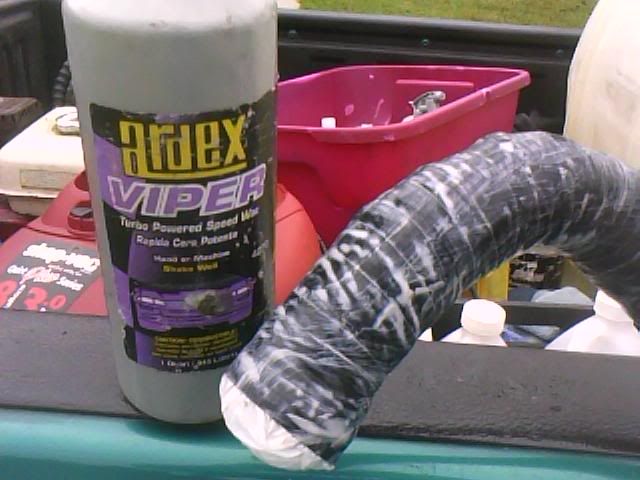

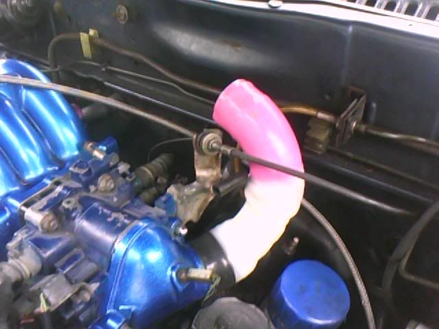

i fucked up and some how erased all the pics of winding this bitch up. but i laied down 3 rolls, and ended up warping half to tight, so it was like 1.5 inch inside diameter. i trimmed it down and jammed the pink 90 into the thing. wrapped the silicone part in a few coils made of a wire coat hanger. then laied down the other rolls of silicone over it.

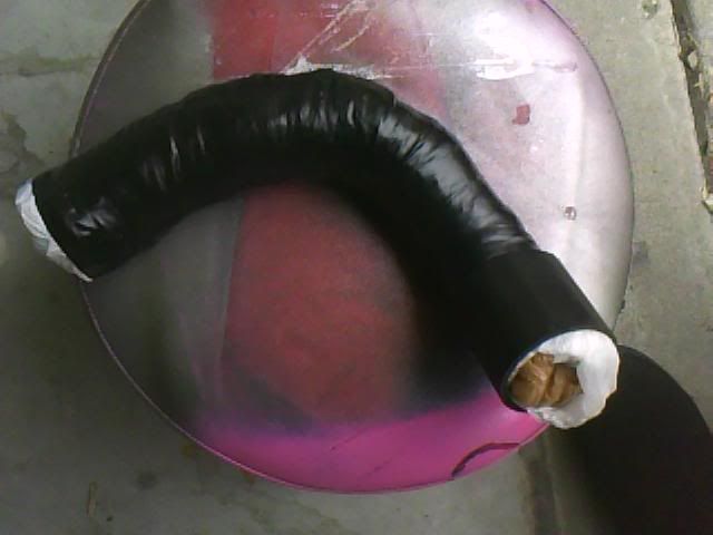

pulled the plug

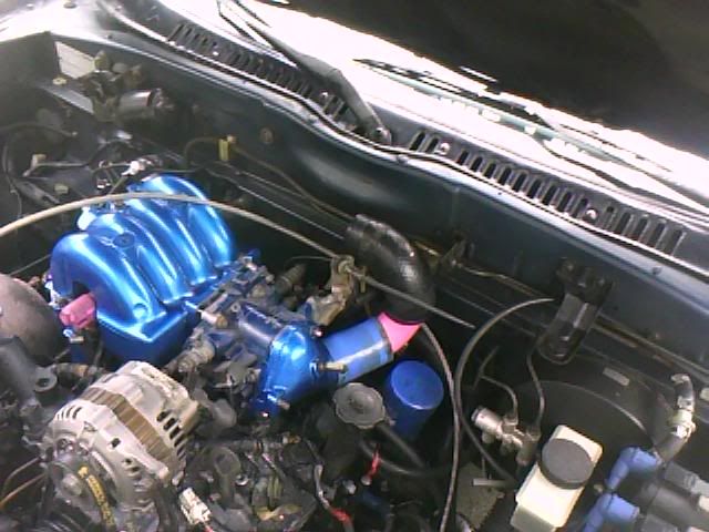

fit like a charm.
not bad for 20 mins of work, and if i had got the foam rings i could have had perfectly round tubes. i will redo this one day, and i might just do all the charge pipe in silicone with either metal coils like this one, or do the core of the coupler with liquid silicone and fiberglass tape.
here is the extra that i fucked up.
