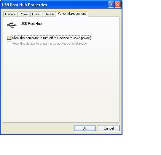

You could add a pcmcia usb card. It could laso need the MB drivers updated as well. If those don't work..
Give this a shot, right click on my computer, select properties.
go here:
right click, select properties
Go here:
untick all computer to turn off this device to save power.
Do it for all hubs and reboot.

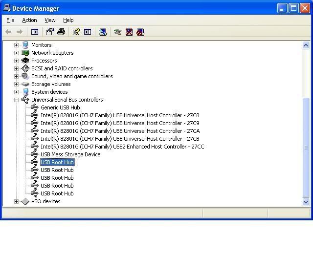

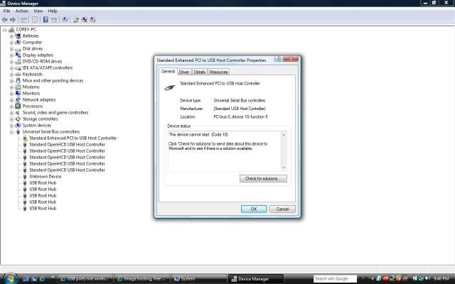

I'm not seeing any motherboard related drivers, meaning it's probably a generic Intel/etc chipset.  Open up the properties for the USB devices that have ! next to them, can you tell us exactly what it says?

under system devices, does it say anything about intel or via?
What is the processor?
