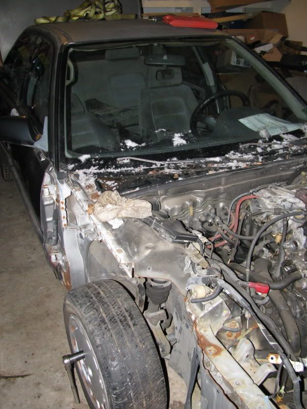

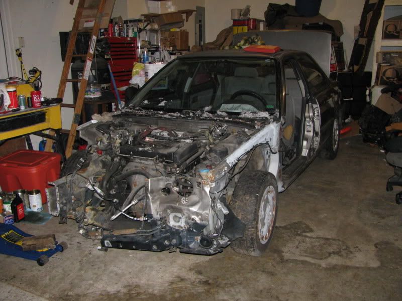

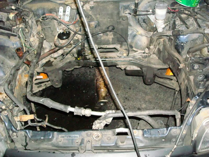

Might as well make this a build thread.  Added a few new bends to the A/C lines and got everything pulled

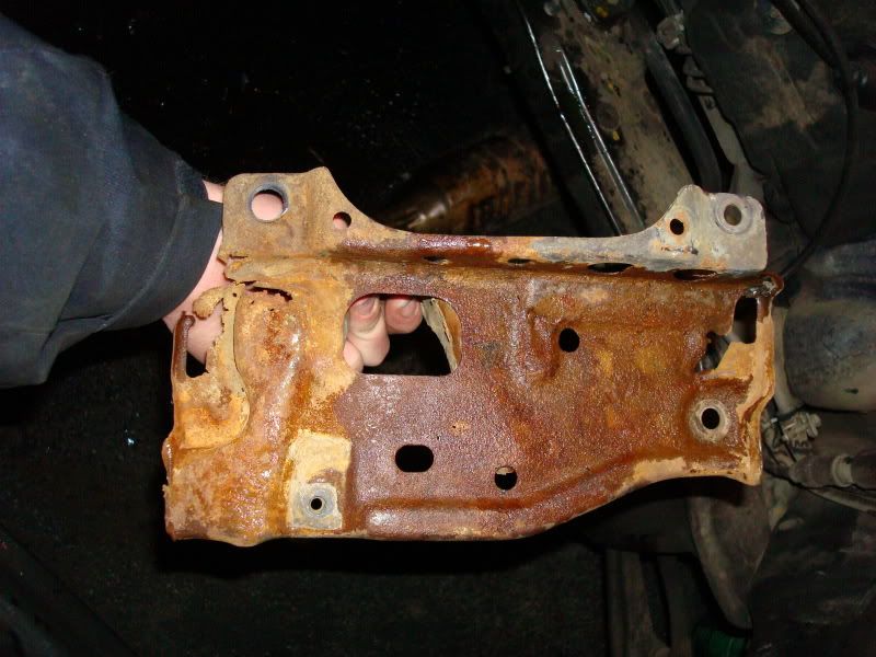

The rustiest part of the car.  I'll probably be looking for a replacement one if the Integra doens't have one
Easiest way to get the bitch pin is make sure the car is jacked up enough for the linkage to come with everything else.  At least that's what I always do

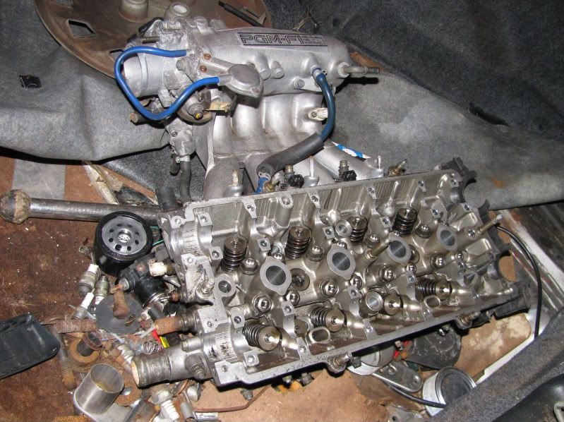

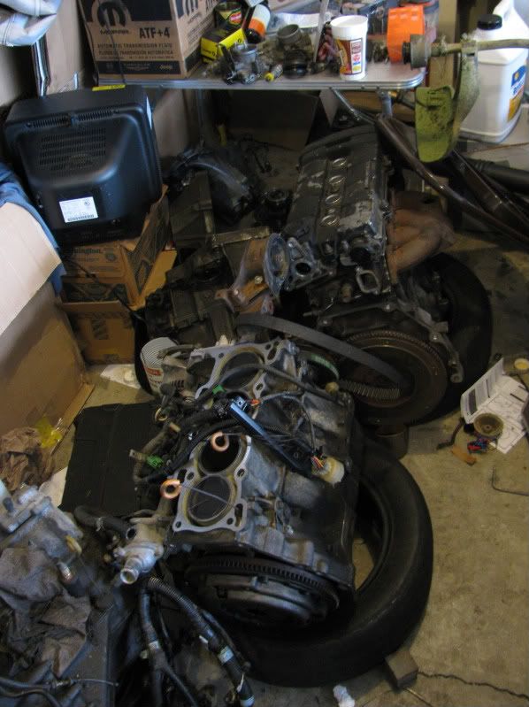

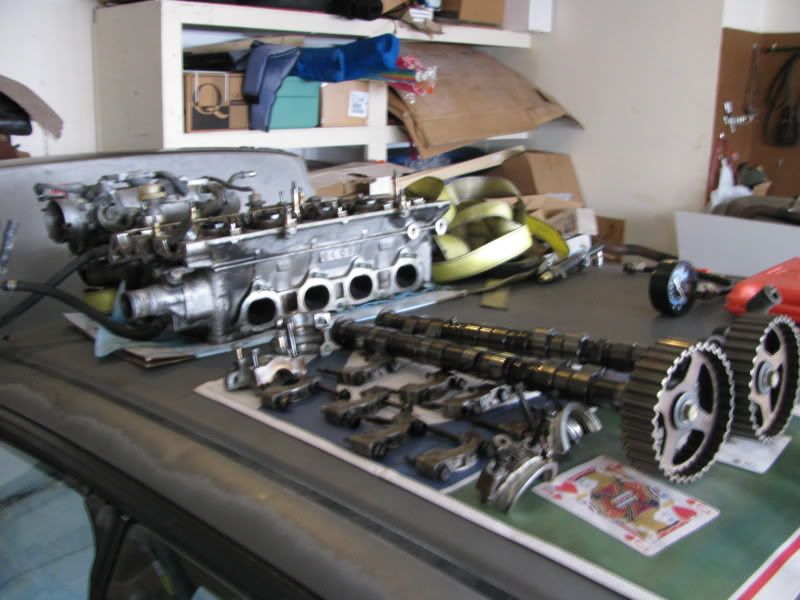

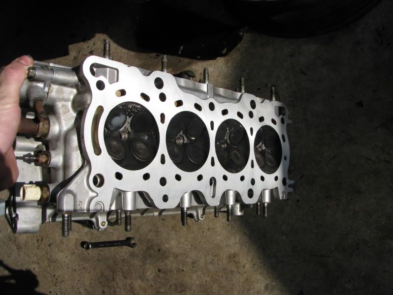

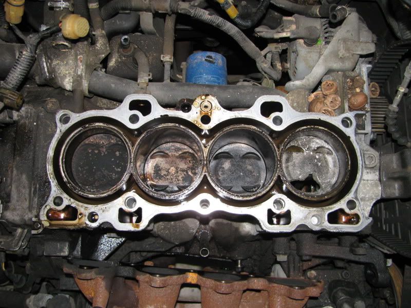

Parts car with supposedly bad head gasket
i was really hoping the drivetrain was good seeing the odometer
FABLAD: who the fuck wants to pull cams when taking a head off
The 'bad' head gasekt
Free head that was in the trunk
Random shit I hoard, including a the B18B1 long block

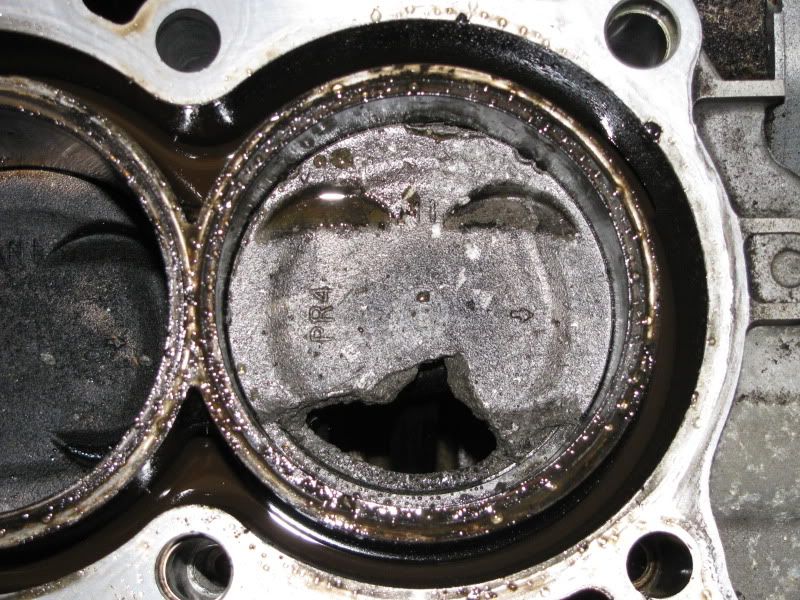

batteries died in the camera, but the B1 head is off, and the pistons look good.  I want to take a look at the bottom end later and see what kind of shape the bearings and crank are in.  If they look good, then they are getting reinstalled as is.  I think I'm just going to take one of the 3 LS heads I have and thow it on the B1 block after getting it checked out and probably shaved for flattness at a machine shop.  I could be mistaken, but I think the A1 and B1 head castings are identical.  It is just the cams are different.  I should have enough parts to make a complete obd0 motor for the civic

Wow, that's bad. All I can guess is the O0 tried no2 out w/o extra fuel and had some really fun preignition.
Re: It's not a hatch, but JD should be proud
« Reply #49 on: February 11, 2010, 10:15:24 PM »
beats me what the fuck happened to it.  i think the block is salvagable with an overbore, but i just might part it out.  keep the rods for a d, sell the crank/pan/whatever else, scrap the rest.  looks like i have at least 2 good complete heads with IM and another one that might need reworked and an an IM that needs a TB.  going to tear into the b1 bottom end tomorrow

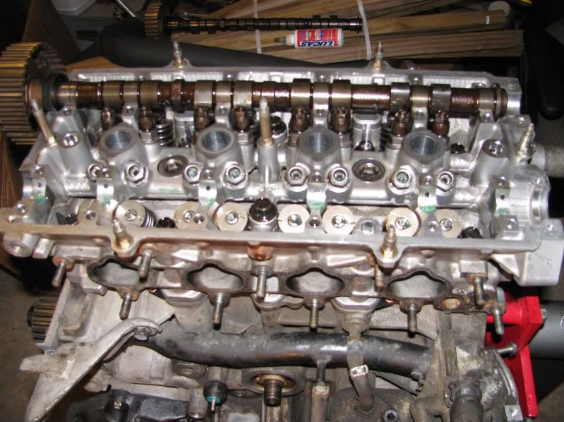

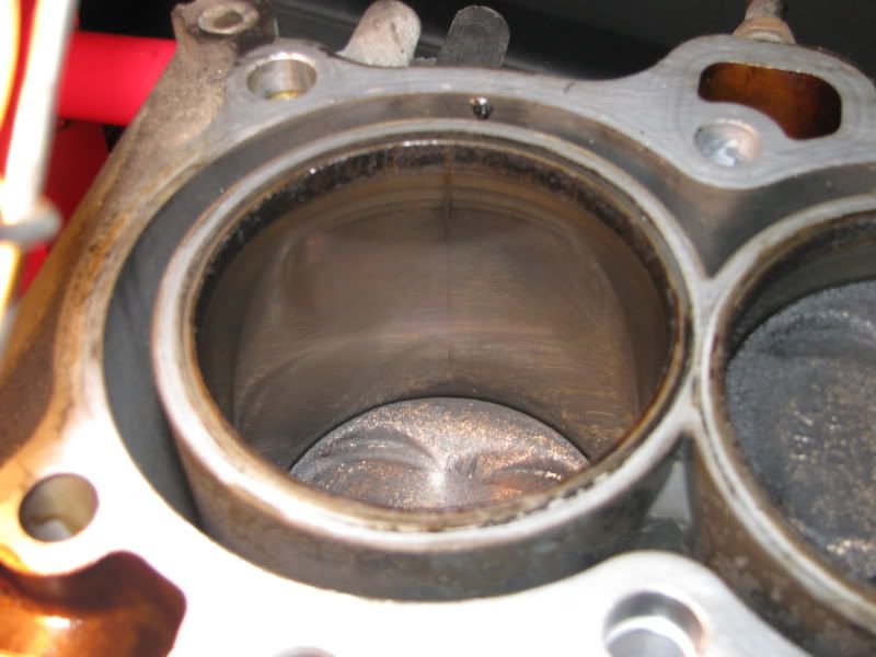

of course things take longer than hoped.  the b1 spins really easy, so i'm not going to pull the mains and rod caps to look at the bearings.  the only thing that bothers me is in one of the cyls:
see the small discoloration from i guess a ring end gap on the wall?  anyone think that will be a problem in say, the next 500 miles?  it isn't even a grove that i can feel with my fingernail so i'm not too worried about it.

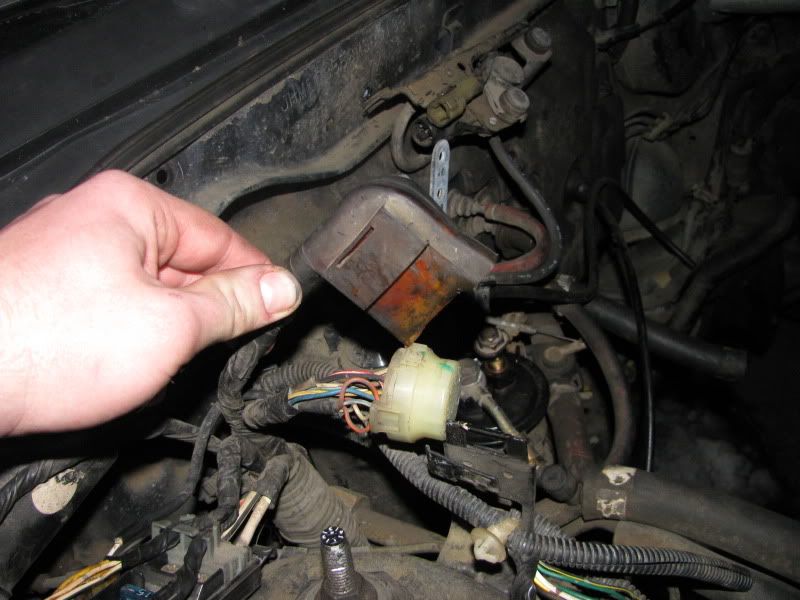

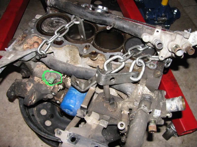

Aight, I need some help.  I'm using the B1 block and there is what looks like maybe an oil temp sensor that I don't what to do with, as well as a coolant temp sensor that doesn't match up between the two blocks.  I'm just going to use the Tstat housing and water pipe off the A1 block so I don't have to worry about that sensor, but the oil sensor (highlighted) off the back of the block I dont' know if I should try to switch it out.  It looks like it might be a 34mm plug which I don't have.  Hell I don't even know for sure if it will unscrew.  Any insight would be helpful
Now the Integra wiring harness doesn't seem to have this plug in it, but the civic does.  It's like a right angle plug and I'm having to use the engine bay harness out of the integra because the civic didn't have one at all.  Anyone know what this goes to?

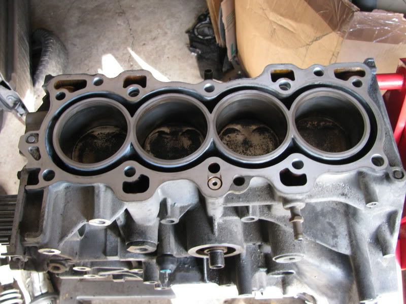

Some pictures from the build.  Block cleaned up and ready for the new HG and resurfaced head
8 thou missing
Everything going back together with assembley lube

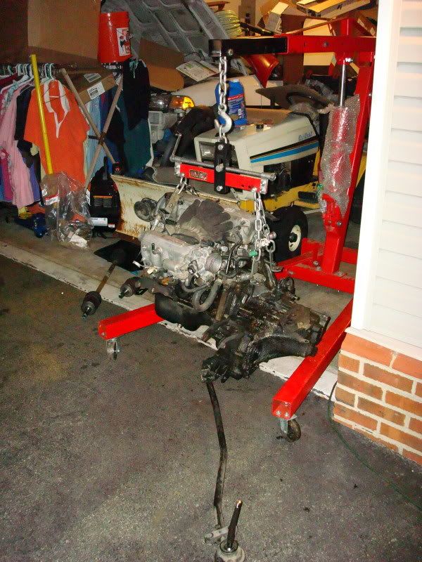

motor is in.  but damn it if theres more shit to swap out than i expected.  apparently the p/s a/c throttle cable and who knows what else needs changed.  i've given up on getting the LS engine harness to work in the civic shell.  just too much shit to rewire.  ill upload pics later
so if anyone has a obd0 mpfi harness on the cheap that isn't hacked up, lmk
