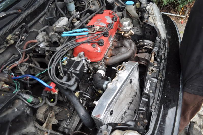

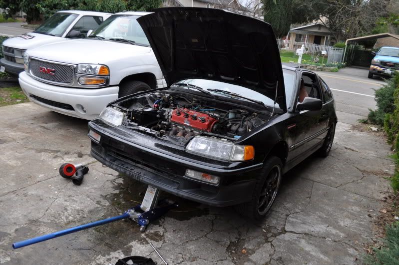

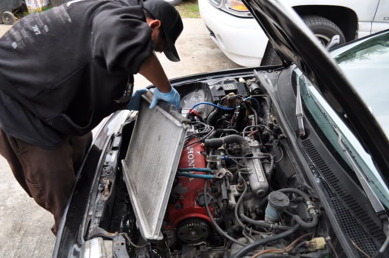

here is a few cell pics.  My buddy was with me first day of install.  I will have him upload the pics tomorrow
soon to go on...
and yes..  that is a 24oz rockstar thats in that throttle body

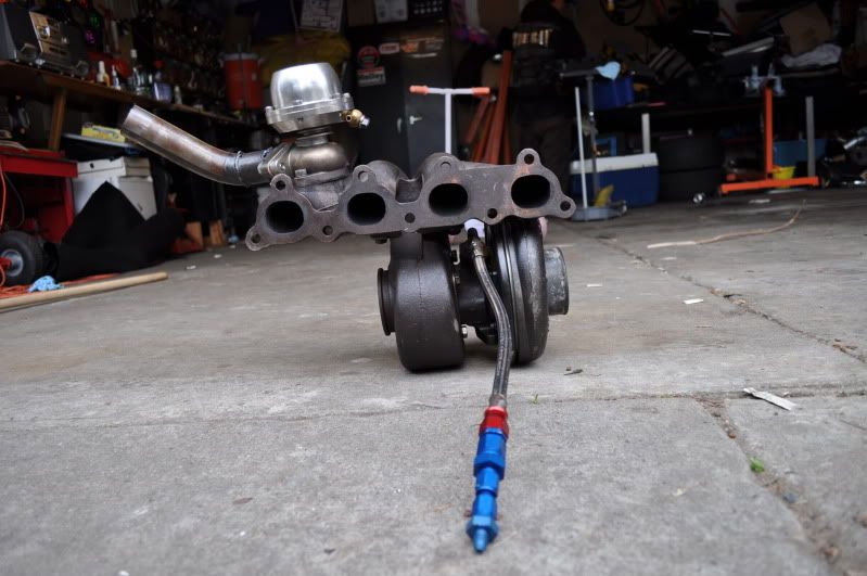

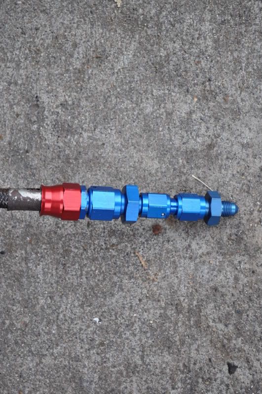

Hows that mother fucker spool? And what did you use for the oil feed fittings?
Re: FlipNogs build. 91 crx si. Pics on page 2. Big h1c, a6/y8 mad tite vtak
« Reply #39 on: February 22, 2010, 01:11:23 AM »
Jay go buy a 150 dollar digi camera mucho worth it.
i cant find the base for my casio....
the smaller holset uses i used a 12x1.5 metric adaptor to 1/8npt and used a 1/8 npt to -3 adaptor
this one had a metric 16x1.5 inlet fitting which the local speed shop obviously didnt have.  i did some real ghetto shit here but you cant see it.  lol
well i run a -3 from the back of the block,
the line that i got with the turbo looked like a -4 so i was going to run a reducer from -4 to -3.  i cut the fuckin line and its -6.
i was pretty pissed off already..
put a -6 hose end on, ran a -6 to -4 adaptor, a female to female coupler and then a -4 to -3 adaptor.  looks ghetto, good thing you cant see it.
but yeah.  spool on this is kinda shitty.  i need to engage vtak a little sooner than 5.5k.  i see about 8psi at 6500 and i see 12 at 7200.  kinda sucks.  i will lower vtak and see how it goes.  thing rips though.  hopefully i will be tuned in a week or so.  fucking 18cm2 housings.

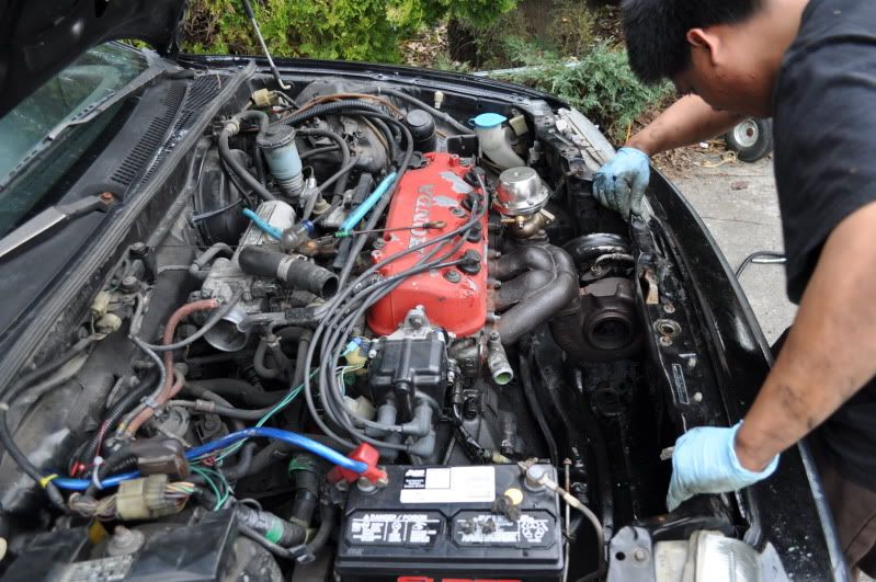

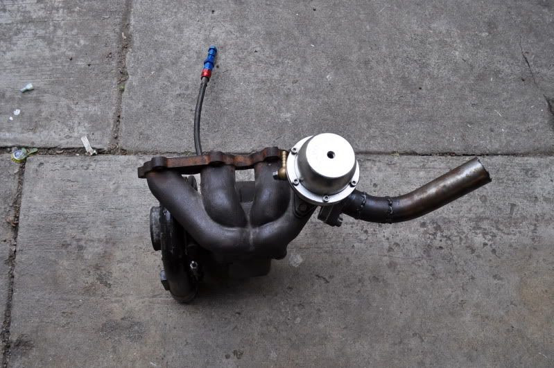

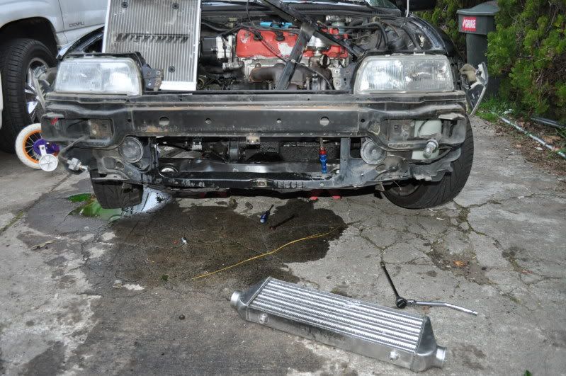

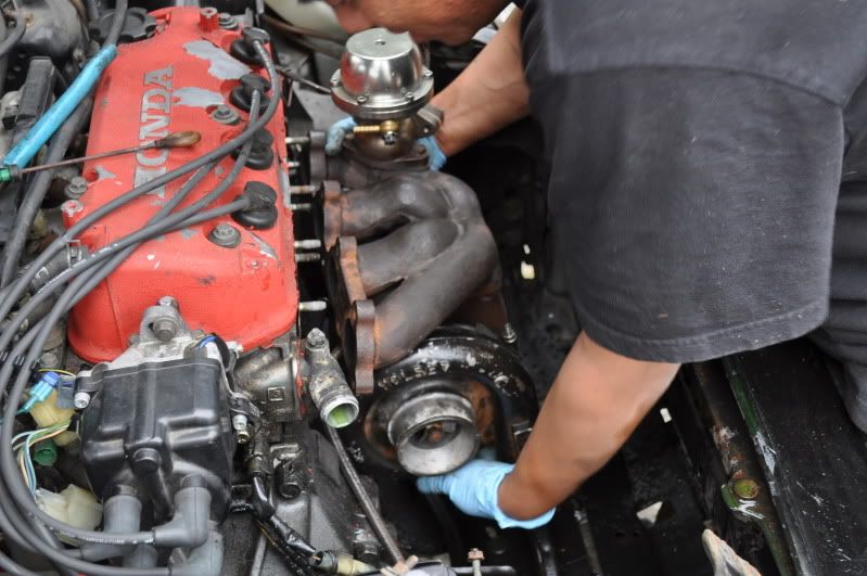

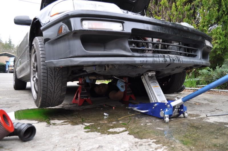

Jay vs razor blade = this
few pics during install
gangsta ride in the back
this is for aj
compressor wouldnt clear the block so i had to mount the holslut the other way
oh yeah.   im trying to trade the rims on the car for some of these.

this is for aj
lol good work nog. Dose it leak?
I think i will just drill the housing of the holslut and just use a plate with a -3 an fitting welded to it.
no leaks.  just shitty looking but you cant see where it is at
