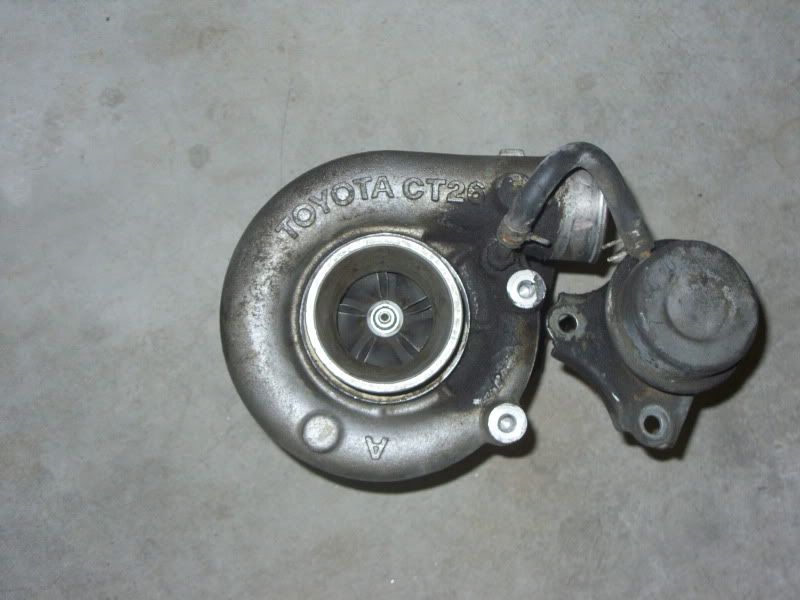

Wierd how your talking about the wrong fucking ct26. The supra ct26 is a good sized turbo capable of over 300whp. Did you even look at what one he has.
Using the inducer/exducer dimensions, the stock CT26 is sized between a T3 60-trim and a T3 “super” 60-trim, which flow between 34 and 36 lbs/min, respectively. Given that, the stock CT26 wheel should flow about 35 lbs/min.
Stock – ~35 lbs/min (1.811” inducer, 2.559” exducer – 2.185” average

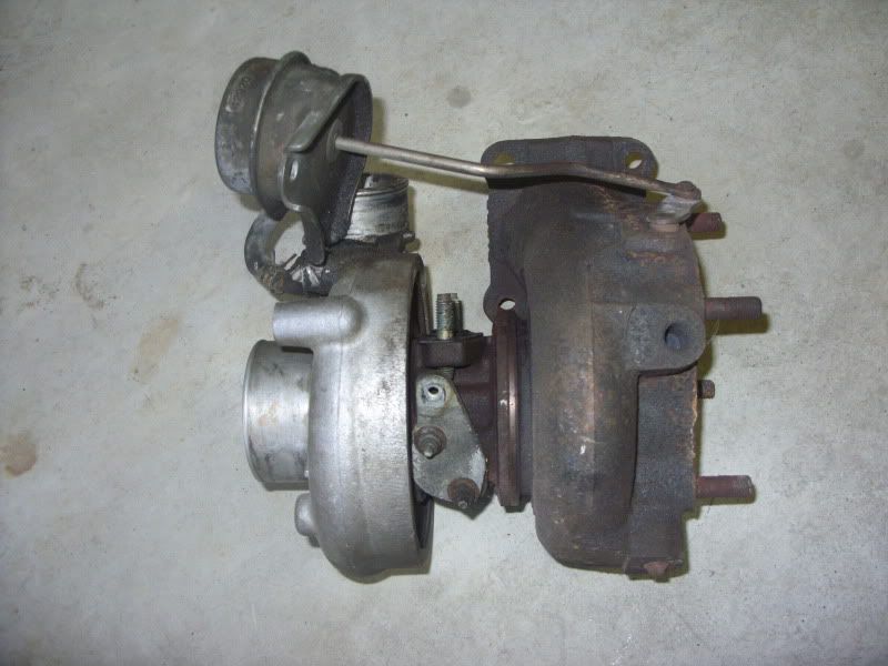

His turbo:
So i have to ask how the FUCK does the mr2 "smaller" ct26 even come into play here? You guys are trying to be mr. badass yet are talking about the wrong fucking turbo.
From the looks of this the turbine wheel looks to be larger then the stg 1 garrett turbine wheel in the 42/48 and 60/63 wierd you guys don't hate on them for being POS.
T3 Turbine - - 1.898" 2.319"
Supra ct26  - - 1.97" 2.36"
