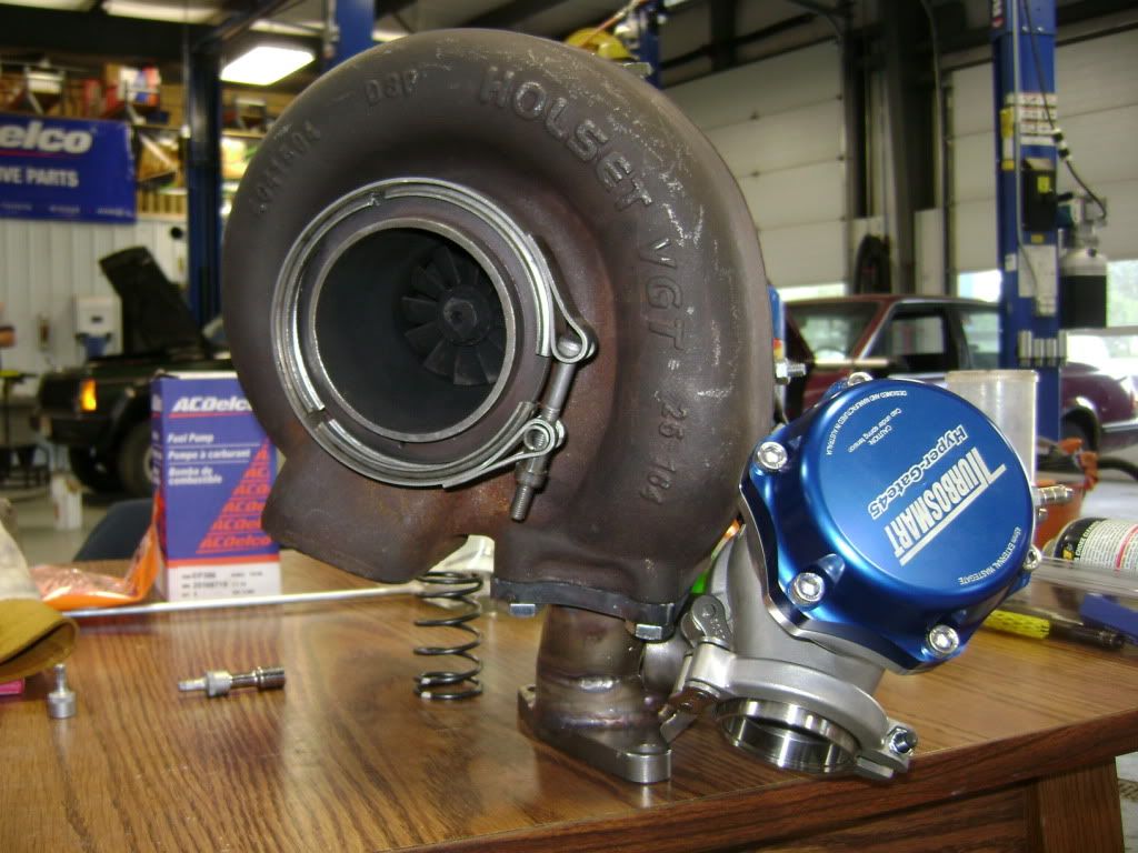

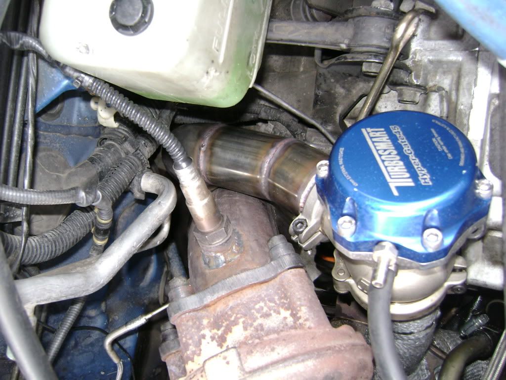

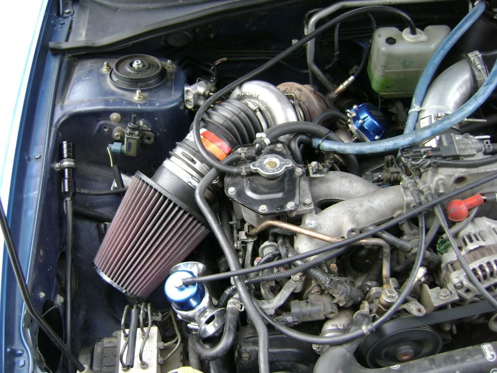

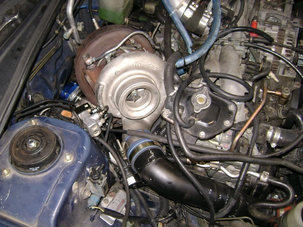

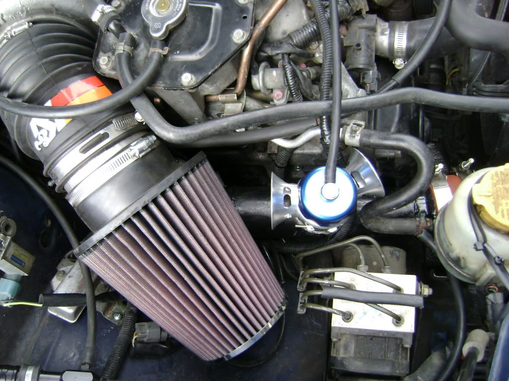

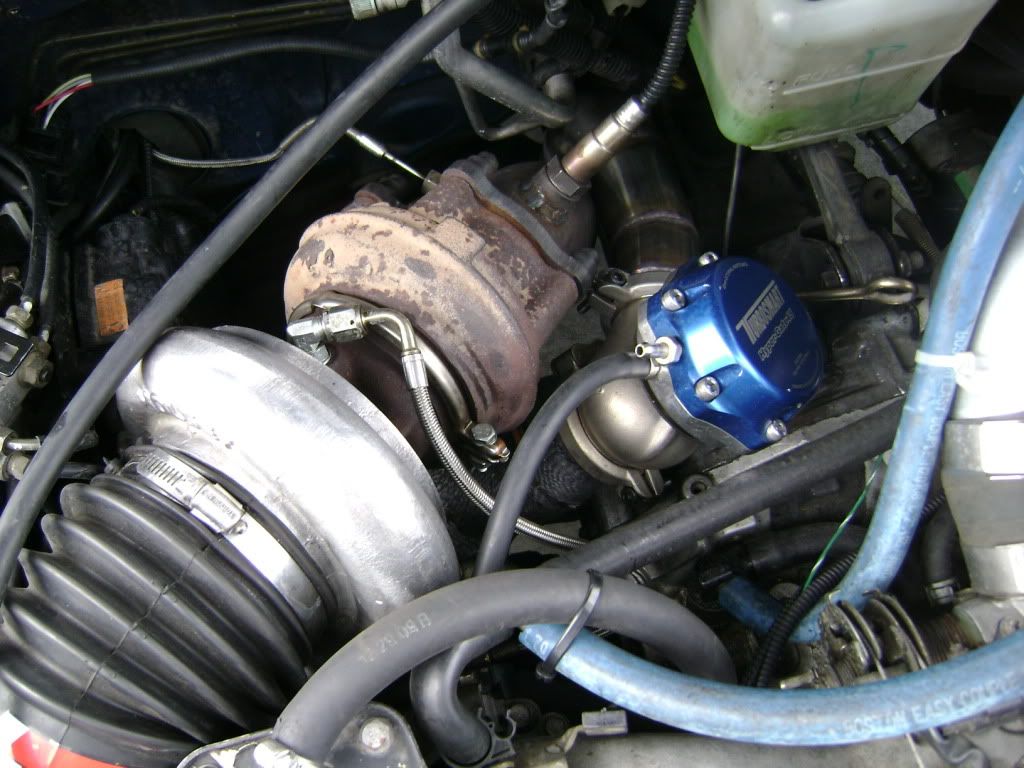

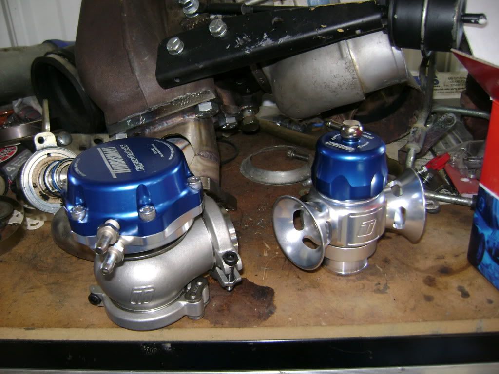

I decided on some higher quality parts. CDM WG was creeping boost like a motherfucker in 3rd,4th, 5th gears. Im sure it didnt help that I had to make the fire ring since I either used ot lost the one it came with. Turbosmart shiz:
As it sits now. Boost is rock solid at 15.5 psi (7+10 psi springs, boost source from comp outlet) even at the top of 4th gear. Im waiting till I can afford some larger injectors. I made the hop to E85 and my 750s are maxed at the current boost.

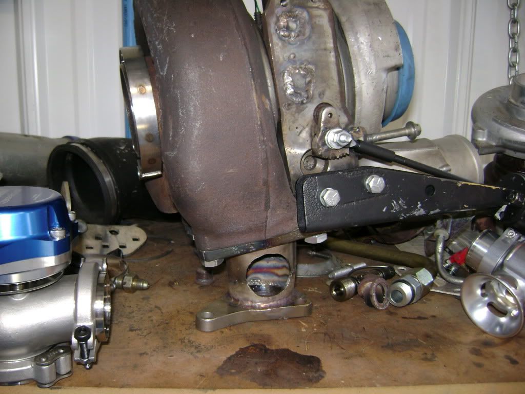

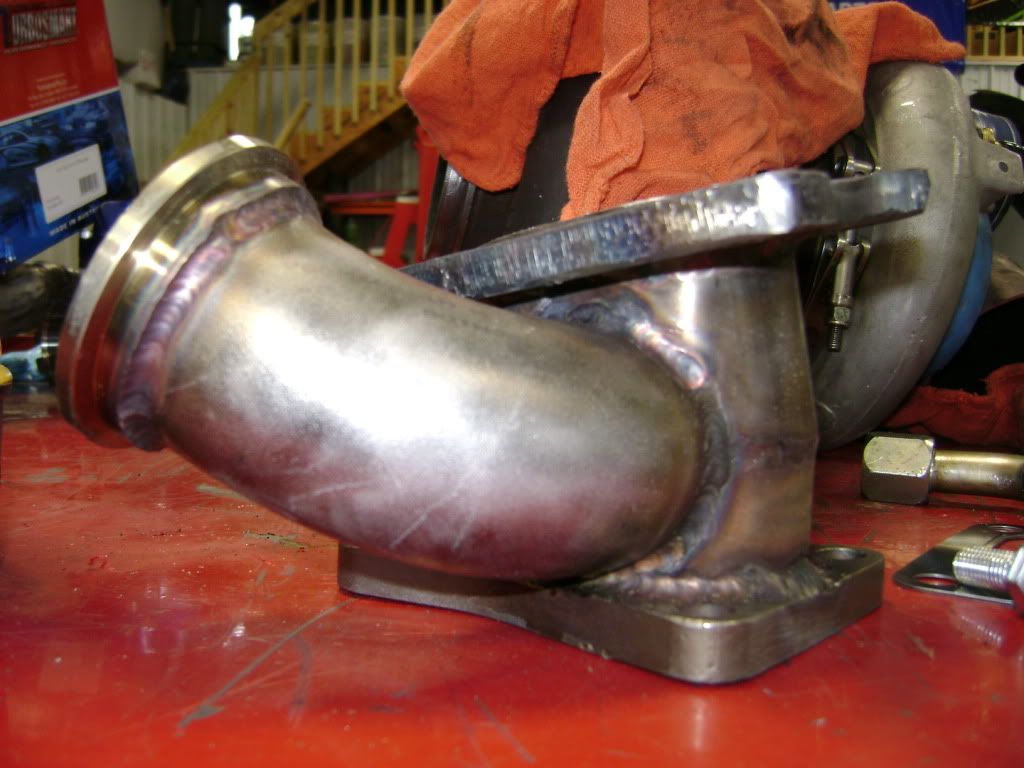

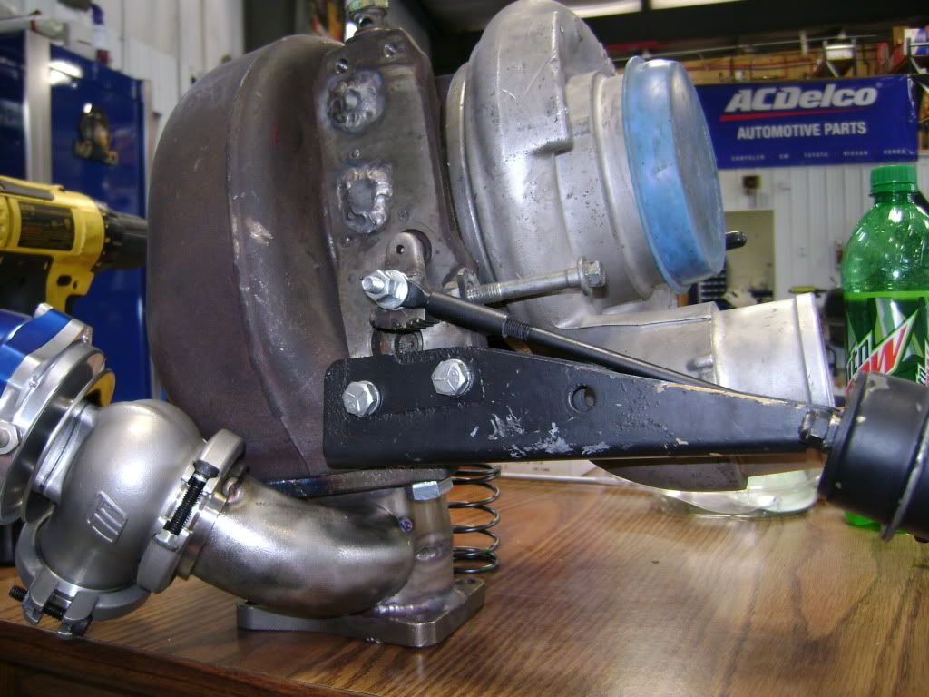

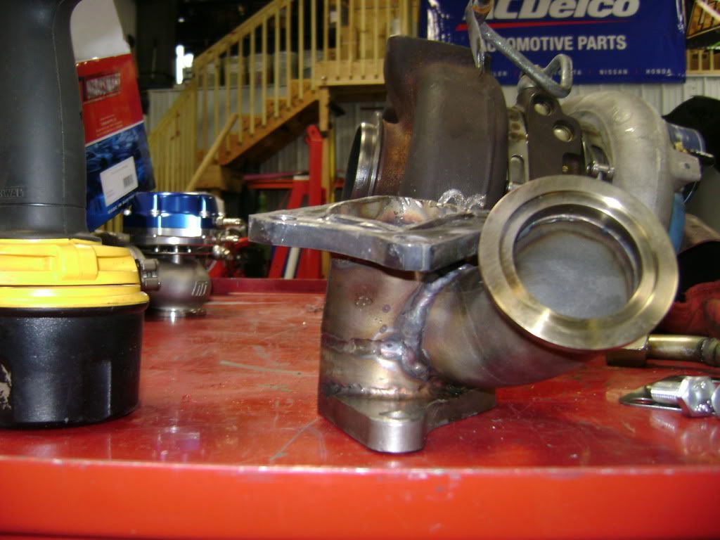

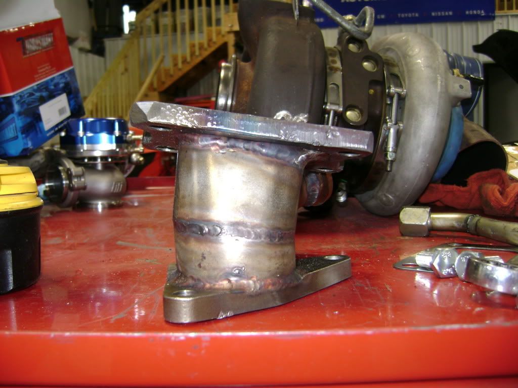

I made a hell of an effort to make the HE351VE work. Built this sweet ass adapter, installed it and I just wasnt feeling it. From the start I had a leak between the adapter and the header up-pipe which was exaggerated by the closed down hotside housing. Boost built very slow, probably due to the exhaust leak and the lack of tuning. At the end of the day I had to go back with the HY. I will try again. The other issue is that I have been working on this during work hours and we have a lot of work piled up that needs to get done to meet some goals that we have. More as it comes I guess. enjoy

I'm digging the adapter!

Is the flange just warped like Johnny's mind after the man's microwave bombardment?
Also, Aero said that full-closed was too restrictive. IIRC the trucks use it as a sort of exhaust brake. Another thing is the stock hoeslut actuator is set for much more than 15psi. You'd be better off with the WRX's stock actuator.
