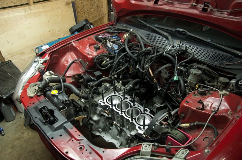

it rusts like that when you only use water for coolant
it sat for 2 days before i took the head off... well, actually only for 1 and a half.  lol.
already working on a new build but i dont think it will be done till next year.  but thats a-ok with me.

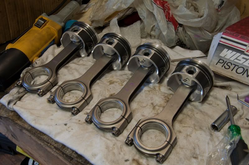

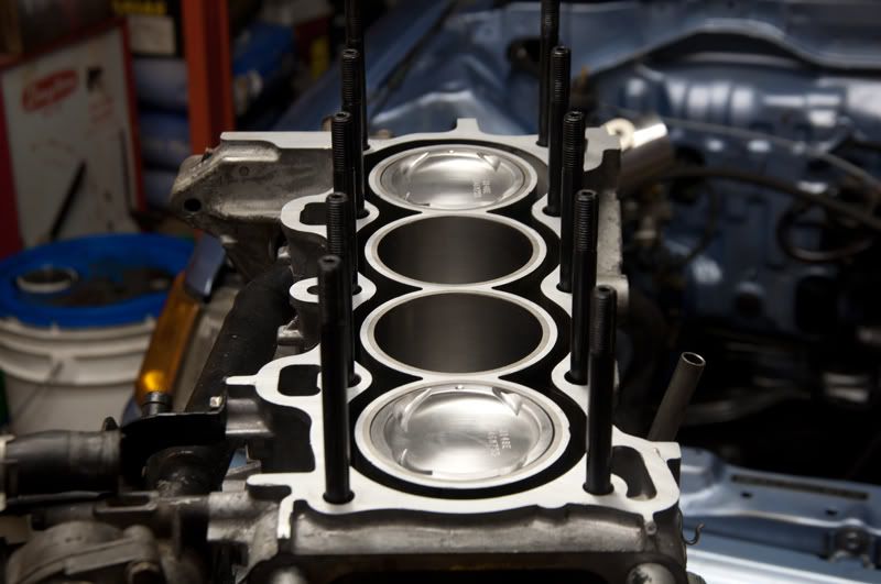

« Reply #63 on: September 05, 2010, 03:47:34 PM »
new block is machined for 75.5mm 8.5:1 wiseco's
assembly today
tuning this week
racing this friday
h2a

started her up last night.
she idled ok, but needs a little work to the map before she will idle with 8.5:1 CR apposed to 9.7:1CR
i should be racing her tomorrow if the weather holds out!
assembly today
tuning this week
racing this friday
Looks just like my shortblock did. :) Cept I'm too lazy to make it make power.
