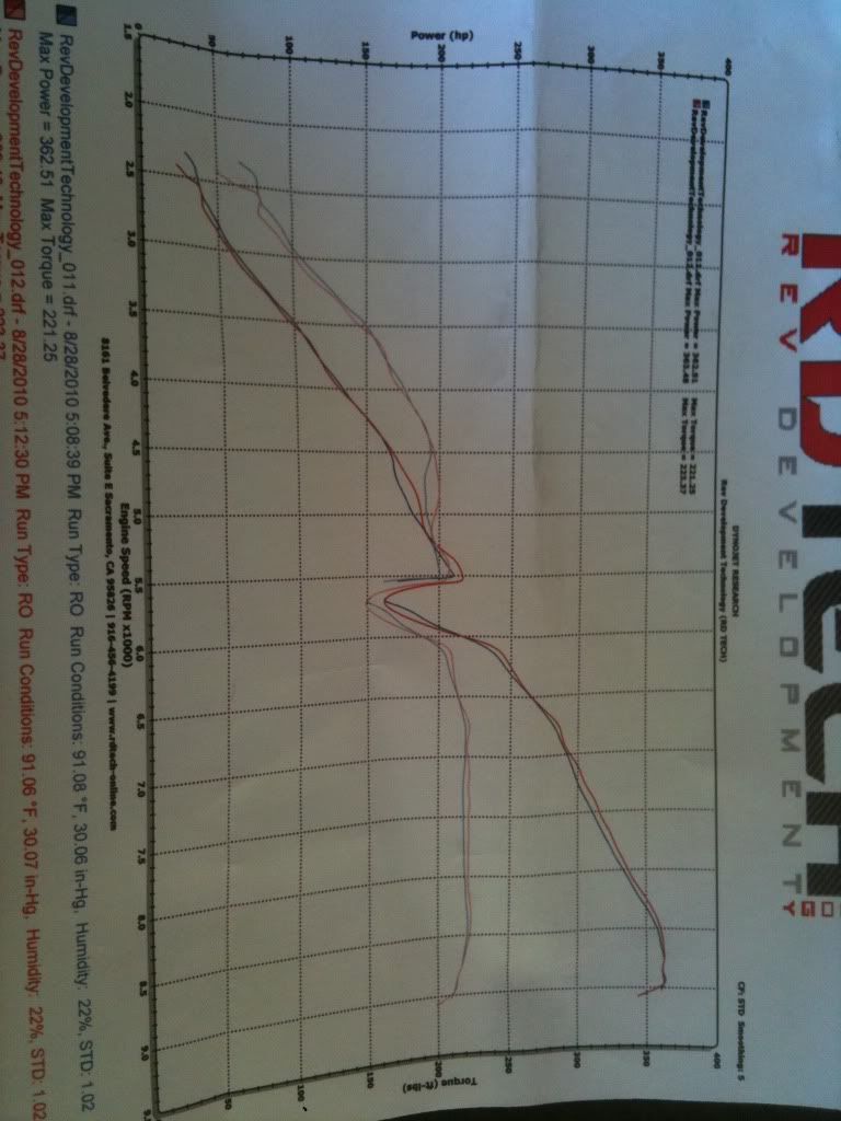

David has the whole session in pdf I believe. Also has a printout. Weird dip going into vtec but that fucker screamed. I think a .63 or bigger housing would of yielded bigger numbers.

We set vtak at 5500. The turbo was at 14.5psi way before that. Motor made power all the way to 8800.

« Reply #48 on: August 30, 2010, 08:16:47 PM »
Any dyno giraffes?? I want to see how that .48 spooled with 353whp.

« Reply #51 on: August 30, 2010, 10:36:08 PM »
I can't figure out how to get the other ones so I just took a pic of the printout

« Reply #52 on: August 31, 2010, 09:38:18 AM »
How is it on the street, really responsive? I'd just thought the dyno would show power come on earlier. I'd also thought it would drop like a rock after 6k but it doesn't.

« Reply #53 on: August 31, 2010, 11:39:33 AM »
I thought it would come on a lot sooner, more like my old rhb5 d16a6, man that mother fucker was like squeezing the bottle every time I stood on the gas! Nothing like power on tap with no spool up time.
