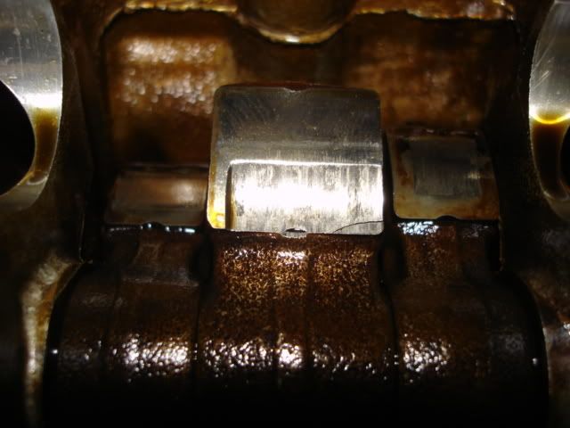

pics of fucked up cam/rockers tomorrow?......  :'(

None. But Its not a terribly unique situation and pics arent hard to come by. Exhaust rocklers (esp VTAK) were HAMMERED with Troughs worn into them BAD on the VTEC lobed... Cams themseloves were fucked too, but the rockers were the most visibly impacted component.
Intakes were a lil messed uup, but nowhere NEAR like the EX.

sorry, i meant ill have some pics. my VTEC lobe on exhaust #1 is chewed...  :-\
Re: oil change intervals?
« Reply #39 on: October 11, 2010, 01:44:41 PM »
That nasty brown example is not in my motor by the way... LOL.  :mexi:
