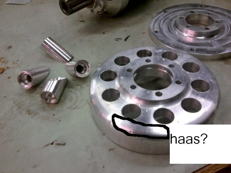

Got a few parts machined last night.  Some injector bungs and part of a sprocket adapter.

no, grinding wheel and a stick of HSS.  ;DDD
Re: Building of an FSAE car
« Reply #36 on: January 28, 2012, 01:42:13 PM »
no, grinding w
That actually makes a lot more sense, I was wondering why the axial surface was turned but the large rad looked poorly milled, you ground the whole rad on the tool and tried to just plunge cut it, tsk tsk.

Yea it chattered a little bit when it had a lot of contact but it works!  how else do you do that on a manual machine?  We don't have a lot of tooling, just the basics.
You haven't made yourself a rad turner yet? Look it up, you'll love it. Much better way of doing rads.
