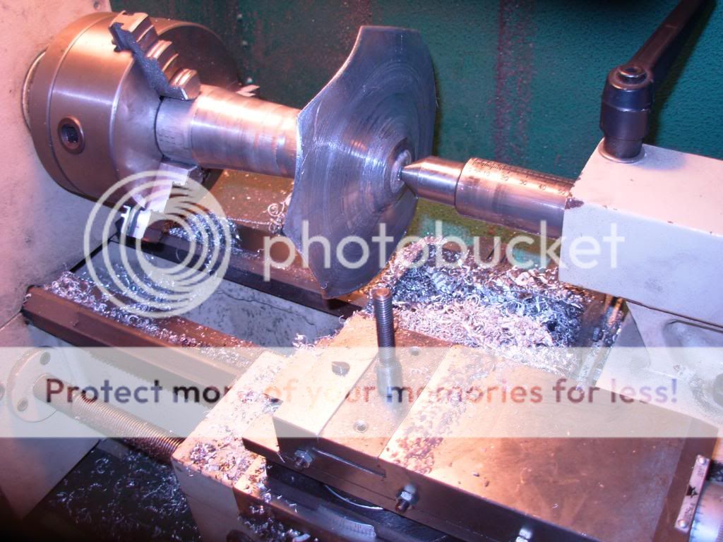

Its not a big deal if you have a lathe. The tooling is generally made on the same lathe as the spinning is done on.

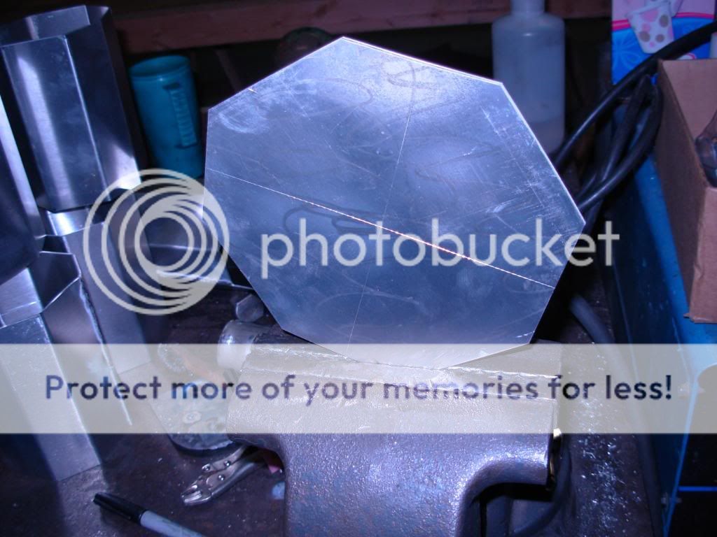

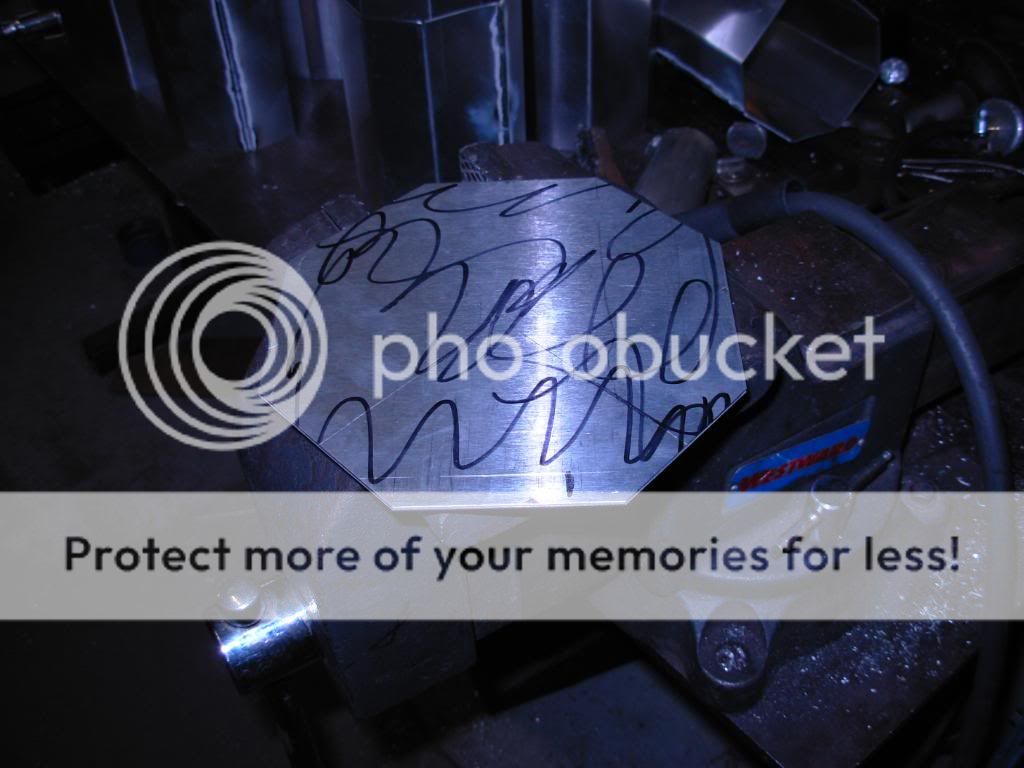

Here is what I ended up with. This is 16ga and I believe its 6061 that was annealed with a propane torch. The problem I ran into was the material work hardened very quickly and the tooling wasnt exactly ideal either.
After sharpie burned off.

Aluminum doesn't work harden, you should be able to form that piece a lot more, the issues is that you still have a lot of temper, that part must still be close or at T6. Anneal it in an oven or better yet get a piece of 5052 and anneal that to T0, you will be amazed how much easier it is for you to spin. (will machine like a gummy mess in T0 just so you know)

I did anneal it,but it could probably use a little more heat. If you look at the pics I sharpied all over the part and then burned it off with the propane torch. I think it just needs more heat and a longer cool time.
