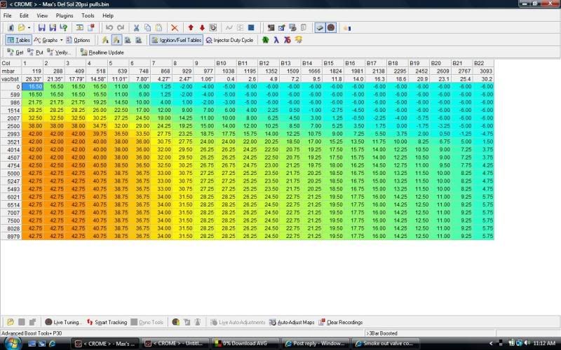

On my vitara build this is my timing map. I dont have much experience tuning anything over 10psi, this is what I have been runing and it pulls hard, no hint of detonation, but i'm throwing a ton of heat into my exhaust. My manifold, and even downpipe has cracked in the past. Should I be running more timing? I thought this was kind of agressive. BTW I keep the boost around 21-22psi, but want to turn it up higher as soon as I figure out why the boost is fluttering so bad.

only way to tell if you need more timing is to look at the plugs how are they up top?

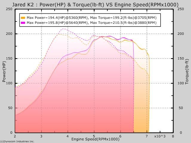

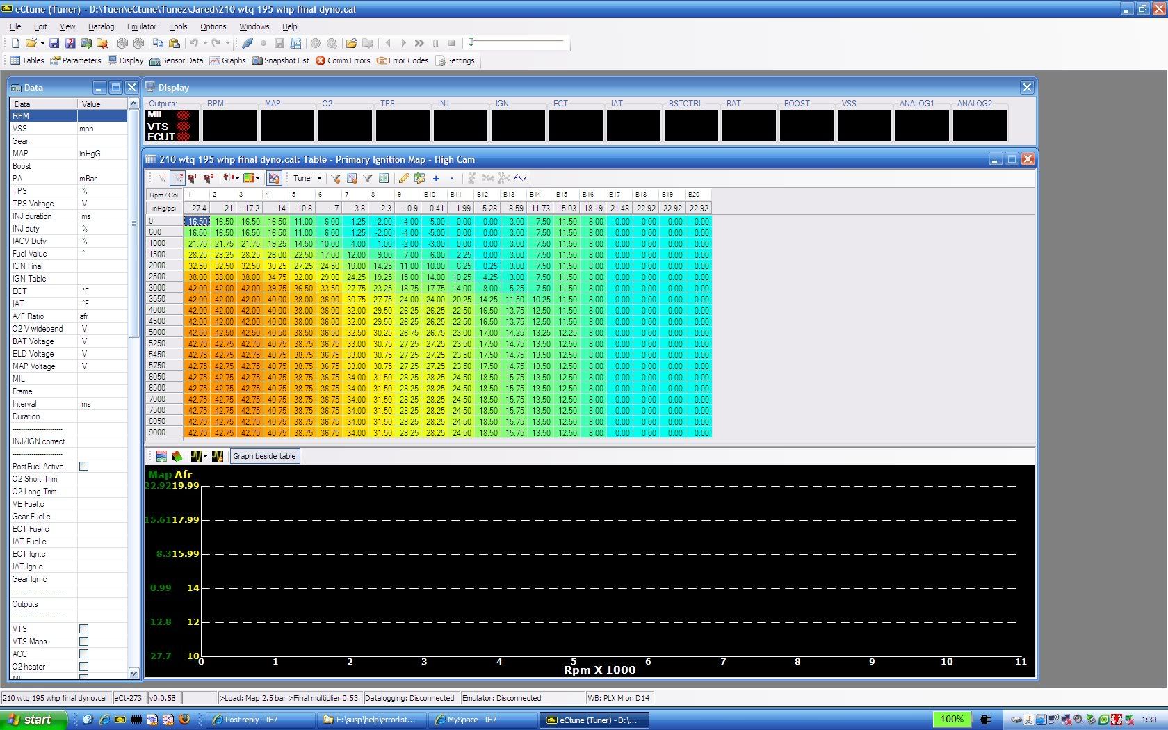

I've got a Vitara dyno tune on an Eclipse T25 on my laptop, eCtune, I'll try to remember and post it.  Those 7.5:1 motors like more timing, and even when they don't they aren't necessarily detonating.

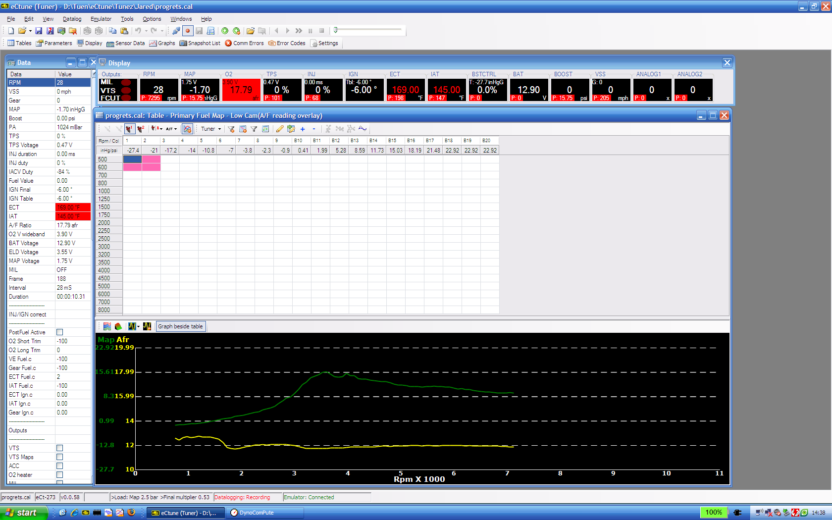

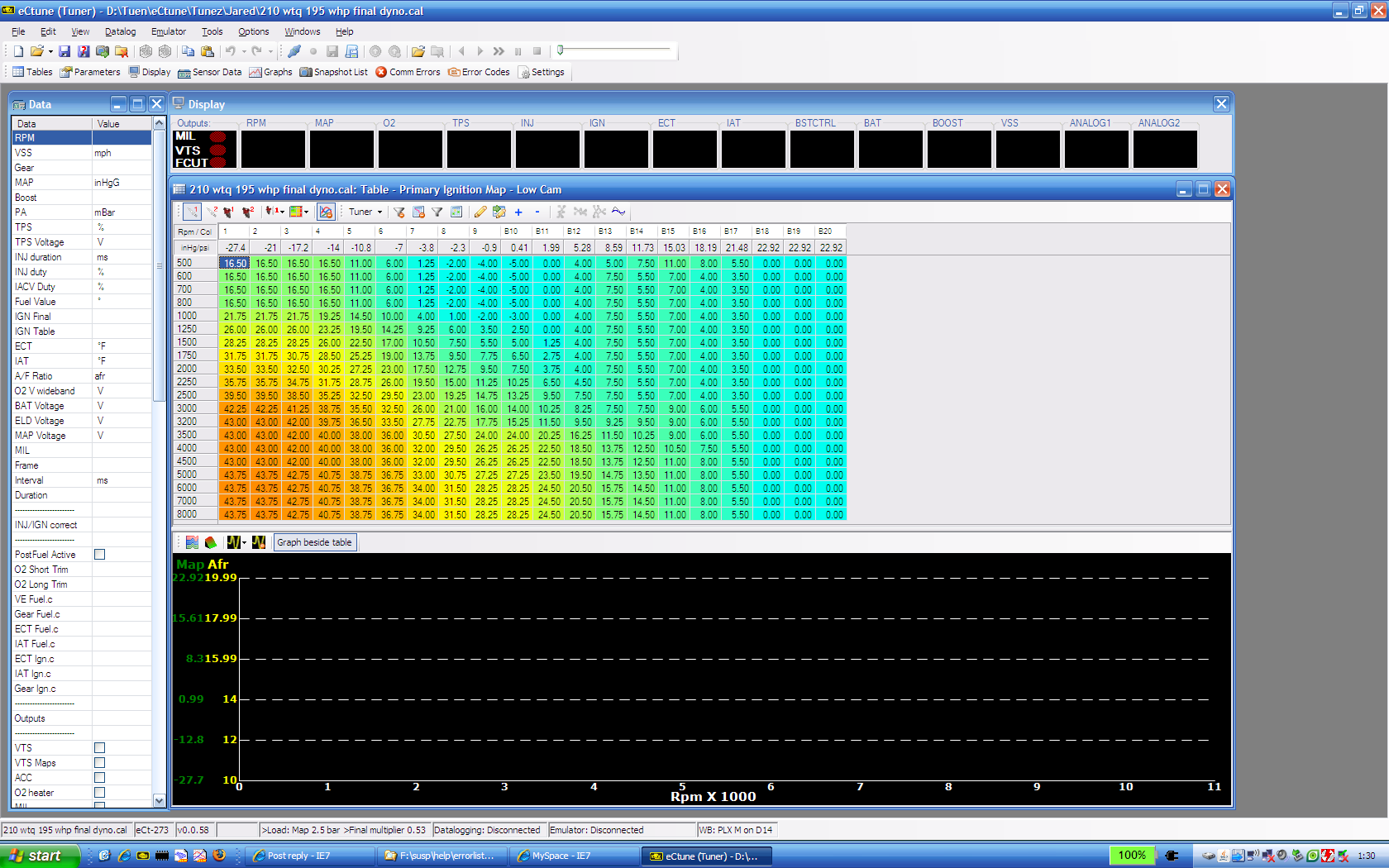

« Reply #35 on: May 01, 2009, 07:10:39 PM »
Lowcam:
Highcam:
Wastegate:
High power of the day:
Of interest:

« Reply #36 on: May 02, 2009, 12:24:32 PM »
Nice thanks. Just wondering, why do you put 0's in the parts of the timing map that you dont use?
Lol...Fags
Re: Cold Start Flooding on vitara build. Can't figure it out.
« Reply #37 on: May 02, 2009, 01:40:49 PM »
I zero the lowest rpm boost columns in order to keep track of how much timing I add back in, after recurve) on the dyno.   I apply a pretty generous initial retard per psi, so when (from left to right) the numbers start decrementing it usually means I'm running out of octane.
