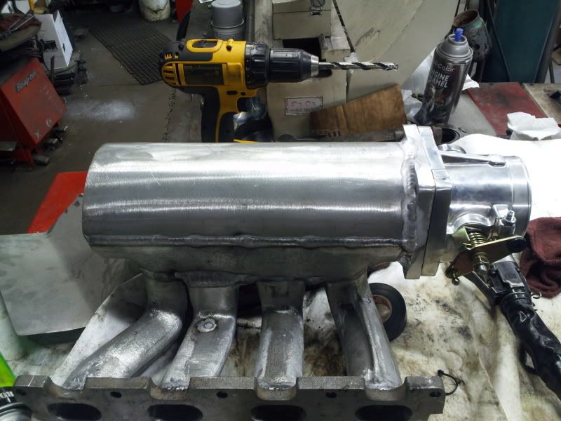

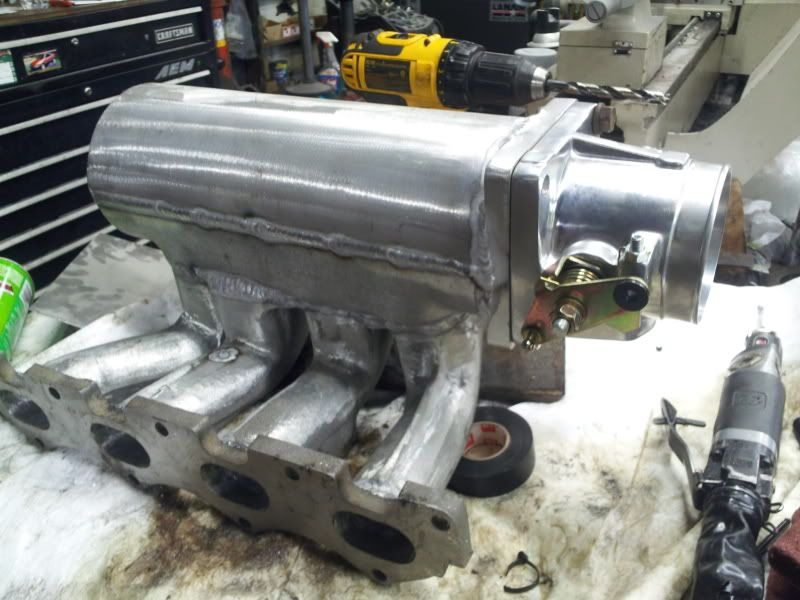

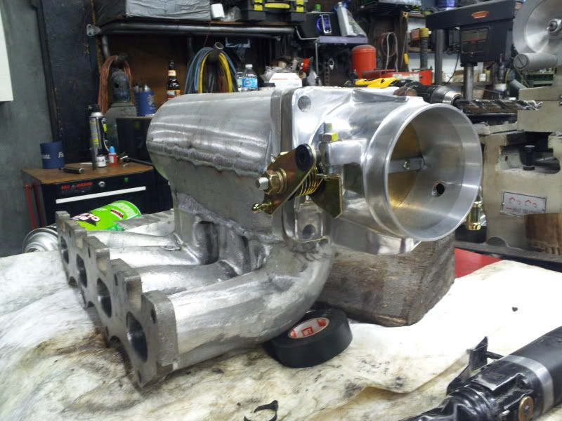

manifold is pretty neat i like... what kinda machine are you welding with?

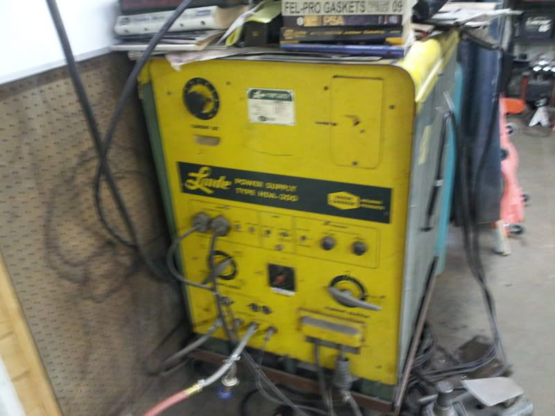

1972 350 amp Union Carbide. AC/DC with high frequency start, factory water cooling and post flow. Put a modern water cooled torch setup on it and it welds like a boss. Probably the best machine I've ever welded with.
I'll snap a couple pics of it next time i'm at the shop.

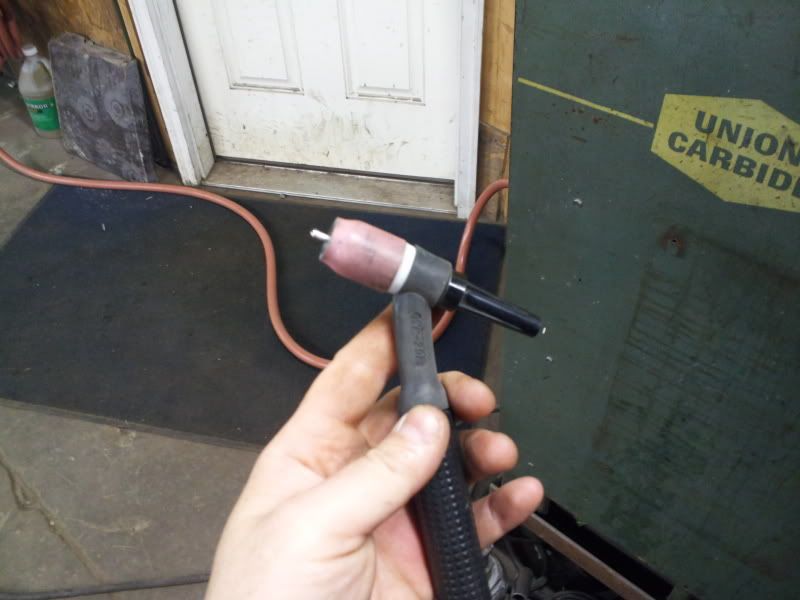

Pretty much done. Handed it off to my brother so he can polish it.
Welding Rig
Water cooled torches are badass. Ill never use an air cooled torch again.

Look at that big ol dinosaur bastard machine.  Hell yeah!

Fuck ya. I love these old welders. Think I have $600 in this entire setup.

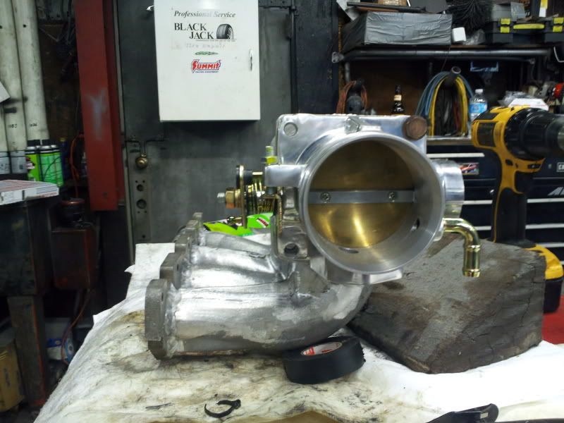

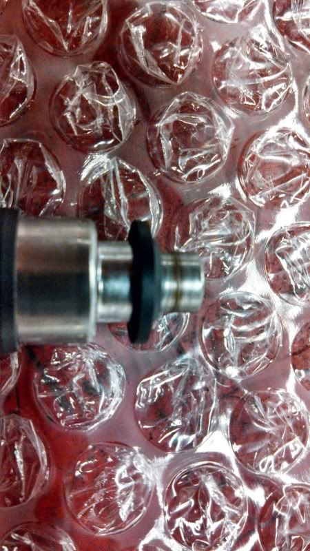

Anyone know if I can remove this black plastic piece from my injectors?
I imagine you can just clip it off with a sharp set of dykes
I dig your tungsten looks like it gets a work out lol
Normal side-cutter.
Find the 2 seams, clip 2/3 of the way into the ring on both seams (clip all the way if you don't mind leaving marks), then you should be able to pull it off. You may need to sort of fork it with the side-cutter to pry it off, or make a few more cuts. That entire area is sturdy stainless steel, so any marks will be cosmetic.

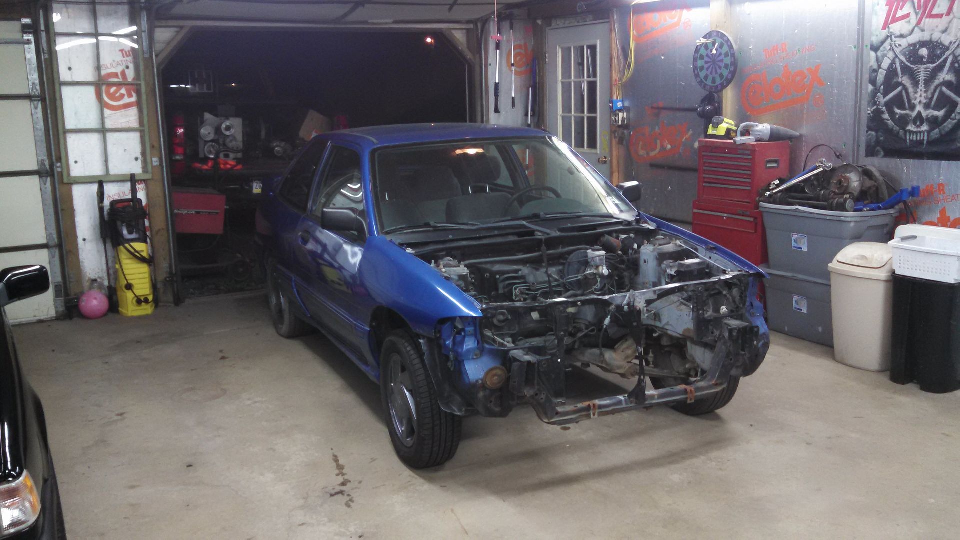

Ok, so I'm not dead and I'm gonna be finally starting on this thing again. Its almost like a vendetta at this point.
Its crazy that its been almost two years since I've worked on it. Alot of shit has has happened since then. Got married, had a baby, now I got another on the way. Its rough being a responsible adult.
Finally got it into the garage.

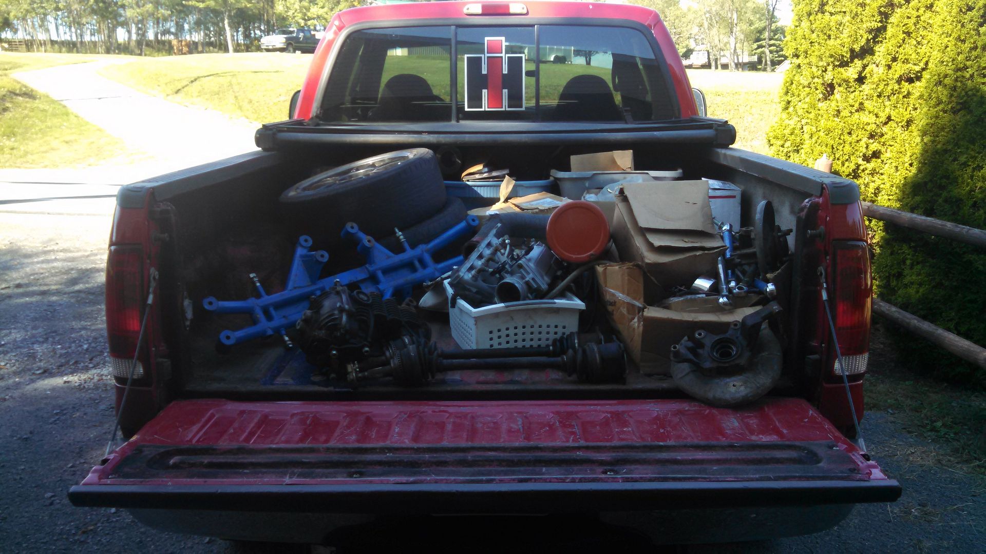

Truck o parts. 1 of 3 loads I brought to my house, lol.

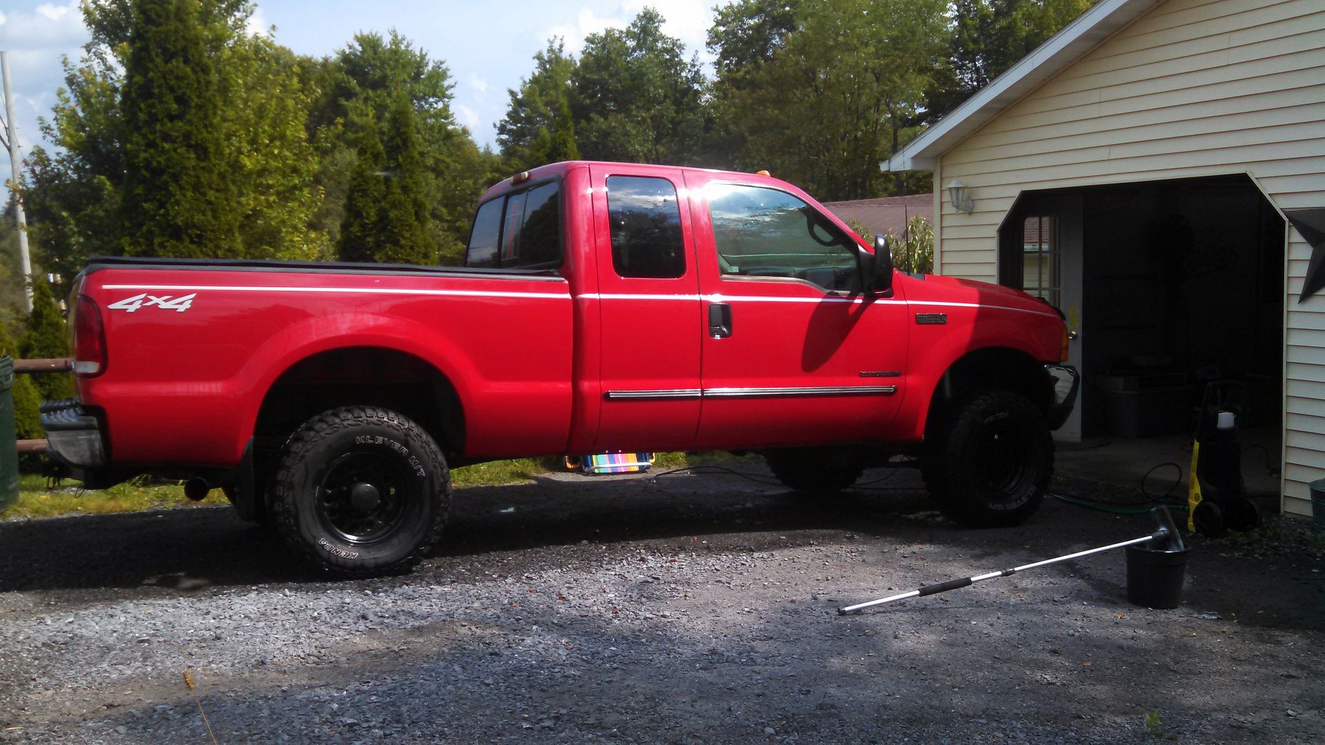

The hauler. 2000 7.3. Has swamps 200cc single shot injectors. 5" exhaust. Intake. 6 position TS tuner with custom tune. Swamps fuel system. Swamps IDM. Runs pretty good.
Still playing around with this thing too. Would like to build an engine and make some power with it when the escort is done. Its a pretty fun ride.

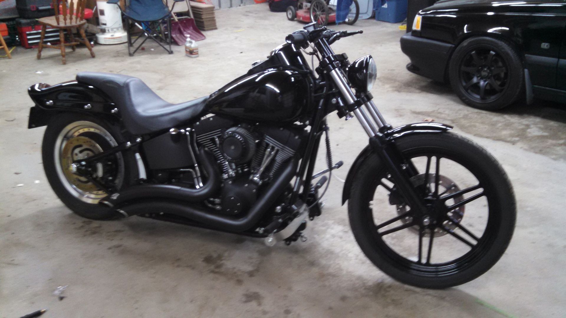

Scooter. Bought this thing for super cheap. Dude had it all gayed out with ebay skulls n shit. Tore it completely down and this how it ended up.
Why I never really get to work on cars anymore.....

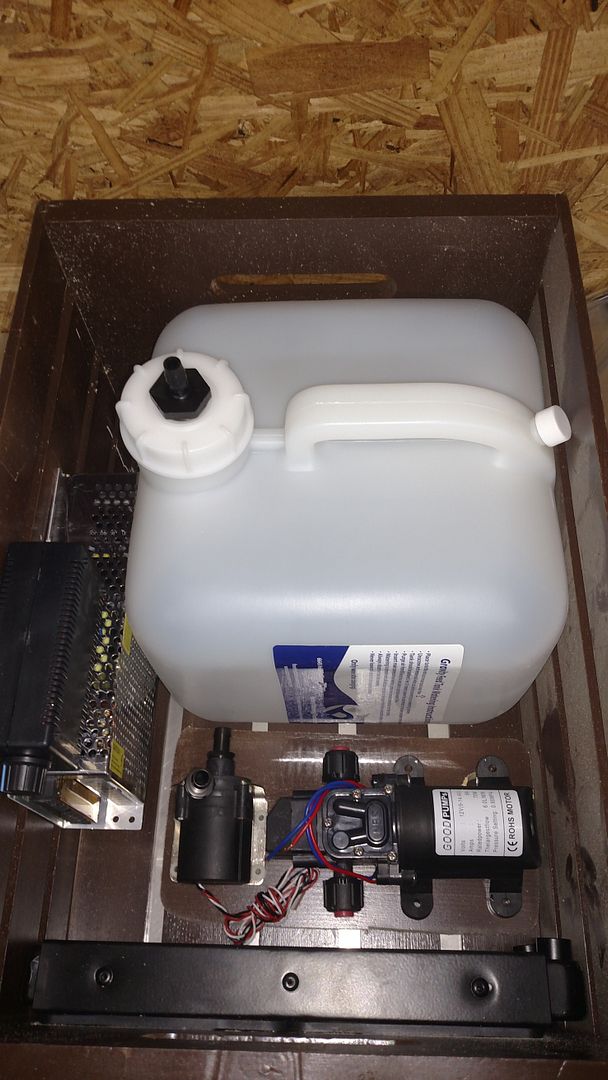

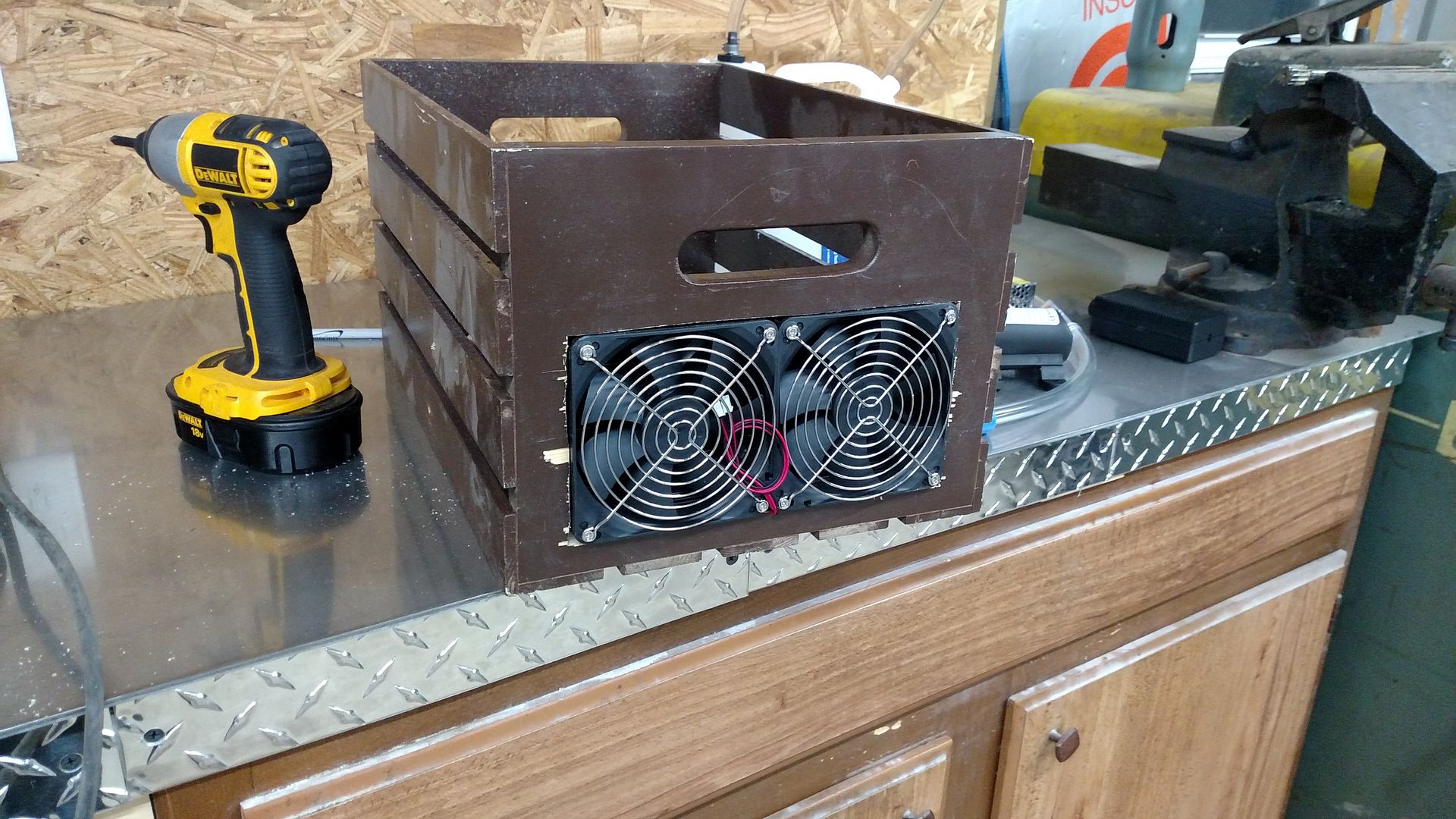

Started building my ghetto $100.00 tig cooler.
Big pump circulates through the torch, little pump circulates water through the heat exchanger. Should work.....

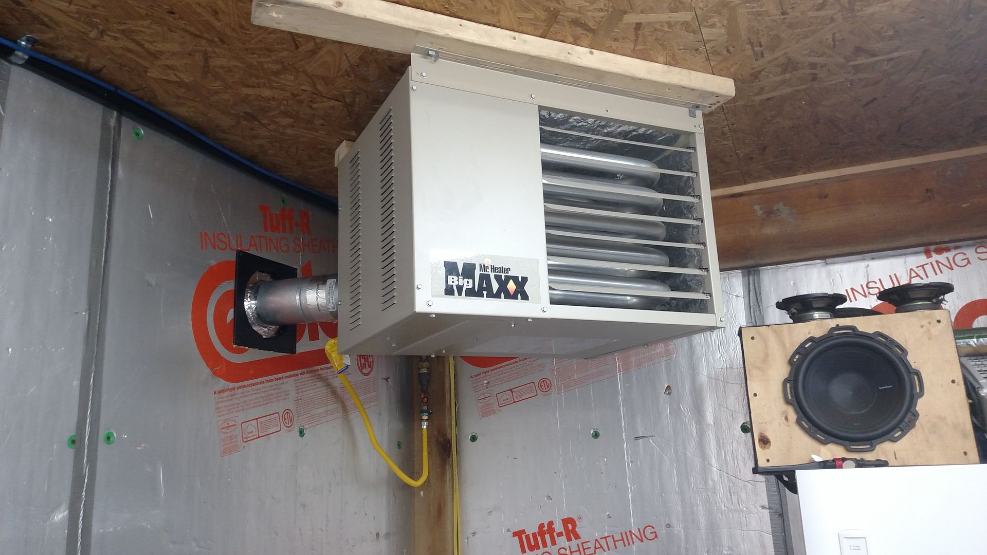

Also got my heater installed....

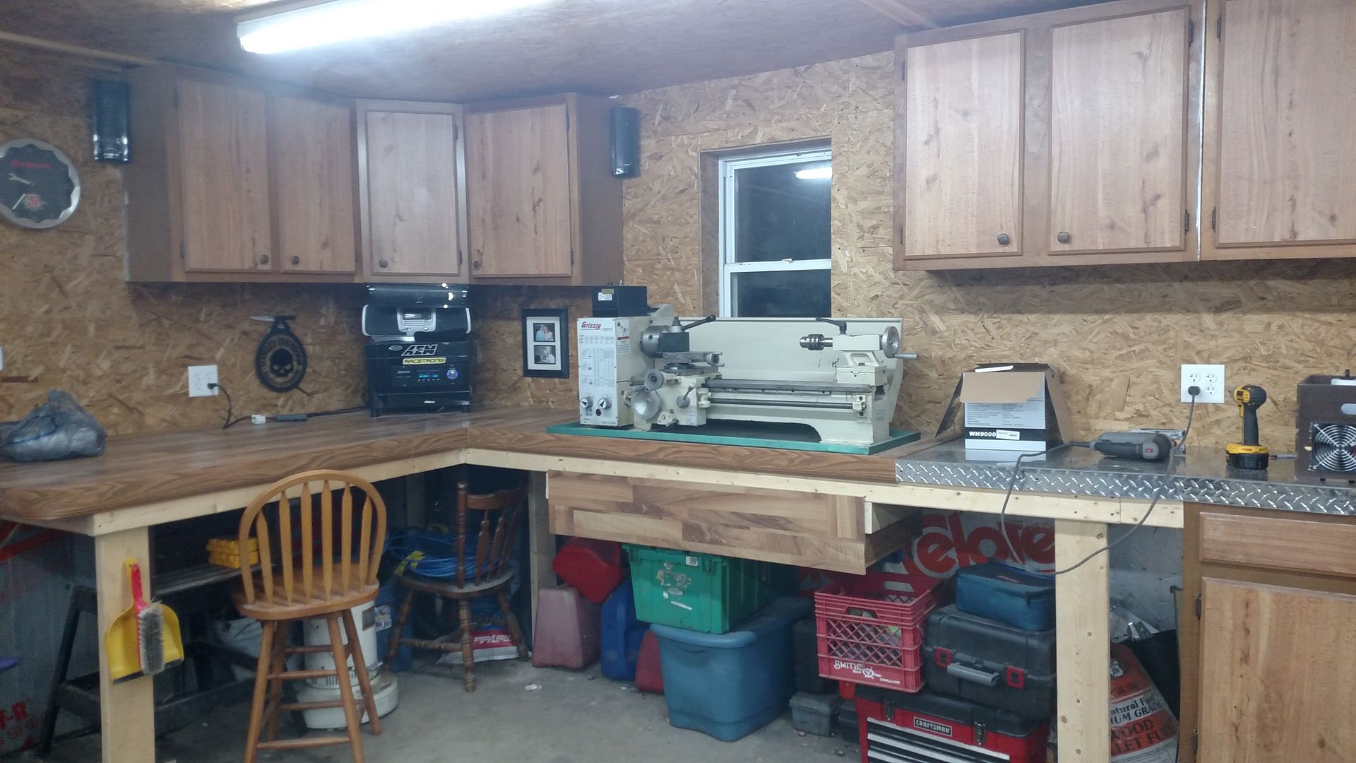

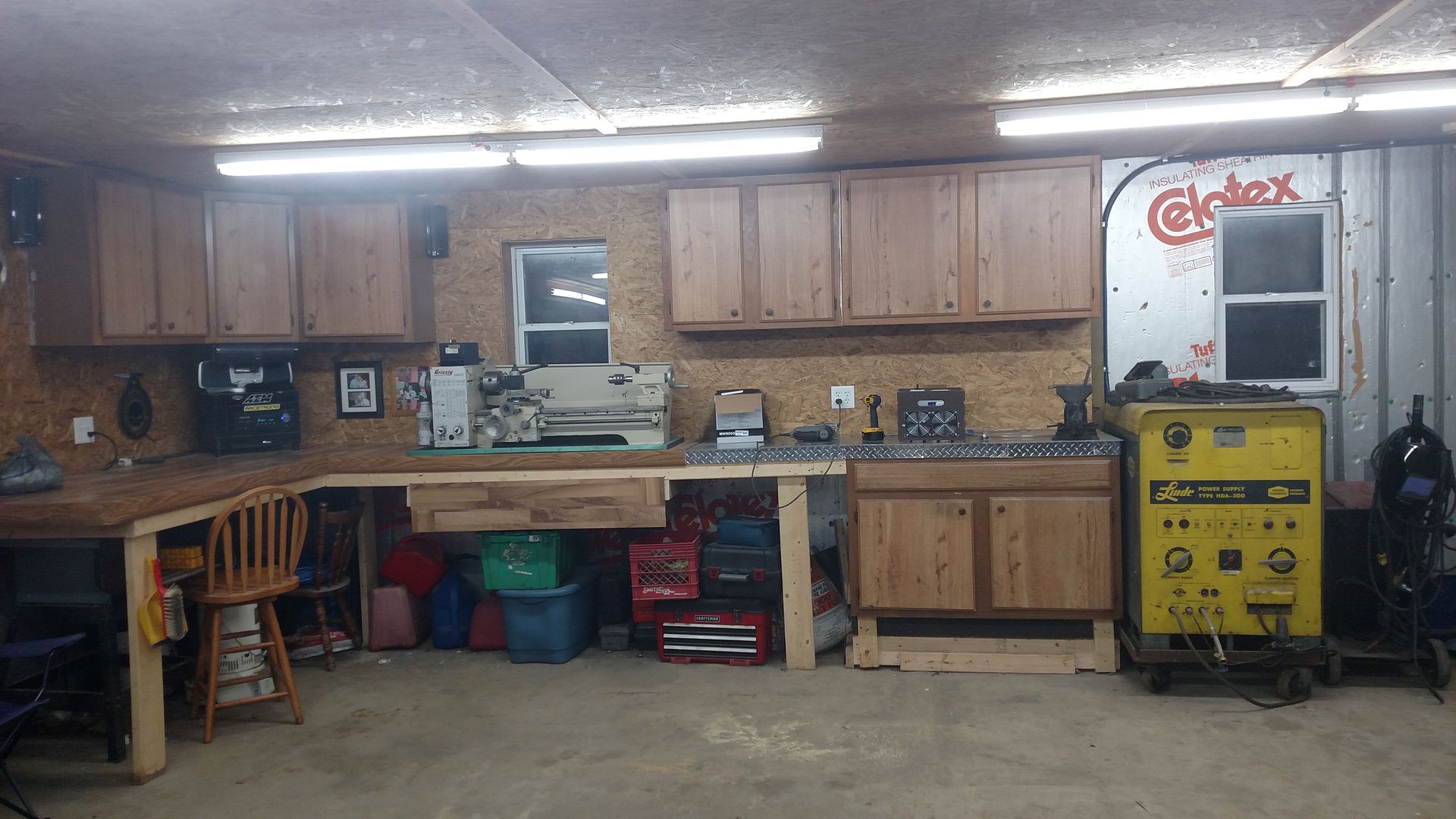

....and got the work bench done and lathe setup.
Hoping to actually get cranking on the car this coming weekend  :noel:
