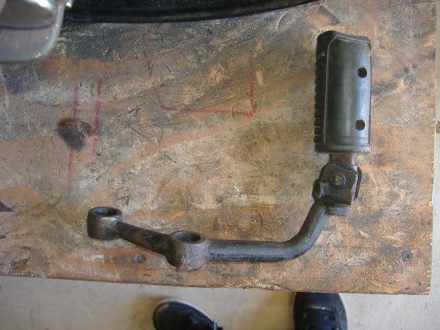

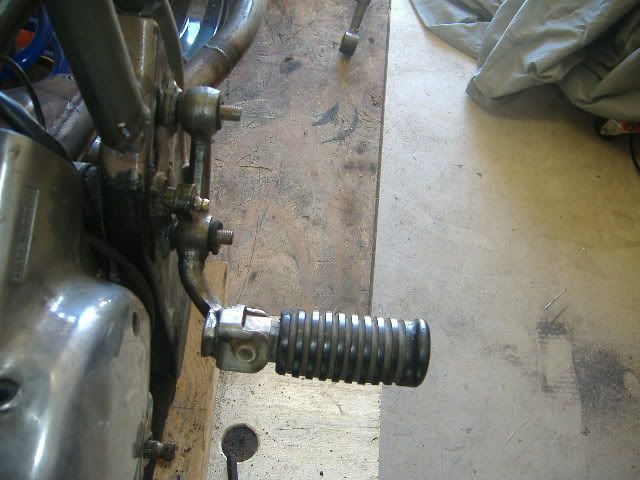

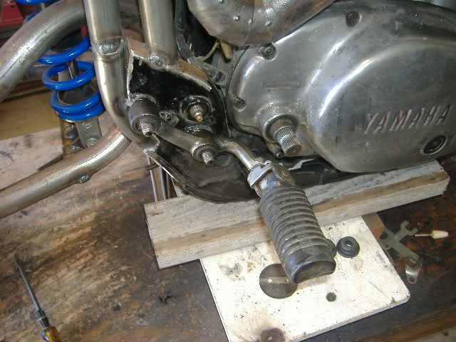

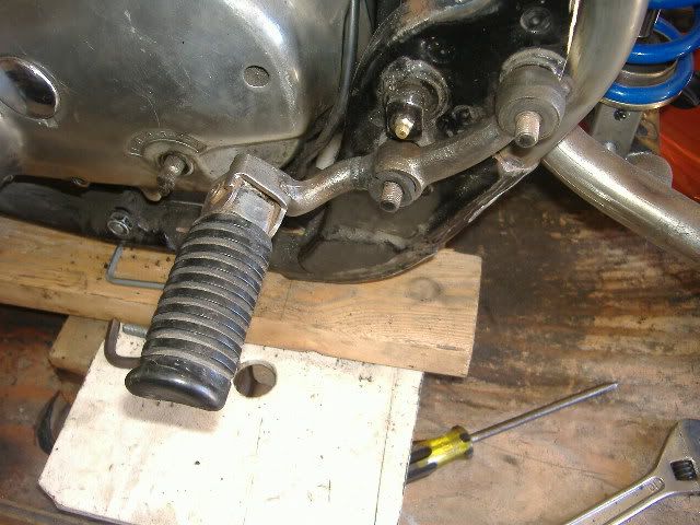

I've been having a really tough time figuring out how to mount my rearsets. So I decided to take advantage of the factory mounting points that I had left in place (I'm glad i did that) I got a set of factory pegs:
These were a touch too long, so I took about four inches out of them :)
This puts the pegs in a perfect spot. I'm going to cut those pegs off and use them on my chopper redesign this winter. These mounting brackets will become the base for my ZX6R pegs.

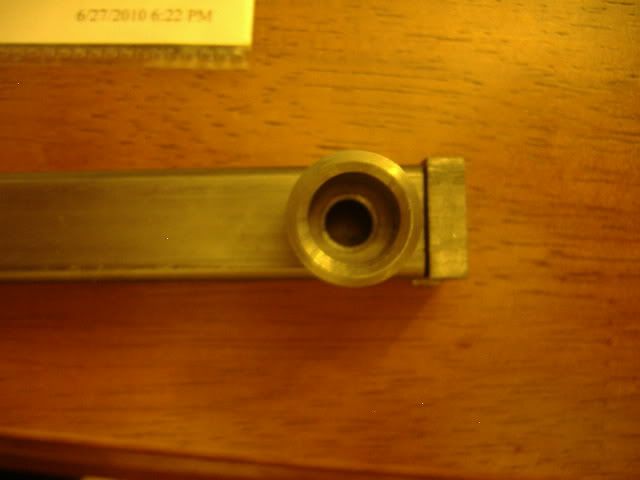

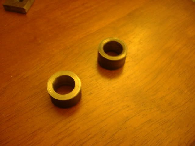

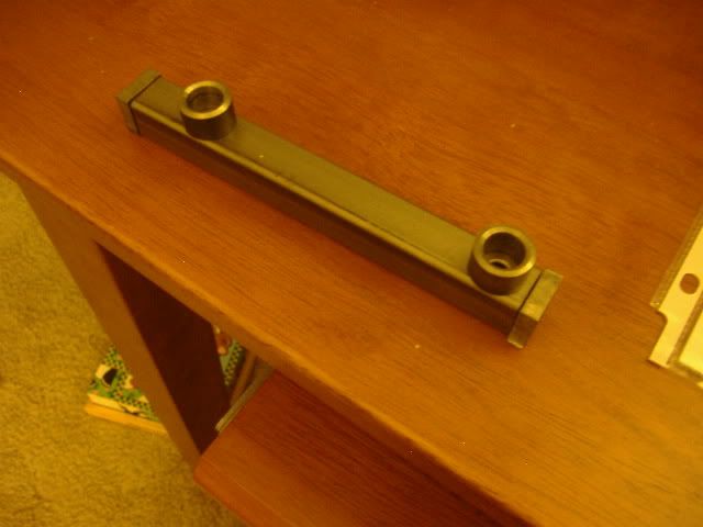

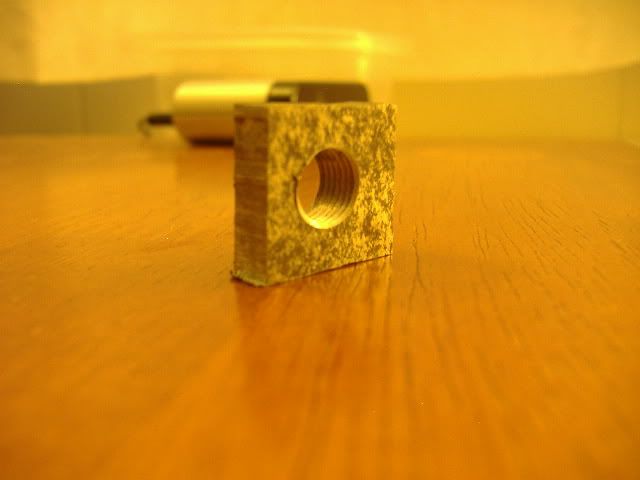

Started making my fuel rail injector bungs. I don't really have a before shot, but just imagine some 7/8" bar stock. I cut down the outside to about 3/4", then drilled the center and bored it to 17/32" Then I chamfered the end to ease the o-ring entry. I still need to polish the inside a bit, and take some of the edge off. Overall though I'm extremely pleased with how they turned out, and I'm having a blast with this new tool.
Tapping 1/4" plate is a pain in the butt:
Still some finishing work needed before I weld it up, but it's one step closer, a million to go.
Thanks for looking

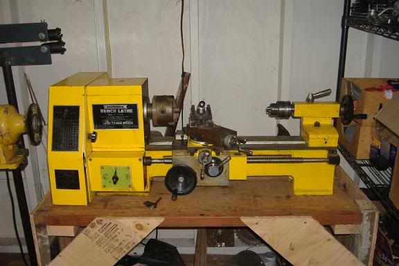

Haven't gotten any new work done to the bike, but I did get a new tool!
So first off, I realize it's a harbor freight lathe. I got it barely used for a really good price, and for the type of work I expect to do it should be great. I'm really happy and can't wait to try it out.
You nig nogs, it was only back one page.
There are huge cult followings for those things.  As well as writeups on how to fabricate everything and redo the entire lathe to the point it's extremely precise - also great machinist training for the homebrew crowd.
So this is something that would work for someone trying to get into some basic machining. ( ie: not waste $2-5K on a big machine when you don't even know how to use it, lol)
Yes.
This site now has some gay ass "premium content" section with a lot of the articles shuffled in there - a few months back it was a huge free resource with really good shit.  Anyway, this much of it appears unmolested, and it's the parts about rebuilding/modifying the lathe in order to make it very nice.
http://www.mini-lathe.com/Mini_lathe/Modifications/modifications.htm
I'll run a web spider on it today/tomorrow, try to maintain an archive before that shit dissappears.

Man that's the truth on the lathe. It's funny after I got it I started looking around and it's amazing how many sites there are covering upgrades to those things. There's even several people who have converted them to full CNC.

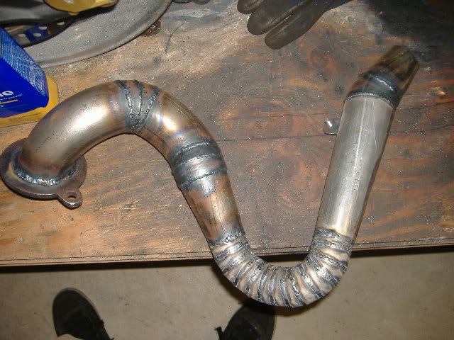

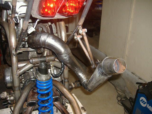

So I've discovered the inherent flaw in using pie cuts for everything. Besides tons of welding that is. All the heat from welding, and all the little gaps added together means a lot more opportunities for the metal to pull. I finally welded up the exhaust and the turbo manifold. The turbo mani pulled almost a quarter of an inch, so I had to cut it apart again and add in a section to get it back where it needed to be. Whew, that was a lot of welding :)

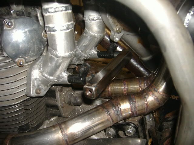

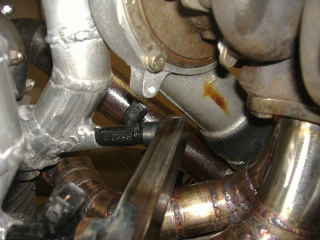

Also I welded up the fuel rail and installed it. I still need to figure out some mounting tabs for it, but it just looks so cool in there I had to take a few pictures!
It's a tight fit for sure.
I'm optimistically about a month and a half away from starting this thing up, got to start checking things off of the list so I can accomplish that.
Welding up the intercooler piping is next.

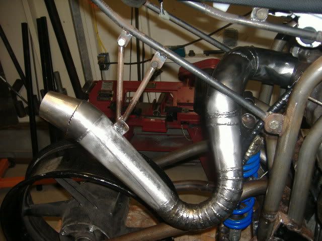

is it a 2 stroke. if not why the hell is that exhaust pipe all coned out
twin50 son. get some
and stop acting like a muslim
My thought is to look like a muffler. Being turbo it won't need one, but it looks like it has one.
