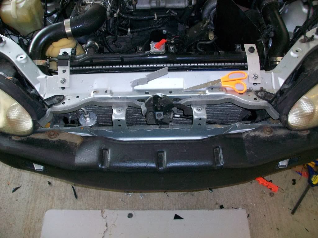

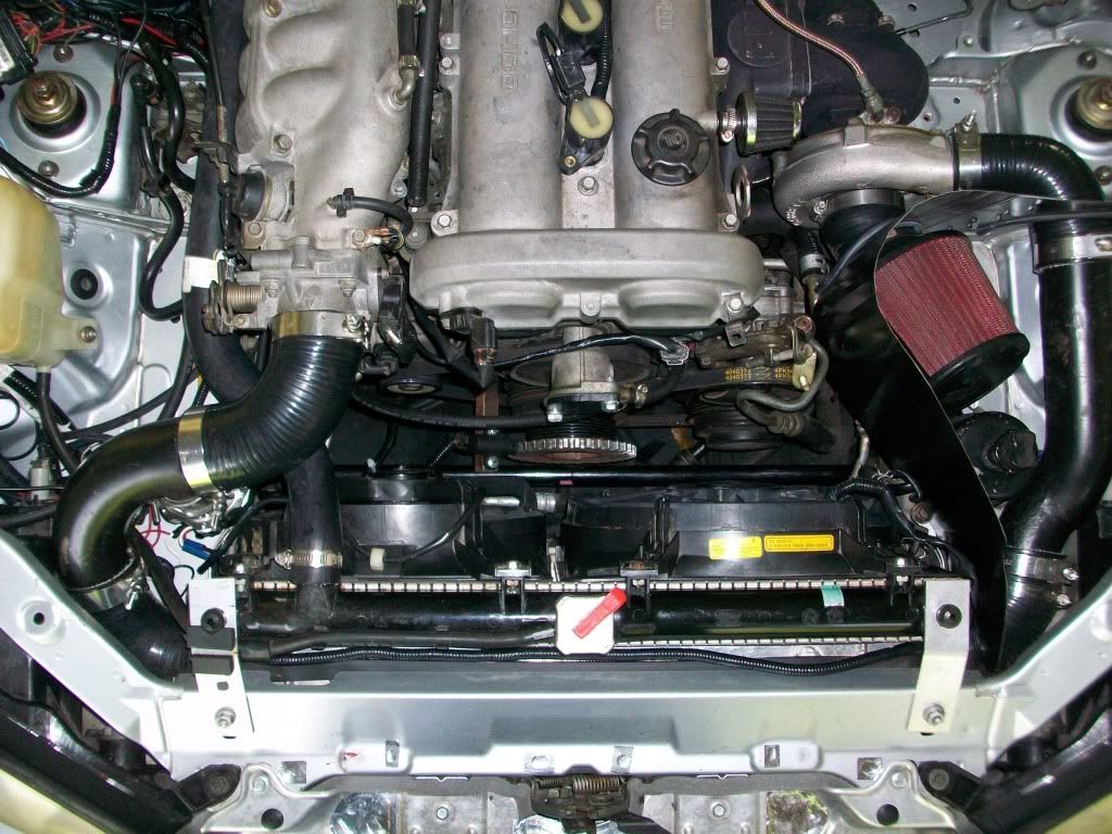

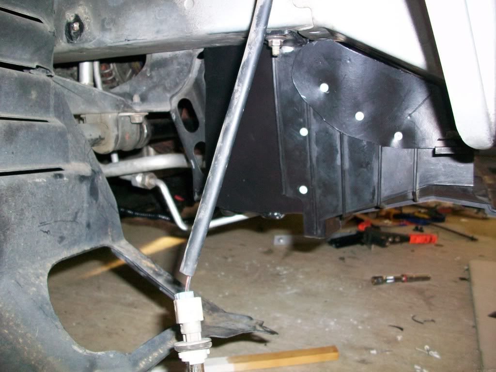

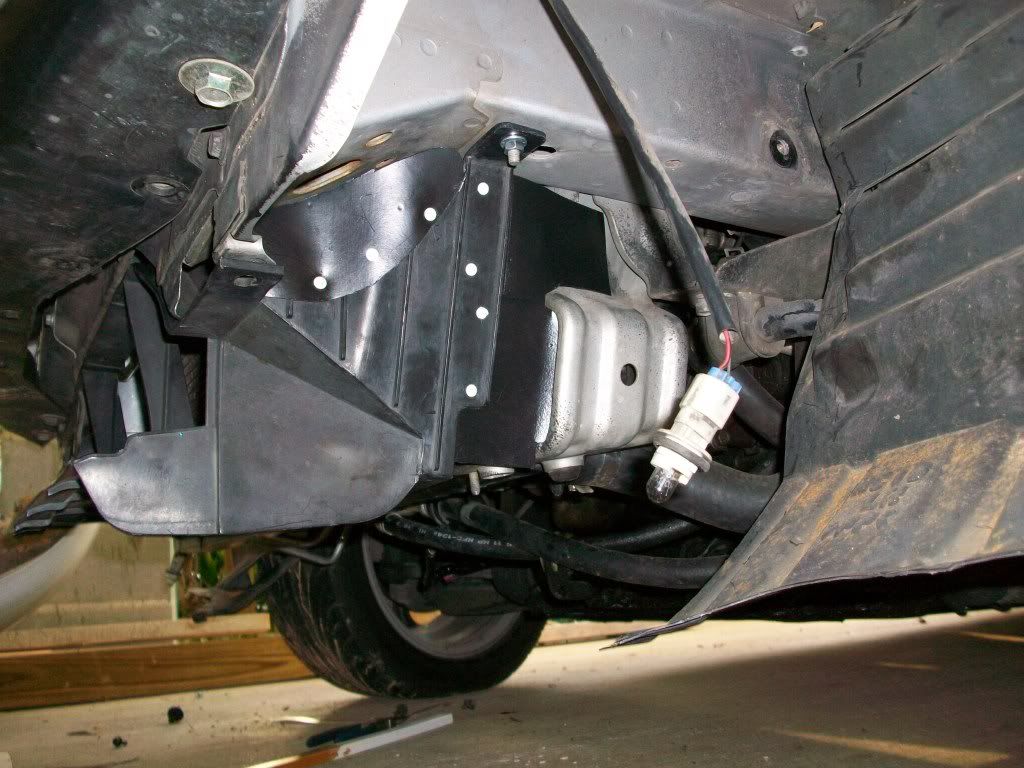

Pics
Before I did this, my miata would overheat at 55+ mph. I run a 195*F thermostat, stock radiator, 20x12x3 core IC, and an A/C condenser. About 300whp setup. Before the shrouding, it ran ~205*F at low speed cruise, fans on at 200*F, and after 55mph it was over 220*F.
After doing this, it sits at 196-197* at anythng below 65mph, doesn't matter if it's 40*F or 105*F with the A/C blasting wide open. At 70mph, it runs about 205*F with fans on.
