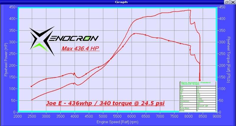

Here they are in order.
60' 1.651 best 1.732 1.666
330 4.610 4.617 4.516 best
1/8 6.984 6.927 6.837 best
mph 101.94 106.11 best 105.60
1000 9.065 8.922 8.845 best
1/4 10.795 10.614 10.548 best
mph 130.52 132.83 best 131.96
Car and motor built by myself for all the new guys, Tuned on EcTune by Xenocron. Tons of credit to him. (I dont want to hear it)
Basic setup...
Stock Bore Z6 w/ stock sleeves, Vitaras, Eagles.
Ported Z6 head w/ 59300 and valvetrain. Porting by me.
Ported Z6 intake mani and 68-65mm TB from Chris here on HMT. Good guy. Polarbeartuning.com
Rc750's, 2.25/2.5 inch charge piping.
4 inch up pipe, 38mm ebay wg, Holset H1c 18.5 cm. 24ish psi.
Ebay baby intercooler.
Stock Si tranny, Act 4 puck, LSD PP, 7.5 lb flywheel.
STOCK baby hf/std axles
ETD traction bar
23x8x13 M&H on Lenso's (Plenty of tire for this power level)
Car made 436 whp and 340 wtq
Roughly 1950 lbs w/ me.
Sorry guys, no vids of the car this time. I didnt have my cam with me. Here is a dyno graph and pic @ the track. Sexy.

is that a log manifold?  O0

« Reply #44 on: March 16, 2009, 10:54:28 AM »
Block is not decked. Head is milled a touch just for straightness. Oil pump is ported and shimmed. Running straight 30w heavy duty diesel/gas oil.
The turbo will not support another 10 psi. Its losing boost at high rpm as it is. I think it has something to do with the rpm were running. We were shifting around 8900.
Build cost is really unknown at this point. Its gone through a bunch of changes that have all improved the setup. But its not an expensive build. The cam is the most expensive part really.

Re: 10.54. What more you want ?
« Reply #49 on: March 16, 2009, 01:26:41 PM »
I did the intake manifold. I have worked on flowbenchs enough I know what works and what doesnt. Proof in the pudding is it works.
I think that it might be a wastegate issue, as in drive pressure opening your wastegate. I have run that turbo over 40psi and not had it fall below 40psi @4000rpm in a 5.9L motor or ~23600lpm vs your 1.6 @ 8900rpm ~14240lpm. The drive pressure on that turbo @ ~40psi in my experience has been (with a log mani and the 18.5cm housing) about 50 - 52psi or about 1:1.2 which is imho pretty safe, drive pressure to manifold pressure.

« Reply #58 on: March 16, 2009, 05:21:40 PM »
Found one why its been losing boost. It was doing this on the dyno too.
Exhaust gasket on #1 runner was totally GONE and the 1 of the 2 bolts on the WG was falling out. BIG leaks. Ill have it all taken care of by the next track day. Im also getting my exhaust manifold flange milled since its pretty warped.
The 2 springs in the WG equal 20-21 psi. The boost controller is only adding about 4 psi.
Head was ported and I didnt follow any guides other than what my finger felt going through the ports. Took out whatever didnt feel right to me. Nothing special, but it seems to be working fine.
The turbo now SHOULD support more boost with the exhaust leaks fixed. Maybe we'll throw a couple more psi into the motor.
dvst8r - Thanks for the info, now im confident I was having issues only because of the leaks.
I think just a 50 shot will get the car near 10.0 to 10.1. We'll see.
