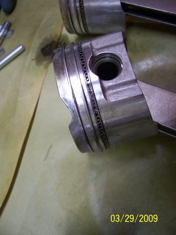

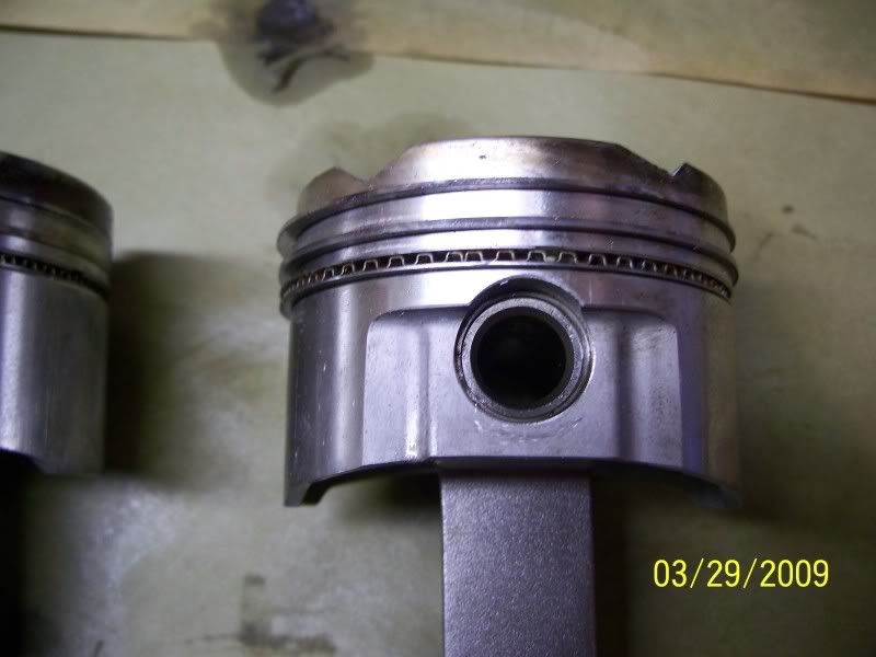

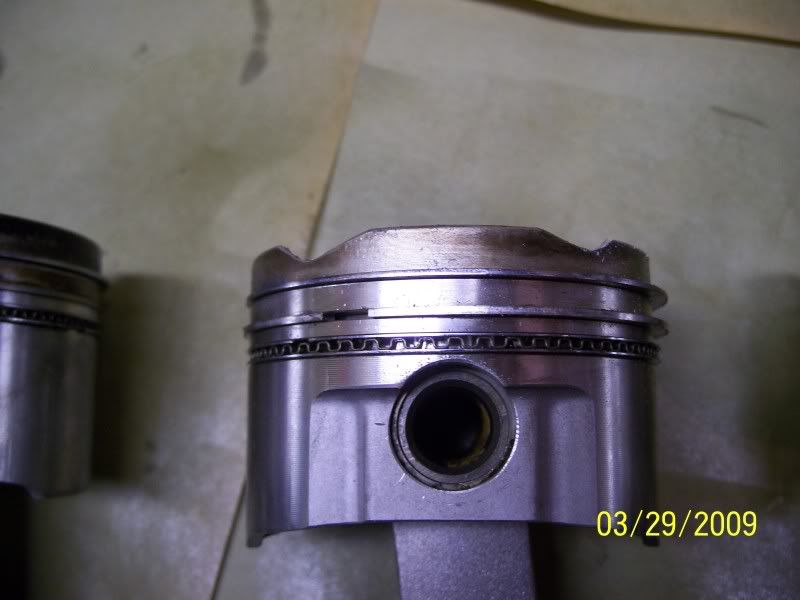

After filing:
After filing
I noticed that the valve reliefs were weakened and partially damaged along the perimeter of the pistons so I filed away the damaged areas.
Does this look ok to reuse these pistons?

« Reply #1 on: March 28, 2009, 11:17:26 PM »
They should be fine vitara's look like that new.

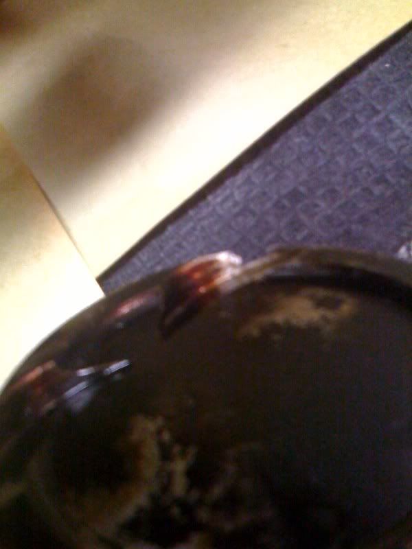

Lastly, and this is the MOST IMPORTANT, can you post pictures that are in focus?
Re: SRP D16Z6 damaged valve reliefs
« Reply #5 on: March 29, 2009, 04:47:01 PM »

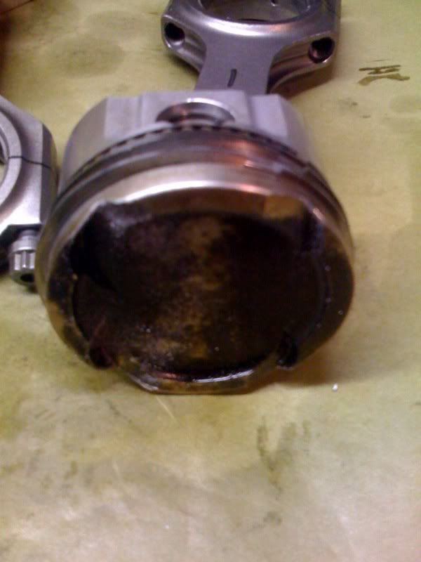

iphone pics FTL
Im hosting better pics now.

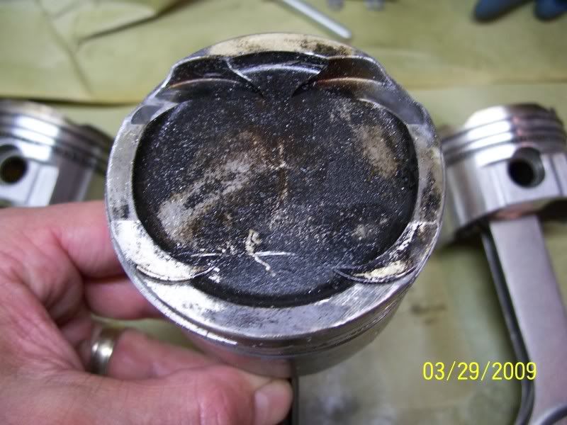

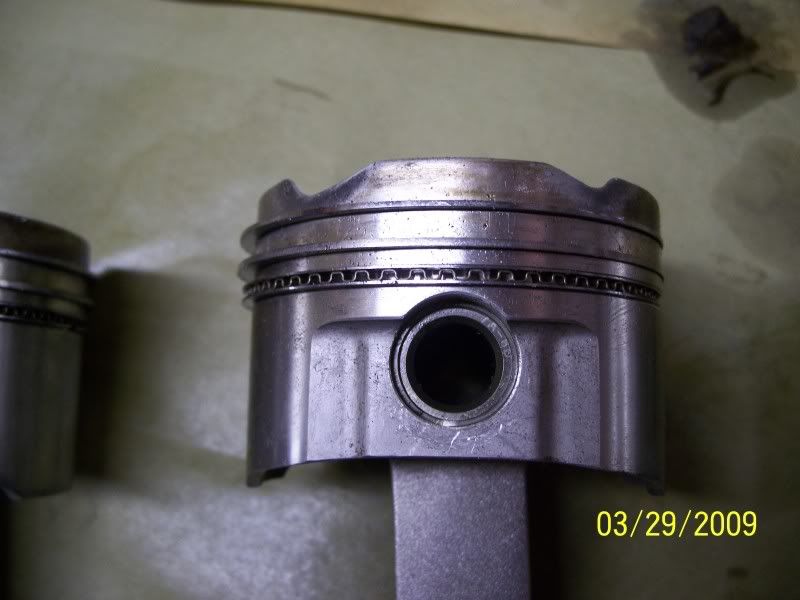

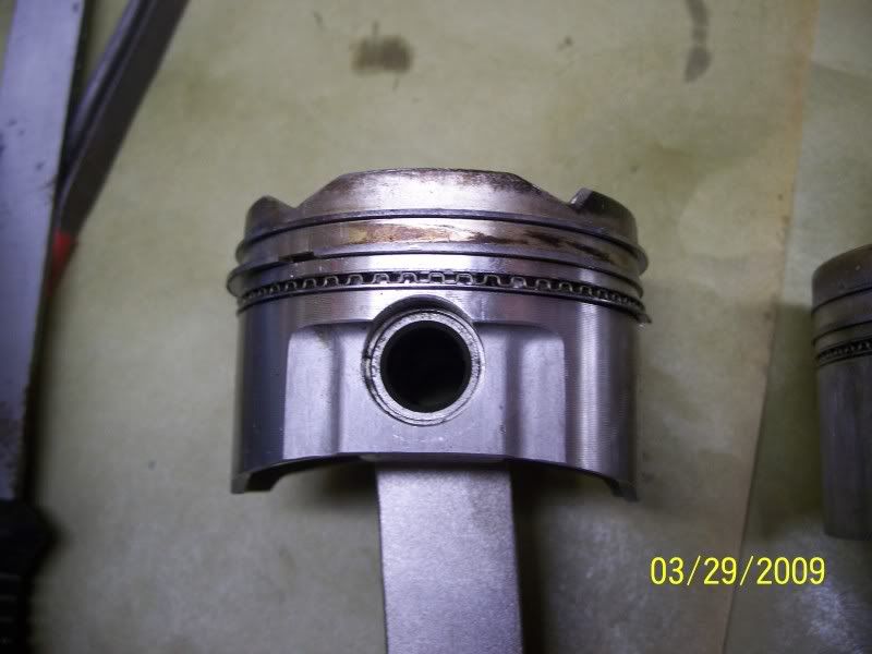

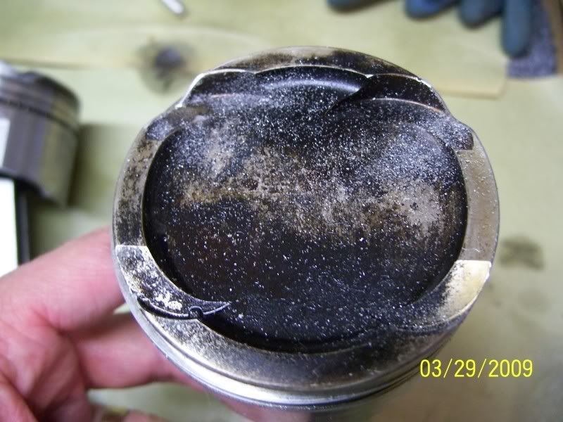

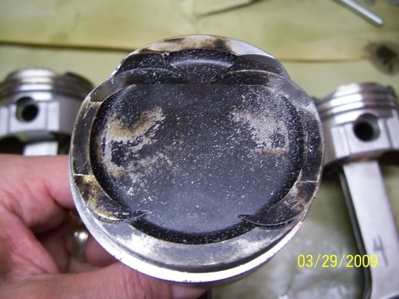

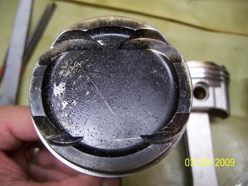

Alright, those look better than I thought they would from your phone pics.  There's a tiny amount of carbon blasted out of the top of some of the pistons but no actual pockmarking of the piston surface - what detonation it saw was cosmetic, and shouldn't hurt anything.
Spiralocs are dirty cheap, if those were my pistons I'd pull the pins to make sure everything is legit.

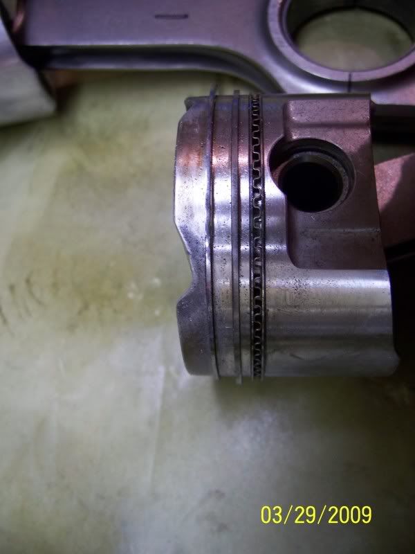

Top ring to land gap is .038mm = .0015
 SRP specs should be btwn. .0015 and .003, so, thats within specs.
This piston looks like it is cut deep into the top land.
Im going to have my machine shop look at it tomorrow.
