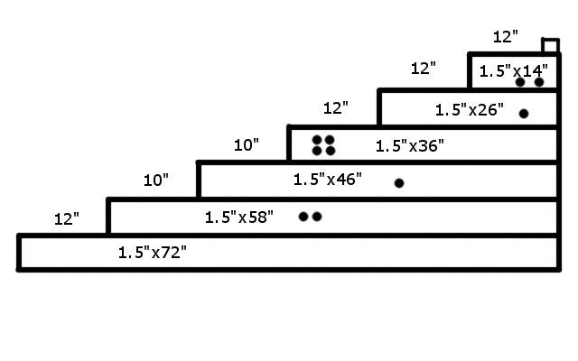

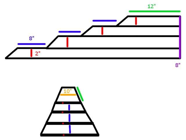

With that being said I was thinking of this. Any flaws you can think of with this plan or improvements? Anyone have an idea on the price of the lumber (haven't had to buy any in years)?

why does it get so narrow at the top?
Because if you were looking from the front of a 6' long ramp it would appear narrower at the top even though it isn't. I was trying to keep it realistic.  :P

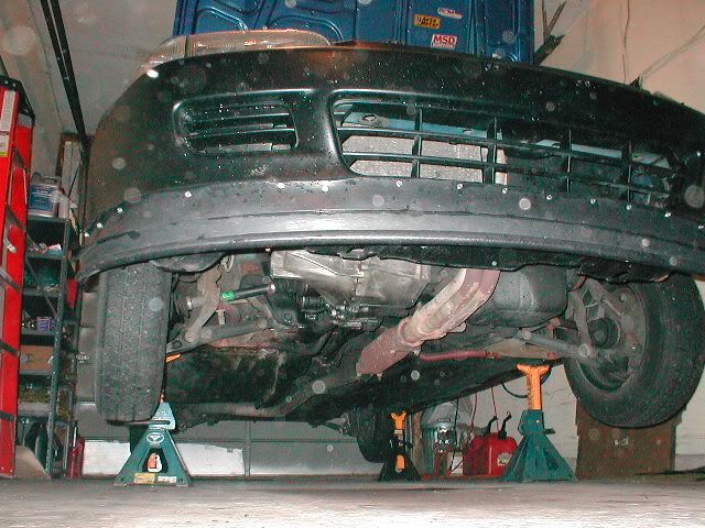

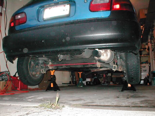

 However, being the cheap and lazy person I am I do currently have it up in the air; parked sideways across the driveway, off the concrete ledge, over a 2x4, onto the metal ramps, back passenger side jacked up with jack stand under the rear. It seems somewhat stable, but if I don't post in a few hours someone call 911.
Foreshortening.

I'm aware it is .5" off, which is retarded as shit why can't they just do it by the right measurements. I was going by the "marketed measurements".
This is the one I was going to go with if I built it. I decided to do six levels. The matching dots means that that is the leftover from the matching board. The one with the four dots is equally split and would be used on the other ramp.

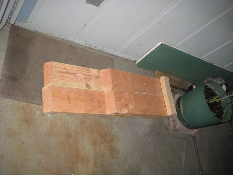

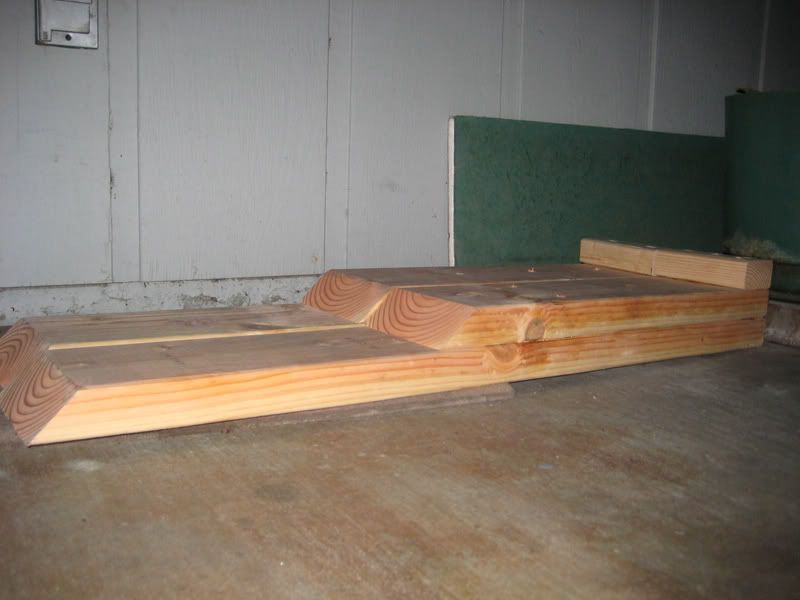

here is my mini ramp i made so i can oil change some cars with no jack and or give me clearance for my shitty craftsman HD which is ultra tall which sucks for low stock cars
the last small peice of wood is a feeler/stoper so i dont drive over LOL
same concept just make it longer and higher
