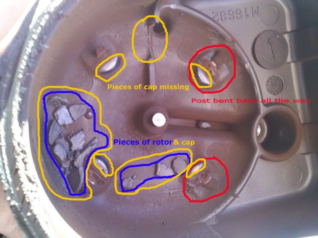

Ok so let it warm up again to see about adjusting distributor. I revved it some and noticed that it was missing/stumbling. I decided to just do the plug wires one at a time to see if I could narrow it down. I started with #1 of course which when I changed the plugs they all looked good except the #1 plug. It looked black and dirty.
Jumped in the car and fired it up, no missing at all. Popped the old one on again, missed. New one again, no missing. Was happy I found the culprit so changed the rest of the plugs. I still don't have a light, but I retarded the timing a good bit from what it was closer to the middle grounds until I get a light.

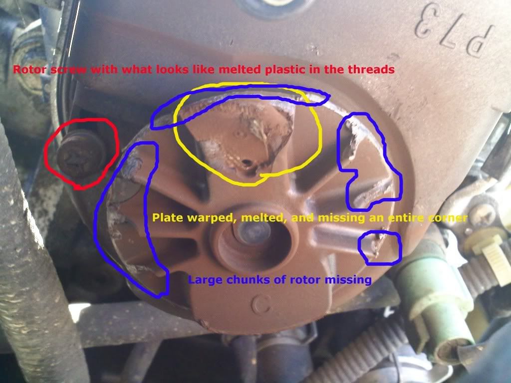

Since I already had the intake out of the way I decide I might as well pull off the cap and inspect it and clean it up if there is any corrosion or anything. I took the cap off and was shocked. I'm assuming the plug wire was still bad as it ran rough when I put it back in, but I have a feeling this may be the main issue.

So was the rotor screw not even in its spot?
I would suspect that the coil is about to take a shit and is running hot if the rotor screw was indeed where it should have been and tight.
Weird.
Re: Doug's 99 GSR Failure
« Reply #152 on: April 09, 2010, 06:48:44 PM »
Weird.
No the screw wasn't in the rotor at all. It is wedged in between the inner dizzy cover. The rotor was able to move in and out freely which obviously caused the carnage.
« Reply #153 on: April 09, 2010, 06:51:23 PM »
Weird.
Ah.  Yep, that'll do it every time.
lol.
« Reply #154 on: April 09, 2010, 06:56:11 PM »
Yeah sucks as I was hoping the simple plug wire would have fixed it, ecstatic that it isn't the actual distributor going bad like I had originally feared.

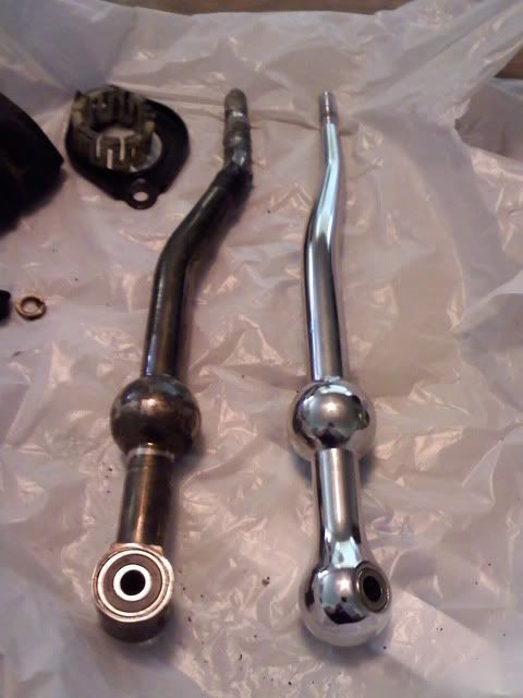

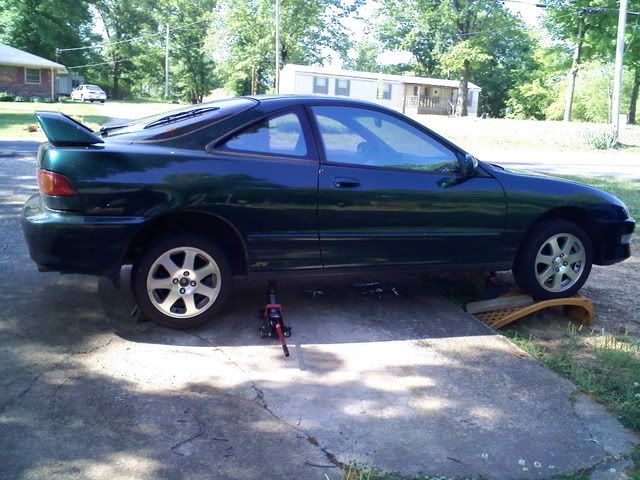

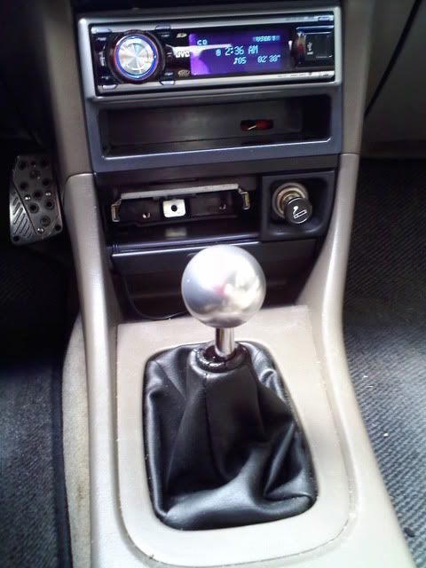

Another small victory. New short shifter in.
Ghetto jacking
About the same as the other short shifter, but now I can use a threaded knob finally  :mexi:

That is far from ghetto jacking sir, You are not using bricks, books, or any other unsafe method. You fail at ghetto sir
« Reply #166 on: April 30, 2010, 08:06:50 PM »
A good jack is one of the best investments you'll make.  Along with a good air compressor.
« Reply #167 on: April 30, 2010, 10:39:40 PM »
I got a good air compressor. The jack is just a Wal-Mart GM Parts jack, I had a really nice one and the cylinder blew after having it for years upon years.

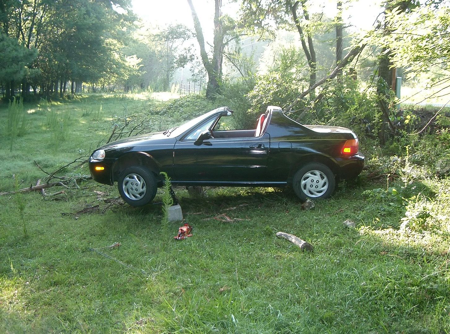

You can barely see the road behind it that the car went through a fence, and launched on top of a dead tree.  We had to jack it up off the tree to pull it out from under it so the car could drive.  Doug remembers that :P
« Reply #172 on: May 09, 2010, 10:34:09 AM »
That sucked. Waited on the tow truck for like 3 hours and then found out it still wasn't on it's way. So went and grabbed some cinder blocks, my red jack and OEM jack you see plus Jorshers OEM jack. Not only was it on top of a tree behind the wheels which had it a good bit off the ground, but there was also barbed wire wrapped all around the passenger tire and into/through the bumper. That Del Sol stared Satan and the face and said bend over bitch. I think it survived what like 5 wrecks?
