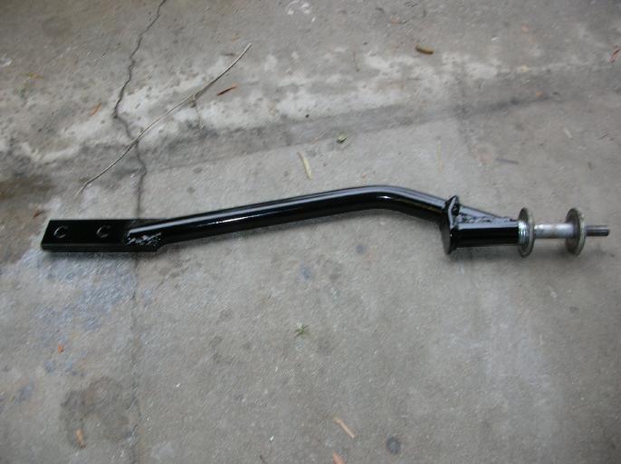

Looking at the EG A-Arms, maybe find a way to solid mount the radius rod to the LCA, and then have a heim on the rear crossmember, to pivot at the same axis? Maybe even make the radius rod at a 90 or close, with triangulated support, so that it really does pivot at the same axis and angle?
Pic of the EG A-Arm
And for some reason, as I was typing this, these came to mind.
http://www.performanceforum.com/wesvann/honda/rad/rad.html
Sure, that doesnt completely apply. But it just gave me the idea really.
I could possibly have the radius rod attached solid to the LCA, have it point towards the back of the car, and then 90 or less inwards. And then have a heim joint on that end, and have it mount inline/parallel with the LCA pivot point. Should mimick the EG A-Arms pretty well I would thinking, and not cause any binding. But all the while, reinforcing the LCA to reduce lateral movement. Right????
