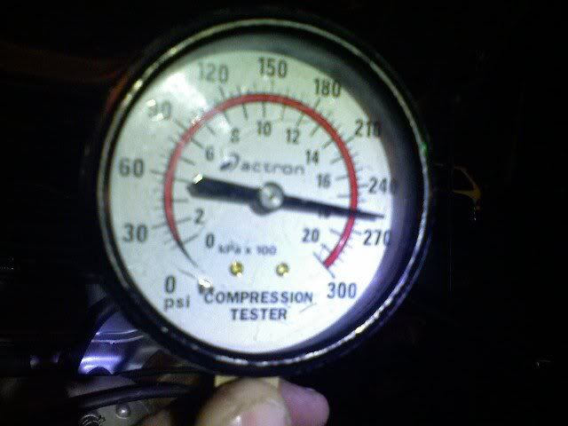

The tester reads:
170 psi
180 psi
190 psi
200 psi
210 psi
220 psi
230 psi
240 psi
250 psi
260 psi
270 psi
Author Topic: What's my compression?  (Read 13994 times)
« on: April 14, 2009, 11:08:53 PM »
"D16Y5 Type-R," 12.5:1 CR SOHC.  Basically a GX with an HX cam.  I pulled one spark plug and cranked with the other three in place @ WOT.  Guess.  :)

260.  I had a nifty pic but my stolen internets went down again.

Re: What's my compression?
« Reply #14 on: April 15, 2009, 02:52:21 AM »
winner winner chicken dinner.

250, mulitply CR by 20
« Reply #17 on: April 15, 2009, 08:20:03 AM »
I calculated 265.23 PSI
Gauge variance.

« Reply #18 on: April 15, 2009, 01:48:45 PM »
You mean this picture??
« Reply #24 on: April 15, 2009, 06:09:17 PM »
My old d15 w/ milled y8 head and zex 59300 made 235 across the board.
Yours sounds just right.
D16Y8-Z6.
« Reply #25 on: April 15, 2009, 08:27:30 PM »
That's some good numbers. I have 270 across my 11:1 stock bore/cam h23 vtak
