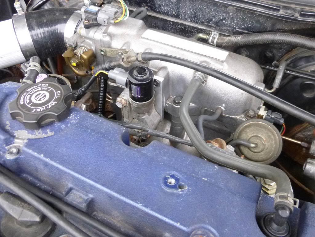

I recently re-made the IACV adapter plate. The 98-ish H23A motors use a plenum with a 3-wire IACV on the front. It's similar to the Euro-R, but the bolt pattern is mirrored so I can't use the Rosko adapter. What's guy to do? Make his own:

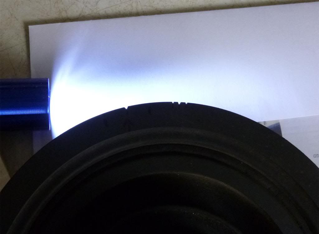

Next improvement is due to the fact the H23A has no crank timing marks like most H-series. The first motors I ever worked had TDC marked because the aftermarket shit was always off a bit, so I had an idea what I was doing.

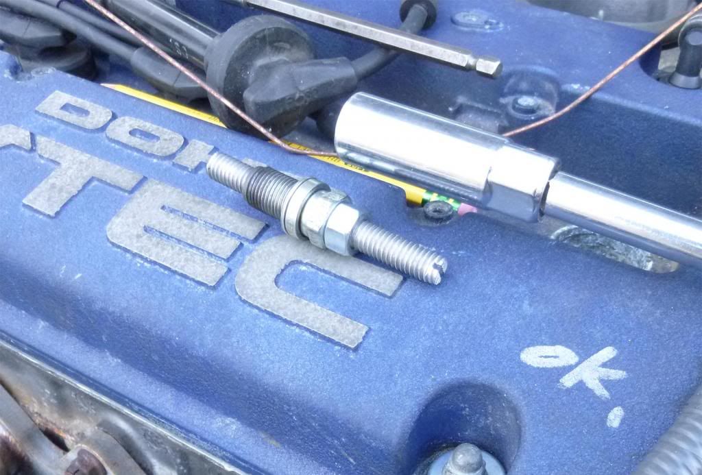

First, make a TDC tool from an old NGK spark plug & 3/8" aluminum threaded rod that won't dent the piston. Use a jamb nut on top & notch the top of the rod:

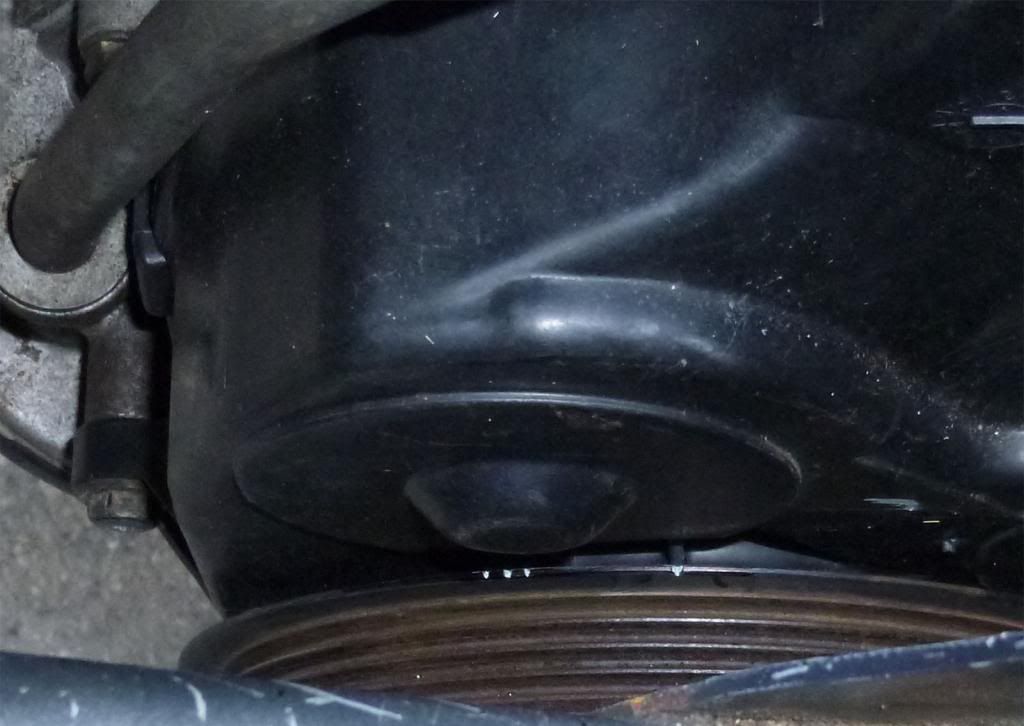

Decide on where your timing pointer will be - bend a welding rod to nearly touch the pulley rim in that spot. Then set the motor near TDC (slight after TDC), insert the tool w/o jamb nut, then use a long screwdriver so the rod lightly touches the piston. Turn the motor in reverse til the piston locks, mark the pulley at the welding rod, then turn forward nearly a full revolution til it locks again, mark. Take pulley off, notch TDC (0 degrees) which is exactly in the middle of your 2 marks. If you're lazy, you can use an adjustable timing light to flash the TDC mark at 16 degrees. Otherwise do some math (diameter * 3.1416 / 360 * 16) to get the 16 degree mark, notch. Do the same math to get the 14 and 18 degree marks:
The rib for TDC is behind the 0 degree mark in this picture - it's easy to see with white paint added while using a timing light:

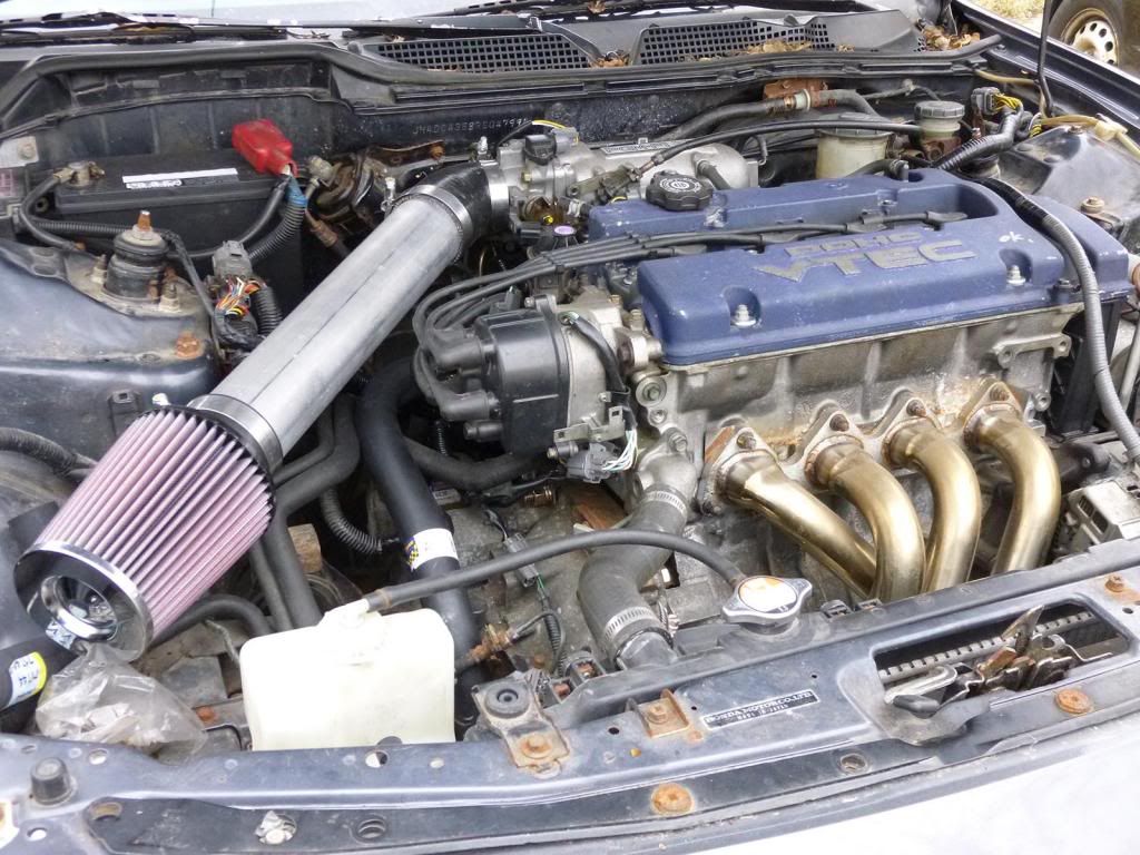

I've run shortram intakes from being lazy, so I wanted a nice intake for a change - but nobody makes one for this combination. I bought some 3"x0.065" aluminum tube from ebay for ~$13 per tube (36" for two tubes at $26, cut with a killer Diablo non-ferrous blade), a 45 degree coupler that's 2.75" to 3" for ~$9, and a K&N filter for ~$35 off amazon. Add some free 3.5" t-bolt clamps I've had since forever and this is what you get:
I'll do the same thing with my other car I just bought (a 92 hatch with show-quality paint & zero rust), so that's under $60 each for two 3" intakes. I was planning on painting them with wrinkle paint, but I kinda like the raw look now.
The next step is to finish the exhaust, which is some cheap ebay 97-01 Prelude header and a DC/EG ebay exhaust. I got a Prelude test pipe, which only needs ~3" removed to make it work. The exhaust & header line up so perfectly it's hard to believe! Then I'll toss in the wideband so I can finally get the latency values for a new type of 363cc injector I'm working on. They'll be called Injector Nation IN390's, flowing ~360cc with Heptane from a 6-hole vector plate in a cone the same size/shape as stock injectors. I'm hoping for at least 185whp/155wtq on a dynojet with this cheap setup on mild street tuning.
Unless I get a bug up my ass and install the skunk2 K2H adapter I got for cheap along with the K20A2 PRB intake manifold...

I had a piston stop for Honda GX-series (lawnmower engines), but it was 1/2" too short. I'm glad the NGK plug had the right diameter for a 3/8" tap, or I'd be pissed.

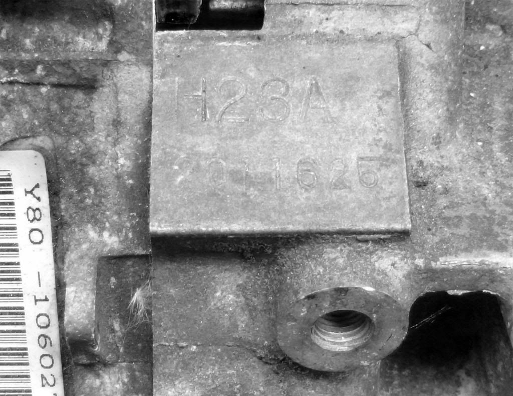

The first thing is to get the crankshaft ground out for a b-series pilot bearing. It needs to be at least 32mm wide and over 2mm deep. I used a stubby grinding bit in a rotozip from Vermon American (from Homeboy Depot).
Next you have to drill the flywheel for the pin in the flywheel. You can also grind it off the crank. Beware the OEM flywheels are very hard in that area, I burned 2 bit before notching with a grinder to start the hole.
After that you enlarge the rear starter hole to 1/2". I used a step drill bit and a 1/4" hex bit extension to reach it all - make sure you start from the block side of the trans. Get creative with the bit (angle it) to slip the 1/2"x6" bolt through, or get a oversized 3-flute drill bit designed for enlarging holes in castings.
Now you can hang the trans from the block via the starter hole & pilot bearing. Drill a 1/2" hole for a 1/2"x5" bolt through the trans hole just above the clutch slave cylinder.
You can also work on that area to get the slave cylinder to fit. It will take some time, but the pics should give you a good start.
You can move up to the block stamp. You need to cut the window a bit longer (downwards) by 1/4". If it's a newer F-series, it may not even have a timing window. Cut it large enough to fit the open tip of a 3/4" box wrench into it.
You need to do some more grinding behind the window. There is a knob/pin that sticks out and needs to be shaved. Beyond that the block webbing between the two top holes needs to be removed a bit, especially on H22/H23/F23 blocks. This gives the bolt through the trans a place to sit. If done right it also keeps it from spinning.
