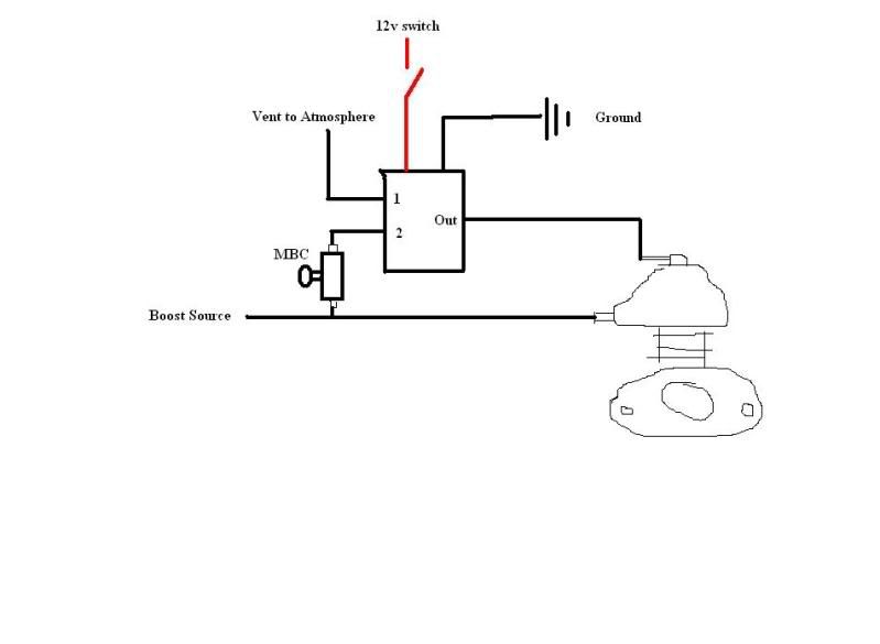

There have been several threads about using solenoids/purge valves on how to manage different levels of boost.  Some of them were too complex for my liking involving multiple solenoids/purge valves and switches.  And I'm too cheap to go Neptune, ecTune or Hondata right now...
I'm currently using a Tial wastegate and have one of the cheapo ebay manual boost controller.  Below is a diagram of how I planned to hook it up using a 3-way valve from Grainger ( http://www.grainger.com/Grainger/wwg/itemDetailsRender.shtml?xi=xi&ItemId=1612667260 ).
My question, do you guys know if the solenoid is one of those all or nothing valve or does it have variable amount of open/close like the hondata solenoid?  I would prefer an all or nothing one obviously...
In the diagram, when the switch is OFF the flow, the turbo would boost off the wastegate (boosting at whatever level its set at), but when the switch is ON, ideally it should boost to the level of the boost controller...
Let me know your thoughts...

With the setup you described, this is how I would route it

Would the boost be more steady and less boost creep they way you have it set up?
Also which solenoid did you use?

never hook a MBC up to your penis like that. you're just asking for a trip to the ER.
if you need a solenoid that can be modulated via pulse width, GM EVAP solenoids are PWM capable. delphi has a chart that plots flow vs. duty cycle, and they're on almost every GM car made in the last 15 years.

$25
http://airinc.thomasnet.com/Item?cid=1141&plpver=1001&prodid=3001111&itemid=13807&assetid=spec
Awesome I bookmarked that link.
