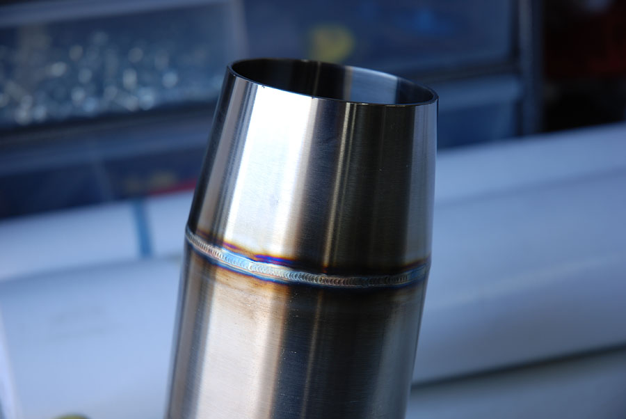

thx for replies, what o want to get is something like this:

That looks like food Grade Sanitary Stainless.. We have a place that sells it locally... Nice stuff but not cheap..  I bought one of those transitions  2-2.5"  $18.... It does weld up nice though.
If thats the stuff you are using, you don't even need to clean it.

Just use a scotchbrite metal finishing wheel on a bench grinder to get that finish. Then run your tig at 1 amp per thousandth with no filler to get that look with a gas lense.

If you want it to look like that buy sanitary stainless, you can get mill grade tube to look similar with a bit of work but not quite.

walter, that pic is markku's work from http://agtronicmotorsport.com/  he only uses sanitary grade stainless.  i'm not sure of his cleaning method though.
