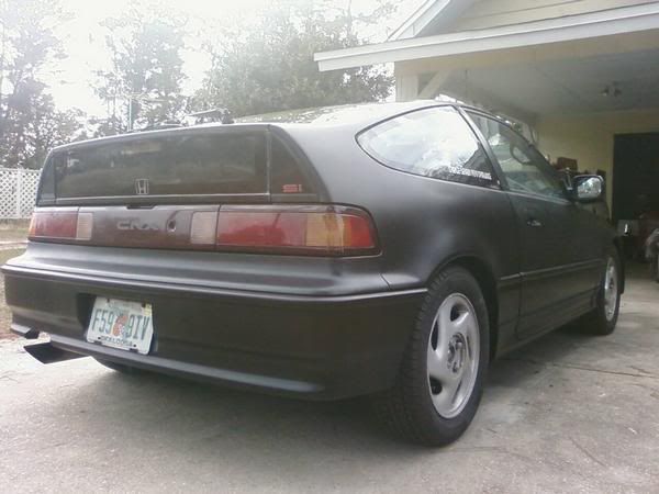

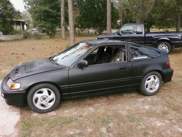

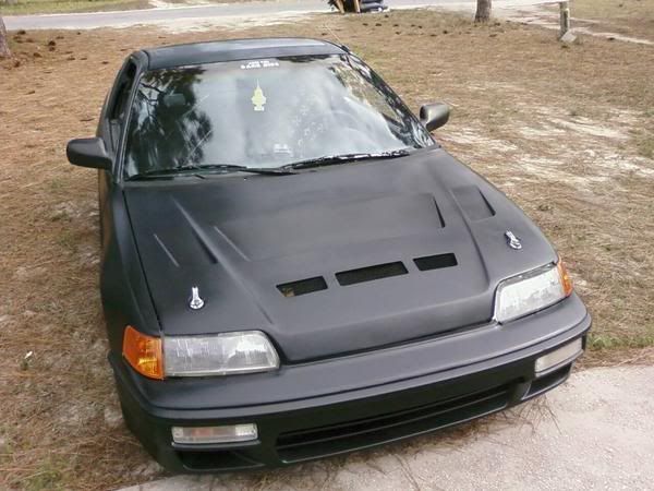

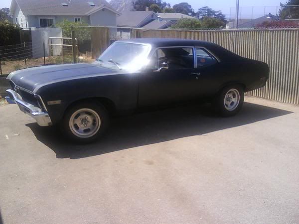

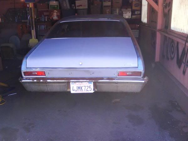

Before
During
After
What do you think fuckers?
took me a week and about 20 cans of primer and walmart sealer.
only about 125 bucks into it including sand paper.

« Reply #2 on: April 30, 2009, 09:18:24 AM »
If you wax it will it take off the smudges? I have no clue since I have never messed with paint so far. It looks prepped to go to the paint shop now but you guys do it different in the dirty south.

Re: My RATTLE CAN paint job
« Reply #3 on: April 30, 2009, 01:55:23 PM »
I rattle canned mine and you cant even tell it was done with a can.  dont even have the smudges  :noel:
In the south we dont "go to paint shops" The paint shop comes to you.  That or you just final product it yourself
I recommend different paint.
Wurth satin black trim paint is the shit i use
this one had uneven paint on the roof and hood, but that shit was easily fixed with another coat.

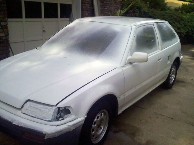

sorry i dont have much for pics. i let my parents borrow my camera and this is just what the dare took to send to a few people.
from the hotrod.com article here's the first coat of primer
some wetsanding & coat five
my civic. here's the difference in one sprayed on coat (super cheap HF HVLP gun) of rusto clean metal primer (thined maybe 10% olderless mineral spirits, civic sized car takes about 1 quart to do the whole car)
it's slightly orange peely because I dont like primer thinned out. it very prone to running! not sanded (i didn't save any of the primer, just the like 2 areas that had runs in them) anyway... i probably got more paint actually stuck to the shotting one coat of primer on than they did ultra thinning regular rustoleum & rolling it on. and surely whatever slightly orange peel i have (i chose VS having it run) was leveled out in maybe... 5 minutes wet sanding for the WHOLE CAR after the second coat was dried.
hehe i masked off the front headlights thats it. I gotta paint scraper for windows (less time to scrape them off than mask them up) and all the rubber trim looked like shit so... it ALL got meh whole car fucking rusto'd lmao

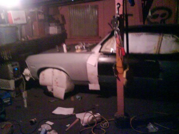

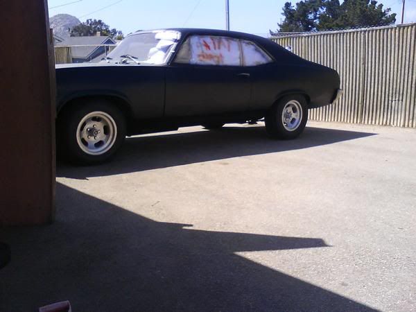

gonna do my nova rustoleum flat white
That'll look badass. Also once again I'm jealous I want a Nova :(
