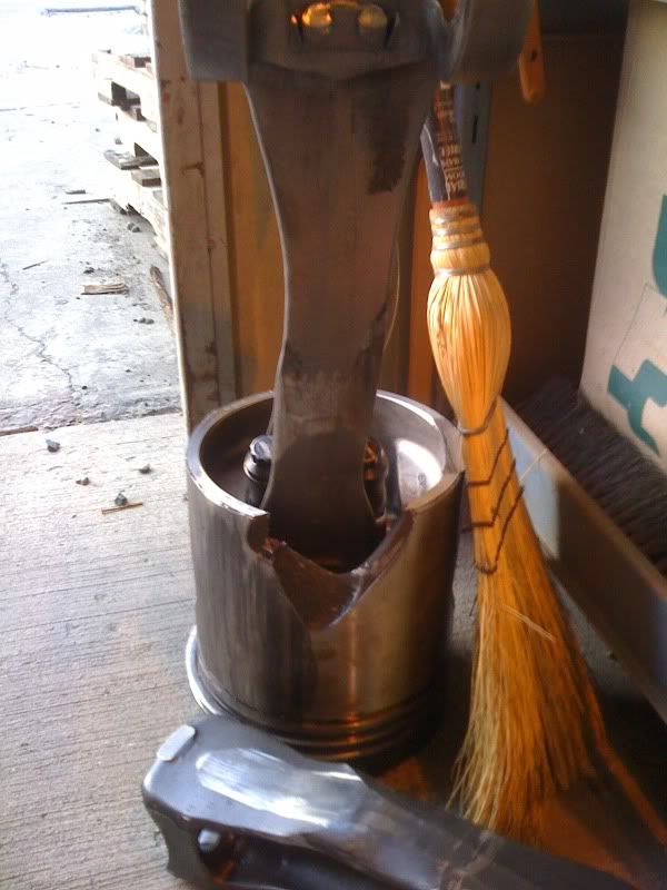

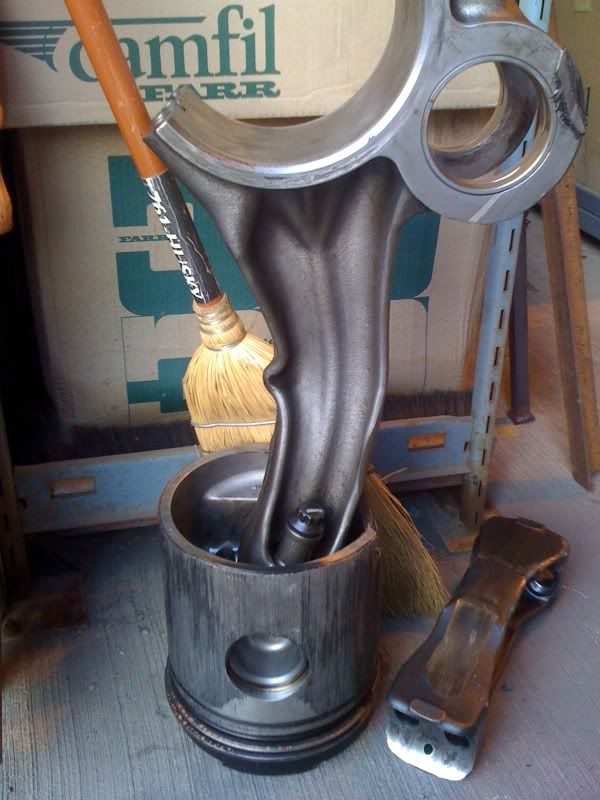

this is from a 4400hp General Electric locomotive. Got told to load box it, blew the turbo and did this. :evil:

Re: bent a rod at work today
« Reply #1 on: November 07, 2009, 01:12:11 PM »
Nice work, take that piston rod combo home, and make it a stand for a bench grinder.

some dumb mechanic has claim to it, ive already got 3 or 4

So what actually caused the failure?
after the turbo was changed, mechanics forgot to open the compression plugs. I'm just an electrician, turned it over till it wouldn't anymore.
