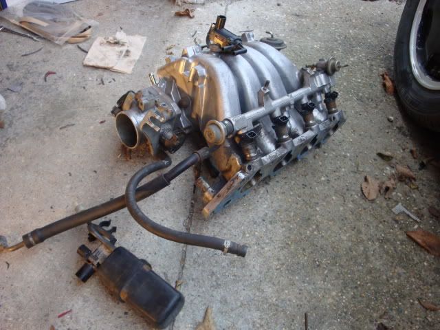

Well I'm not sure if this Canadian guy is just a dunce or not, but long story short:
18 days ago I paid for a stock GSR manifold, fuel rail, TB, iab vac box, and IACV. Finally got it yesterday - it is missing the IACV, TPS is cracked (expected), metal vac tubes are bent all over, and to top it off ... GIANT CRACK through half of runner #4. FYI this was from H-T.com, only place I could find a "complete" GSR intake manifold.
So I filed a complaint with paypal, and plan on getting whatever I can for it w/o shipping back. Otherwise he's paying for overnight'ing it back to Winnipeg from Wisconsin. Regardless of the outcome, I'll get my money back. The credit card company I used to pay with is awsome, and will definately give me a charge-back since I always document the shit out of my purchases.

If you look in the pic he sent, you can see the oily line at the base of runner #4 (closest). In my pic, you can see how oil leaked from the crack, besides where I wiped it off to make it visible. Another thing to note is the coolant tube below the throttle body (barely visible) - it's bent & twisted 180* the wrong way. It's not a big deal itself, but shows there were 2 visbile defects BEFORE he shipped it. I think he's going to try claim insurance, otherwise I'll fight for every dollar through paypal, and through the CC if needed.
click for super-size CRACK:
An original he sent me
Picture I took today:
JBWeld?
Think it will help hold 20psi of boost? :P

or just take it to a alum weld shop and have them weld it up.
Re: damn canadian scammers
« Reply #8 on: November 05, 2009, 08:32:47 PM »
Or just buy another gsr manifold bare they arent worth much 20 bucks at most. Finding one local shouldnt be hard since gsr manifolds are usually thrown away by most.
welding would cost more than finding another bare one

when I took the direct port nitrous off my manifold I just sprayed the four holes in the runners with brake parts cleaner and then stuck a blob of JB-stick weld on/in them to fill the holes. Been boosted for 11 months now and I've pressure tested the manifold/charge pipes to 28 PSI, shit don't leak.

The problem is aluminum cracks like to propogate (spread). If I keep the manifold, I'll probably give it a shot though. I have some devcon alum epoxy that works tits on alum. I'll drill the ends, try to open/clean the crack with acid or something, then try to create a vacuum deal to force it into the crack.
