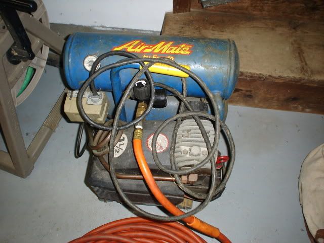

And here's the compressor I'm upgrading from:
 O0

« Reply #13 on: November 17, 2009, 08:09:09 PM »
She's a big girl...

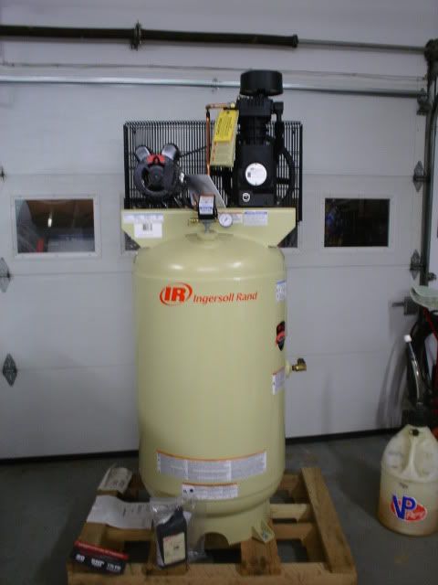

Re: Air Compressor Help... Single Stage or Dual Stage which to buy?
« Reply #15 on: November 17, 2009, 08:43:33 PM »
Nice choice.   ;D
Get that fucker installed, and give it some nice sneakers for its feet.
 :P
I used these when I did mine, and it sure is nice to not have the vibrations form the compressor shaking the entire floor.
http://www.grainger.com/Grainger/items/4C876?Pid=search
Dunno for sure if those were the exact ones, but it looks like it from the weight ratings.
You get the idea at least.
