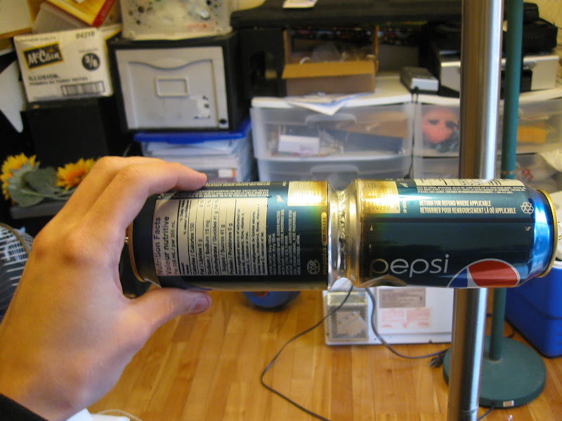

There is my first try. I didnt really know how to do so result is not super nice. I didn't clean the cans too.
Rod are 3.50$ for 2 so I didnt want to put 1.75 to weld 2 cans together  :-\
The trick is to get the pieces you want to weld very hot then put the rod on it. Once the fusion bath is done it's pretty easy to move the rod to weld the pieces together.

actually looks promising.. Wonder if it's just a matter of cleaning the cans.,

There was also a little gab between the cans. That's why you can see some hole. Still very strong. I can't brake it even if I strongly twist the can.

that looks cool. i wonder if it stays good looking or corrodes.

Alumaloy / Durafix is Fail.. I tried it this weekend along with Ktownpowercoat on an aluminum intake.
it works for pop cans and that's about it..  You need a real torch to get anything thicker then a pop can hot enough to work the material.. We tried both regular propane and the yellow stuff..
neither worked  on intake pipe...
so if you want to weld pop cans together this is def the product to get..
