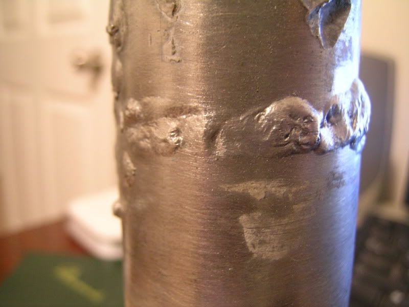

« Reply #20 on: October 20, 2009, 12:57:39 PM »
heres one of my first aluminum welded pipes with oxy/acetylene.
its a flux from tm2000. the flux is cheap the rod is cheap. but the goggles are a couple hundred.
the flux burns and puts out a different kind of light.
