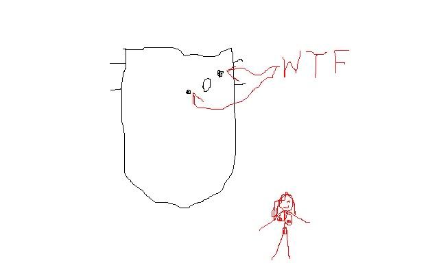

Didn't think to take a picture but am about to place another order for shit I need.
Anyway it's on the transmission side of the block (B18A) near a coolant hose port that goes out the side of the block at a 90* angle.  Has two holes diagonal from each other near the port and being that they are "open" on the other side and proximity to the coolant pipe, I'm assuming they will spew hot fluids into my eyes causing injury to myself if I do not put whatever should go there in there.
If nobody knows I'll just put some bolts in, but I know one of you fuckers knows...

On the head I ASSume.
Towards the front of the car or the rear of the car?
Which head are you using?
The only thing that comes to mind from your description and your shitty ass pic is the coolant inlet that should bolt to the side of the head where the upper radiator hose attaches.

I will get real mufuckin legit pics tomorrow.
Fuck mspaint

One of them is for the coolent temp for your gauge,(the one on the left, its 1 wire) and one is coolent tep for your ecu.(its the one on the right and its 2 wires)

The temperature sender for the gauge cluster goes in the lower hole.  The coolant temperature sensor for the ECU goes in the upper hole.  You can rob both of those form a D series.
