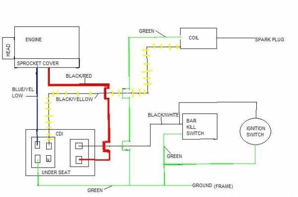

« Reply #1 on: March 23, 2009, 08:33:02 PM »
if its CDI
if its Magneto
http://odmods.webs.com/80wire.gif]http://odmods.webs.com/80wire.gif
Hope it helps
