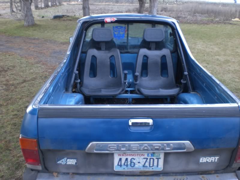

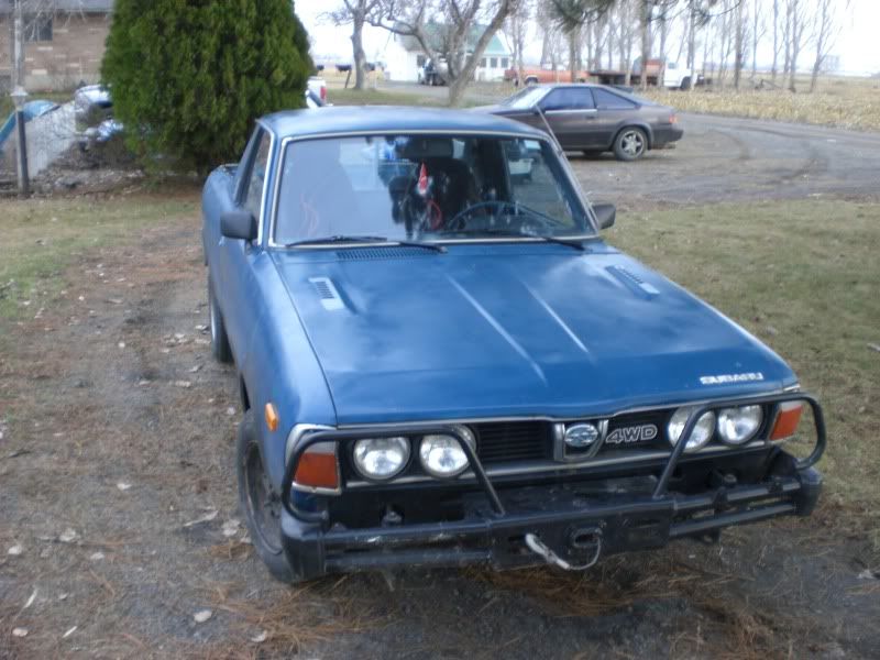

pictures of said brat that i bought. its a 81. 1.8 carb, 4high/4low, 4speed, rear seats, factory bumper and winch, runs good.
rhmt for life

« Reply #18 on: February 14, 2010, 05:17:33 PM »
damn, that shits clean. dont think i could drive it in the salty snow and ruin it
Re: 4WD not working wtf!
« Reply #19 on: February 14, 2010, 05:45:55 PM »
I want it.
« Reply #20 on: February 14, 2010, 06:41:08 PM »
Yea, you can't find cool shit like that in FL.
« Reply #21 on: February 14, 2010, 07:31:48 PM »
Wow that winch bumper sexually arouses me.
BTW, they all came with the rear seats.  Subaru cheesed those in there in an attempt to bypass the truck tax of the 80s, and it worked.
ya i know that it, it was callled the chicken tax
more info on the tax
"The Chicken Tax — actually a 25% tax on potato starch, dextrin, brandy, and light trucks"
"Passenger cars imported into the US were charged only a 2.5% tariff, compared to 25% on light trucks."
a lot of them have been removed. but if you look around can pick up a set for about 100-200$.
