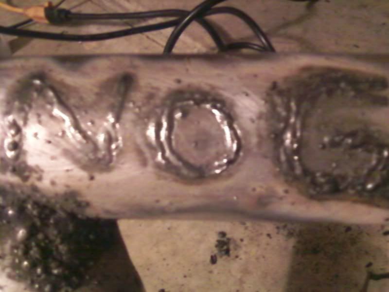

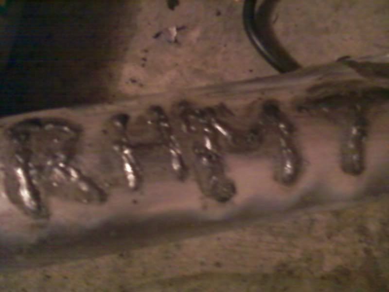

i kknow its ugly as shit but oh well the welder only cost 60 with rods,mask,gloves,hammer, and brush
this is a 70 amp arc welder from campell hausfield with hf quick strike rods. i was just practicing and made this shit

Looks better the Buk's so far.

what rods are you using? 6010, 6011  7018 or what.
i its a 60xx rod run it down hill.   if its 3/32 which im assuming it is max the machine out and run it downhill.
if your welding with 7018 then u wan to run it uphill.   u will not get shit for results running the rods in the wrong direction.

I run 6010 uphill all day, in fact you can get run off a job for going downhill with it...unless of course it's a pipeline.

i root pipe uphill
i weld casings downhill.
the shit hes welding run it down.

For what he's welding, I'd get some 7018 and go to town. Much easier to run than 60** for noobs

6013 is my rod of choice for newbs.  especially ones that burn lots of holes

these rods are hf quickstrike 6011s 3/32. i bought some hobart 6011 3/32 that just plain suck ass. this pipe that i welded on is just some autozone piping i imagine its just standard galvanized steel so i bought a generic rod for it
