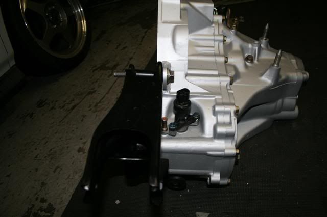

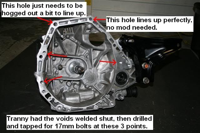

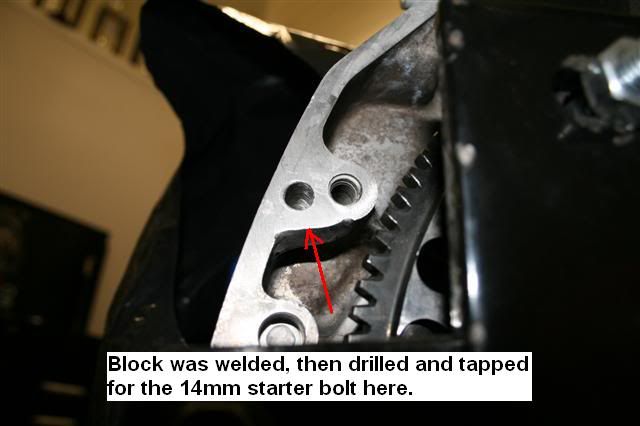

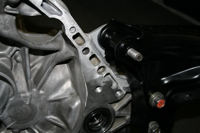

They had Competition Clutch drill a b flywheel for a d crank.  The part number is:  2-694D-ST
All this b series stuff was also needed...
shift linkage
rear t-bracket
tranny mount and rear mount
starter
intermediate shaft
axles
clutch

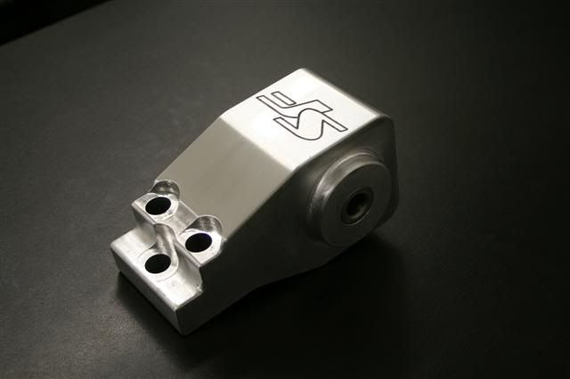

They had to make a custom drivers side mount because the trans swap shifts the engine over toward the passengers side about an inch...
gsr
Handcuff?
Idk on that one...
« Last Edit: July 20, 2010, 08:40:08 AM by Foowee »
