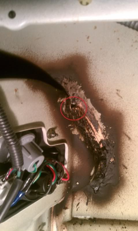

95 Civic 4 door.  I keep getting water in the trunk.  I've pulled the pannels and the water is coming in from here:
It just seems to seep in.  The tail light gaskets are fine, and when I pull out the housings the gaskets are dry.  I tried to spray some rubberized undercoating, but it rained before it got set up good.  Any guesses?

weld the hole and paint it

New trunk lid weatherstrip..?
Re: Where's this fucking water coming from?
« Reply #7 on: February 13, 2012, 06:37:51 PM »
This is my thought as the corners have been rtv'ed down before.  The strip looks good, no cracks and the rubber is in decent shape, but I think I'm gonna go over what someone had previously done before with fresh and see what happens.
If thagt doesn't fix it, then the flex seal shit it is because clearly rubberized undercoating isn't the same thing, lol
