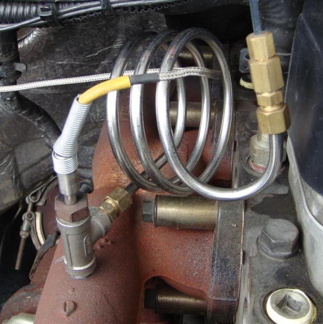

Re: Something Different TWO STROKE TURBO!
« Reply #36 on: April 13, 2009, 11:05:53 PM »
Not mine, I have two separate holes, but I wish I would have though of this. Good pic to show exactly what I was talking about, looks like he uses SS tubing though.
