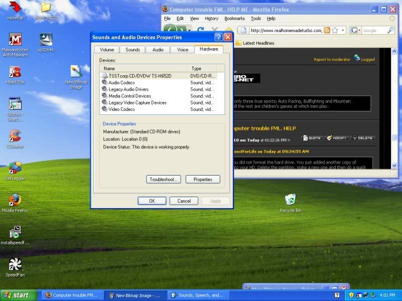

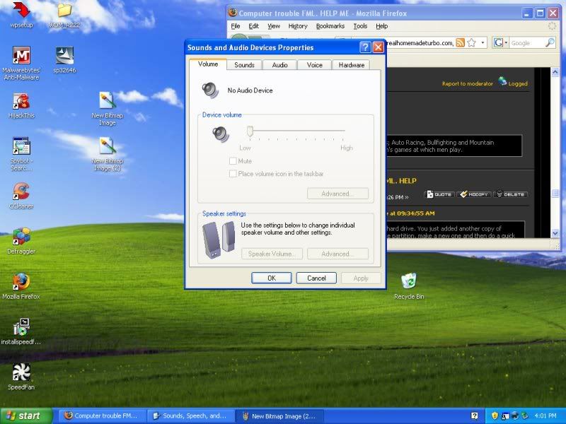

Still bloken  >:( >:( >:(
is this what you want me to ss?

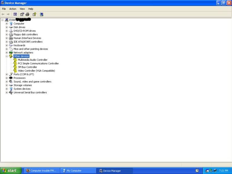

To open the device manager, go to My Computer, then View System Information, then click on the hardware tab on the top, then click on device manager. This is my Vista device manager, XPs should look very similar. Not the fingerprint scanner driver is not installed so it has a yellow exlcamation mark. LMK, screenshot it.
Did you try the UAA bus driver install first? and then the audio?
Evan
  • Posts: 159
Re: Computer trouble FML. HELP ME
« Reply #13 on: April 23, 2009, 10:25:25 PM »
here you go.

Go onto that screen again (device manager)
Right click Multimedia Audio Controller
Update driver
Yes, this time only connect to whatever, next
Install for a list or specific location (advanced), next
Check the box that's labeled "Include this location in the search" and navigate/browse to the extracted realtek folder, select WDM folder if there is one inside of realtek one, next.
watch it install, if it doesn't you're doing something wrong. If a message pops up asking to continue, click continue installation or some shit like that.
Report back what happens.
