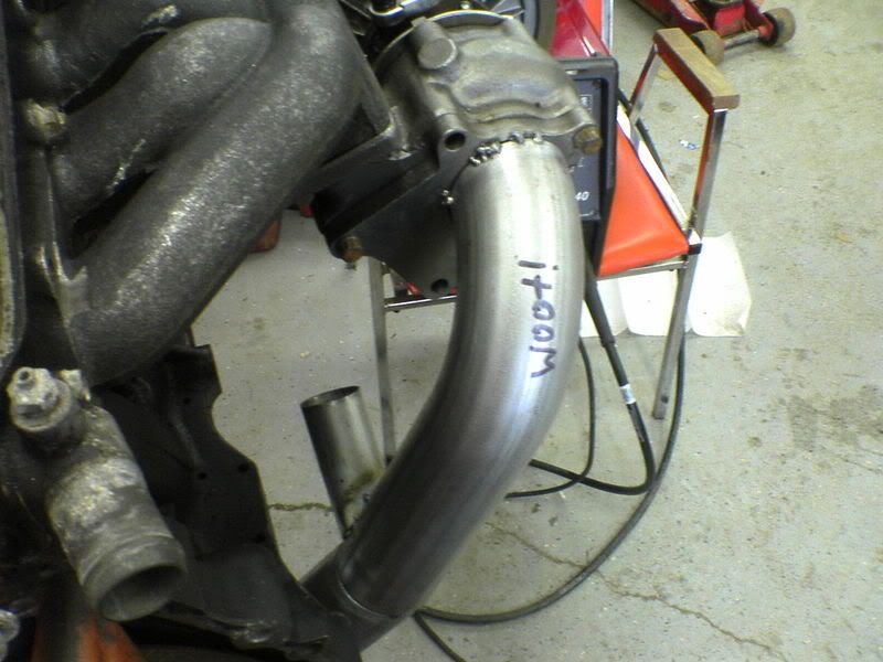

pic of said rerouting?
here is how i did mine but never made it to a running car to test it out, will be on the 4dr in a week or two.
i think ill redo the DP make it AC and PS friendly but it will be hard to plug it back in far down the DP since the turbo will be the other way
