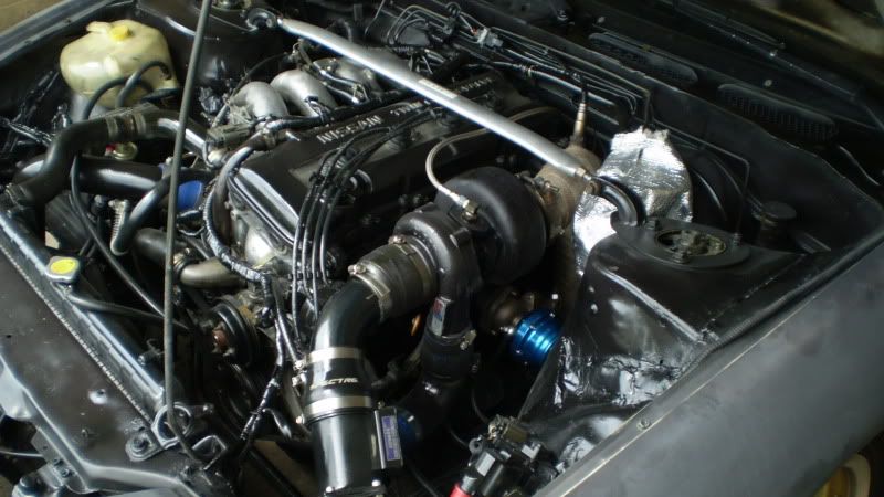

Setup # 3  ( current and most stable )
Summer 2006
Well i found the H1c that i wanted for this particular setup. It came from an 93ish dodge ram... the smaller of the H1C's.
Holset H1C turbo
Tial 38mm wastegate
3in V-band custom dump/down pipe
jgs tools custom stage 1 manifold
dsm bov
detachwork 480cc injectors.
safc1
aem uegowideband
greddy Full auto timer
ssac fmic
earls oil line fittings
summit racing SS oil line -10AN drain
AutoMeter -4AN feed
JGStools adjustable Oil pressure kit
NGK copper plugs (gapped to .033)
N60 MAF
255 pump
located a great place on ebay that was ironically in my state. So i went there to hand select my H1c from a few others... its was a freaking gem for sure.
TURBOCHARGER MANUFACTURER: HOLSET #765
TURBOCHARGER PART # 3522900
TURBOCHARGER MODEL # H1C
OIL COOLED
WEIGHT: 19
EXHAUST WHEEL DIAMETER - 60mm.
COMPRESSOR WHEEL DIAMETER - 45mm.
I did the math for the trim and came up with 56 but that was just with the numbers given, i really wanted to measure the size of the inducer and exducer and get the proper number for both sides.
I thought the revhard would yield me the space i needed to clear my BMC but it was a big no go....

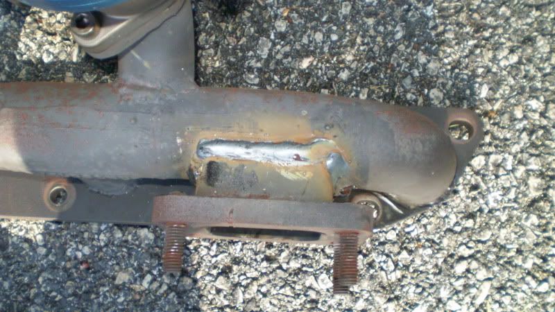

So i picked up an JGS tools stage one kit and with the help of a buddy and his tig we welded it up
i placed the turbo about right here. My hands are not dirty, im just black  :P

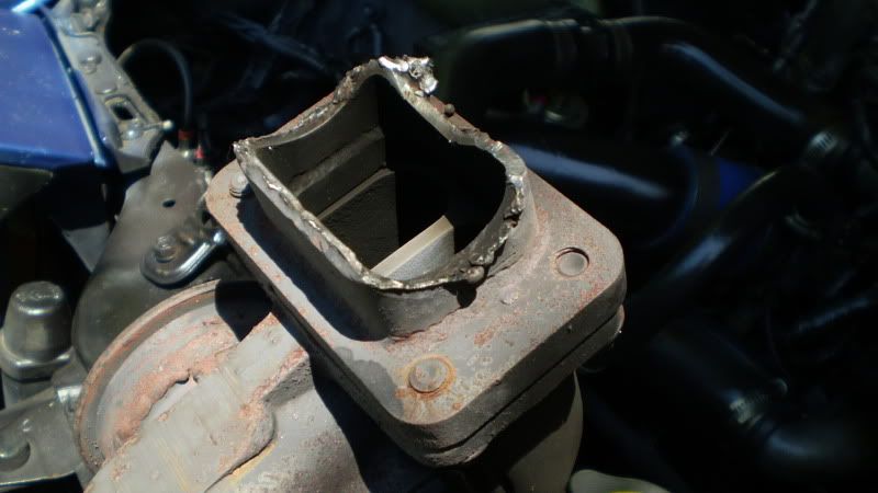

another issue i ran into was, the v-band clamp.... so i welded the v-band flange to the cast after heating it up.
these blobs were just to hold it on until i got around a mig with gas... I beat the shit out of it with a hammer and it stayed on....... so i was satisfied.
went to my buddies house and we hit up the once piece down pipe along with my manifold.
( these pictures jump in the future a little ways from this night due to the fact that i had no extra batteries but you get the idea of what the manifold look like)
i knocked the junction block off while drifting so we had to re-weld.... layed it on thicker this time no issues ever again
install was done in one night... not really anything spectacular..
the last thing i added to it before going to Japan was a Tial WG, hallman MBC and wrapped the exhaust and BMC
204hp 218tq 8psi @ with 5500rpms rev limit set : My street tune with not so good crossover from low to hi maps
