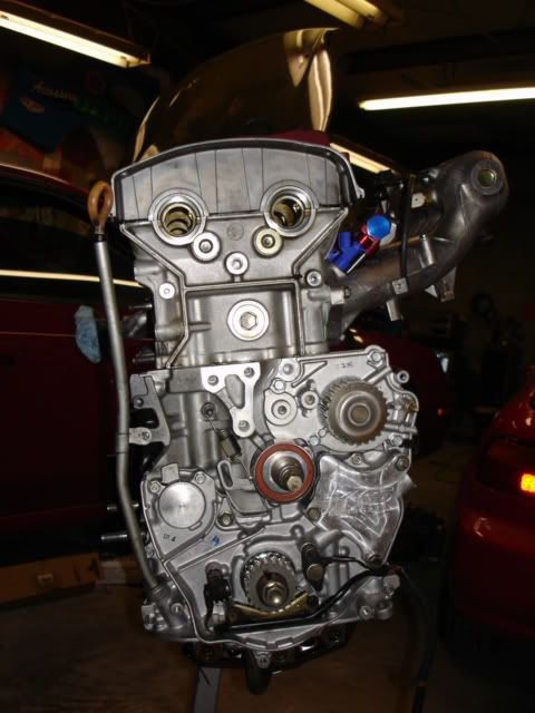

anyway, enough talking and on with some pictures.

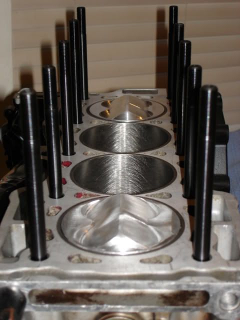

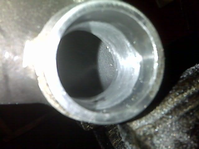

^^ after 1500 miles with crower cams and eibach valvetrain from a head i got online.  fortunately I had a spare head!!
that is the gist of it.  I'm currently inspecting and measuring my spare h22a block and crank so i can rebuild it just in case this h23 goes sour with the addition of the JRSC.  That block saw 8500 RPM routinely.  I mic'd the rod journals and all of them are .0001 to .0002 of each other so that made me feel really good and the mains damn near match the OE bearing specs.  I measure the PTW last weekend for cylinder 1 and 2 and both meet the factory clearance.
I'm new to using these kind of tools and getting accurate measurements consistently  i guess is just going to take time and practice.  My PTW went anywhere from .0004 to .0010" all due to taking an average of 5 piston measurements and having one measurement in those 5 that threw everything off.  I'll get better.
more to come in the future.

You think you had the lash too tight, thats the symptoms that I see with rocker pad wear.

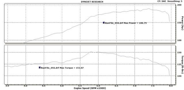

upon installation the clearance was in spec.  I ran a few heat cycles and redid the lash and didnt check it again until i pulled the head apart 1500 miles later to do the h23 build.  The valvetrain was a little loud but i figured it was the uber stiff valvetrain.  Its really hard to tell what the problem was.  I dont think the head was in too great of shape.  After i pulled the head off, i noticed a beveled lip around the number 2 combustion chamber like it had been smacked, but there was no other visible damage and the valve seats looked like a typical used head with carbon build up should look like.
This is the dyno with the cams:
then this was the previous dyno with the stock cams when i did the EuroR IM testing
It was just bad from the get go and there are just so many possibilities of what it could have been so i just put it all behind me as a mystery that will never be completely solved.

Had the same thing happen to my shitbox.  Lashj to spec... Ate the exhaust vtec lobes worst (looked JUST like those). I swithched to Royal purple after doing a bunch of reseach about oil additives as a last ditch effort before going roller... 10-12 K later... Perfect.

i had been running mobil1 in the car for i dont know how long.  Switched to Amsoil and was still running that oil when i pulled it apart.  I have no idea if that had anything to do with it but it made me go on a tirade of reading about oil analysis and i now wont run anything but Torco with ZDDP additive.

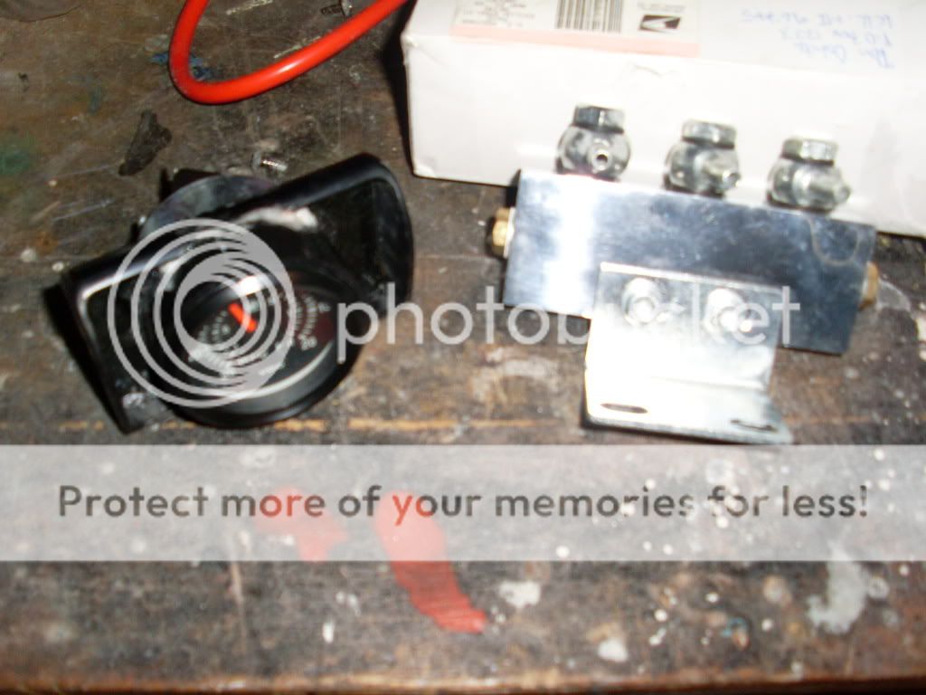

update but nothing really special other than actually enjoying DD'ing my car now.  If you read the first post you would see the clutch line setup hat i'm running that apparently king motorsports uses on all their civics and never have any issues.  Well they are going to be getting a call from me.  I'm gonna try and get credit or my money back because i switched to a smaller (-3an) clutch line and ALL my shifting problems went away.  I mean its night and day.
Beyond that, i paid 100 dollars for the line from king.  And they are not even DOT approved.  Today i paid for better quality line, DOT approved, and a better hose end crimp.
I've still got the wilwood check valve installed as well.
i'll post a picture of the King line tonight.
