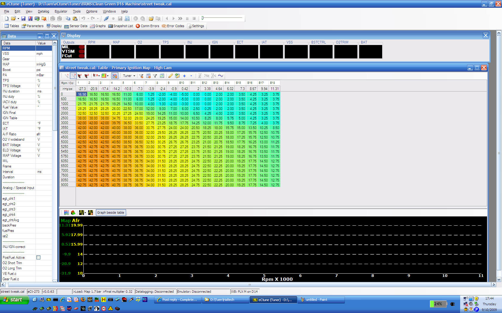

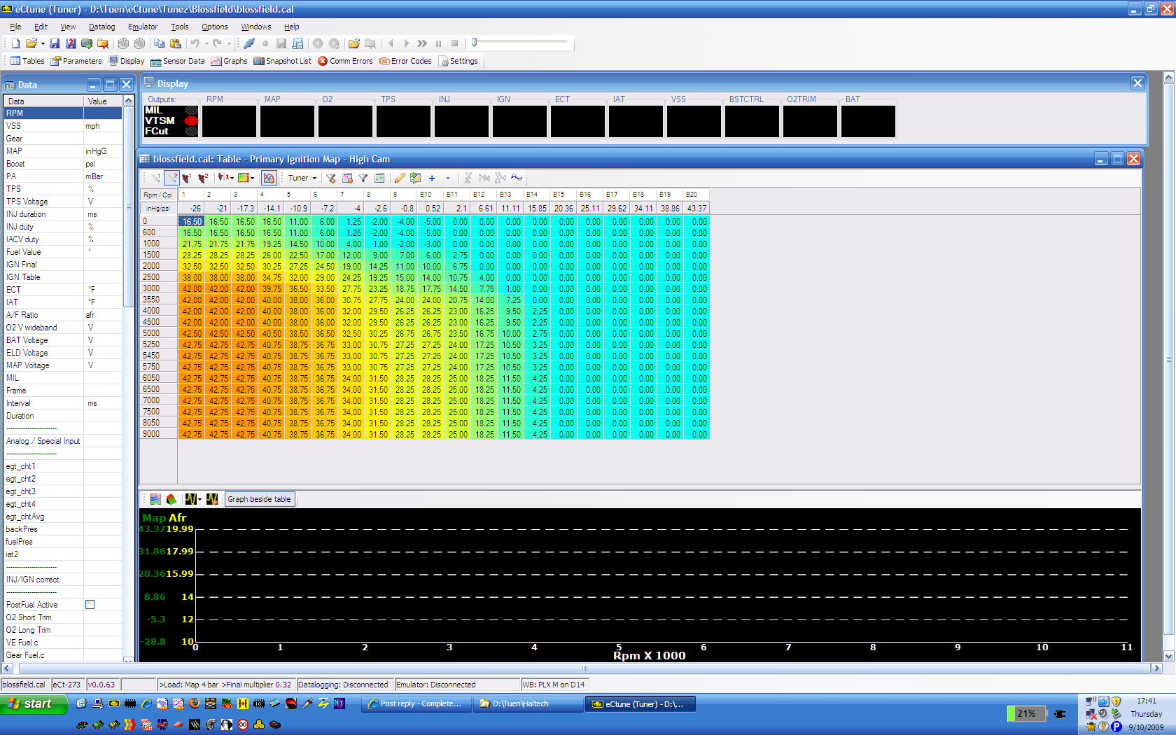

Here, pictoral proof.  Stock D16Z6 final timing is 28 degrees.
305 whp at 12 psi mutant D16Z6, probably running ~9 degrees timing.  That's 1.6 deg/psi.
Above average 240 whp @ 10 psi Z6 with ram horn, etc. 12-12.5 degrees timing.  That's 1.55 deg/psi
Fresh D16Y8 with an Edelbrock kit, 8-9 psi IIRC.  It might have been 10 psi?  It made 215 whp, nothing special, I remember expecting more.  Let's call it 10 psi, 14.5 degrees final timing.  That makes 1.35 deg/psi.
D16Z6 Vitara motor, 7.5:1 CR, DSM T25.  The dictionary definition of friendly and laughs at detonation.  Spikes to 20+, tapers to 12-14 psi because internal gates are for Volkswagens.  195 whp 210 wtq tuned last year, set FTOD at the auto-x last month.  Call it 13 degrees final timing, that makes 1.1-1.25 deg/psi retard however you want to slice it.
How the hell?? I set a map for 1.25 deg/psi, and I had weird break-up issues. ADDED timing, something akin to .8 deg/psi, and it cleared up completely. Dyno graph was all jerky at 189whp, S-trim t3/t04b, 3" exhaust/cutout, ~8:1 Wiseco/Eagle D16z6 (stock head). I know what detonation sounds like, and I get zero. I have the ability to hear it loud & clear with my cutout closed.
I'm starting to think there's some weird problem with my car, like the belt jumped a tooth or the valves need major adjusting. I can't understand it though, it's driven & idled perfect for the last 10k miles. There's absolutely nothing wrong, it just doesn't make much power. No weird noises, no afr or temp oddities, no apparent ignition issues.
Got a picture of the dyno graph?

« Reply #19 on: September 11, 2009, 12:30:01 AM »
Tomorrow I'll have it up, I've been meaning to get it done for over a month. I'm only lazy with pictures, I swear. :-X You'll see why I was interested in cleaning my injectors when you see the graph, it's weird as hell. Same dyno, same smoothing, same motor, and smaller/weaker turbo setup on Crome and it was uber smooth.

Those are some interesting spark numbers, why are they so retarded at redline and full boost?  On my corolla im running like 23 degrees at 205 kpa and then 17 for 205kpa -250  Maybe its a honda thing.
« Last Edit: September 14, 2009, 03:20:25 PM by TTC »

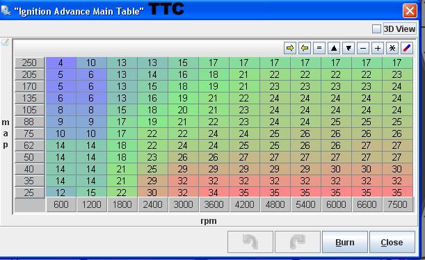

« Reply #23 on: September 14, 2009, 03:26:20 PM »
This is what mine looks like
It's an every engine likes something a little different thing.  Hondas like fixed timing in VTEC, unless there's something screwed up with how the engine flows.  Subarus like rich AFRs and a lot of timing, Evos are fine at conventional AFRs and single digit timing.  SR20s want next to nothing for timing at the point boost comes all the way up on a stock turbo, and then you feed it in as the rpms climb.  KA24 like timing smoothly tapered up as the RPMs climb up (whereas most not-NisAnd because I'm an intellectual being,  do not).  Fords like a gentle increase in timing as the rpms go up, more so with the mod motors.
If you re-read my post I mention the peak boost on each car.  What I do is start off with a conservative retard and add timing in for each boost level I tune.  At some point I call it quits and that's where the big step down to small numbers or zeroes takes place.
