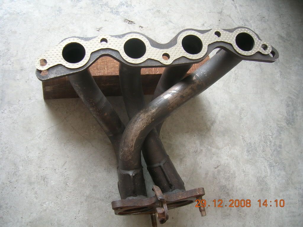

-i highly doubt anyone will be able to answer this but how much modification is actually necessary to mount a 4age exhaust manifold on a 4afe head? anyone work in a junkyard or have access to a 4afe and 4age and can mock it up?

Looks like the manifold should be a bolt on affair.
4AGE manifold
4AFE manifold
Weir flanges, some square pipe, and pipe elbows would probably get a manifold done on the hella cheap.

i may be wrong but im pretty sure the 4afe and 4age have different exhaust patterns.
AstroVannin
  • Posts: 625
Re: Turbo Questions on junkyard turbo prizm.
« Reply #4 on: September 30, 2009, 12:27:12 PM »
From those pics they LOOK the same ... but could be deceiving
can someone elaborate on this??
« Reply #6 on: October 02, 2009, 06:10:00 PM »
i looked it up
4afe= fel pro #MS94129
4age=fel pro #MS92939
so no, not the same
*ok so i found a thread on c4ag that was saying they do fit each other but one of the outer holes has to be slotted to fit
http://forums.club4ag.com/zerothread?id=37168
« Last Edit: October 02, 2009, 06:14:56 PM by t_cel_t »
