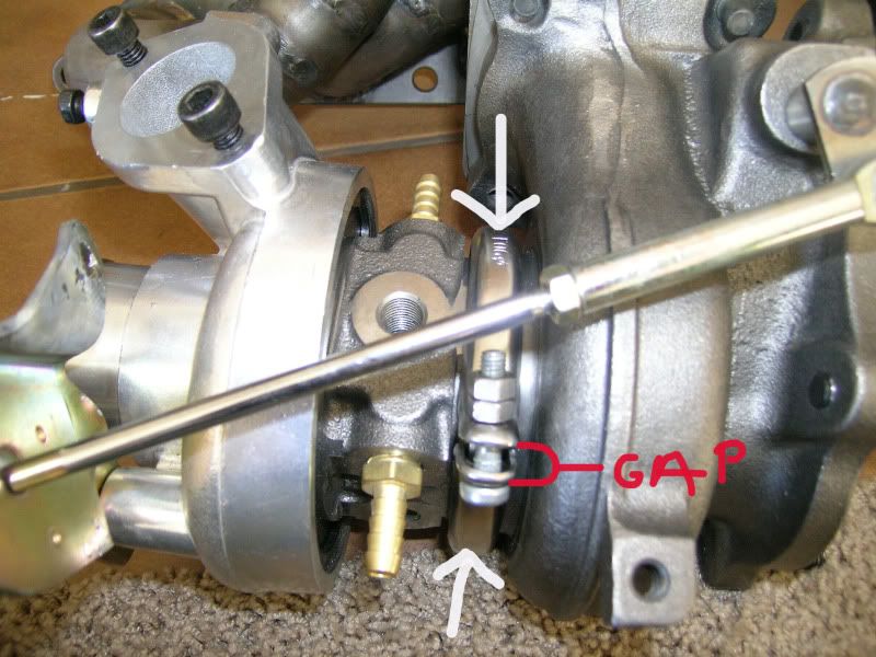

when i took my turbo out i didnt really notice oil leaking from the oil lines. its possible but i think i would've seen oil cooked on the turbo. however i think this center section here is or was leaking.
if you would take a look at my cdm turbo and tell me if you think that this center section is tightened down enough just
from looking at it. thats pretty much how tight it was when i pulled it out.
if you see the gap in the pic. i tightened it down and completely closed that gap.
it didnt seem to want to go easily but i forced it. haha.
can oil come from that center section or is it coming from my oil line connections.
thanks

If your turbo is working properly, oil should not come from that band style center section.  Check your fittings.

ahhh nice, thanks.
that tells me where its coming from then
