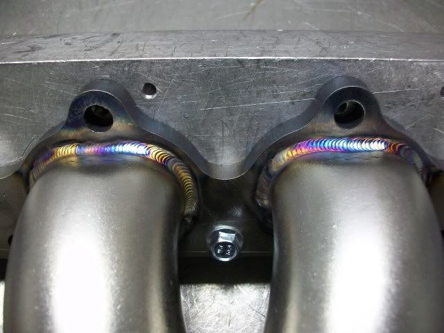

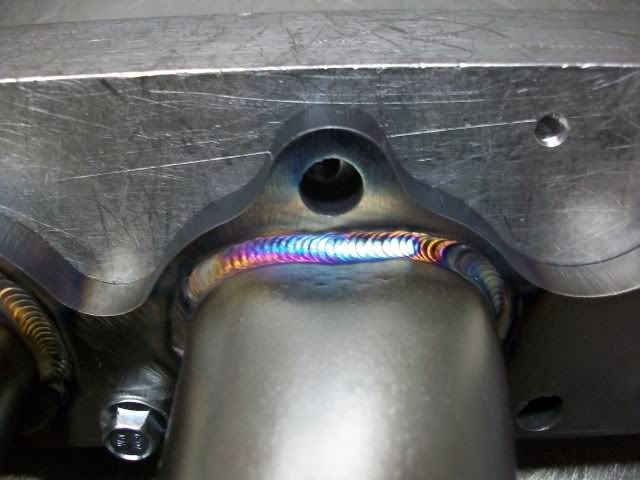

by the way all those sweet CNC'd 1/2" flanges are really only .450 thick because they loose .050 getting milled flat because they are made from crap hot rolled. ill stick with the 3/8 joints for 50% less  :noel:
aaron just make sure they use the same steel on the 1/2". look how baller your 3/8" flanges welded tonight  8)

Wow, that is some hot action Corey. Ill be down this weekend to pick up those flanges!
