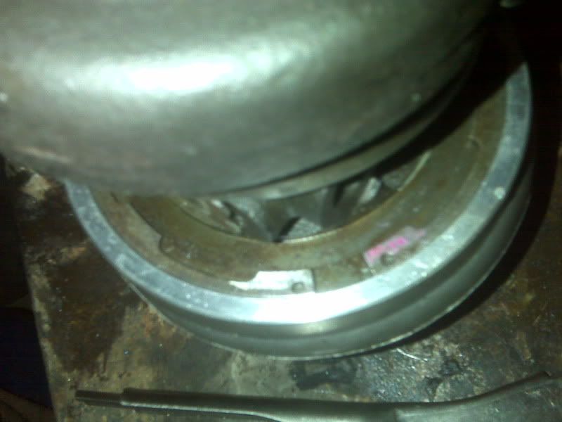

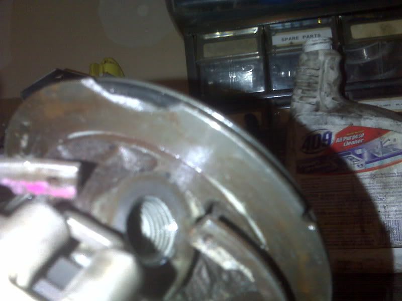

so, see how the turbo is keyed??? didnt notice that.  so i clocked it, and went to put the snap ring back on... the compressor housing didnt seat, and so i thought it was just a little tight from never being taken apart.. tapped it with a hammer lightly.  well the little round keyway broke the damn metal somehow... you think it will be okay?? the rubber still is in tact and seals up, but that section is taken out.. ill try to do my best in paint hah
normal... keyway is highlighted...
and im trying to draw what i did!
i just drew the white over on the other piece to show how big it was, but its actually on the other side of the turbo where the arrow points... do you think it will be alright with that section missing???

your good
Re: im an idiot, see if what i did isnt toooo bad.
« Reply #2 on: December 11, 2009, 06:15:29 PM »
The first problem I see is the turbo size - too small :P
The real issue could be the pressure pushing the o-ring out to the snap ring. If you can use something like JB weld to reform the lip, or glue the chunk back in, it should keep the o-ring in place. Just make sure you use a dremel tool to grind that key out of the cover.

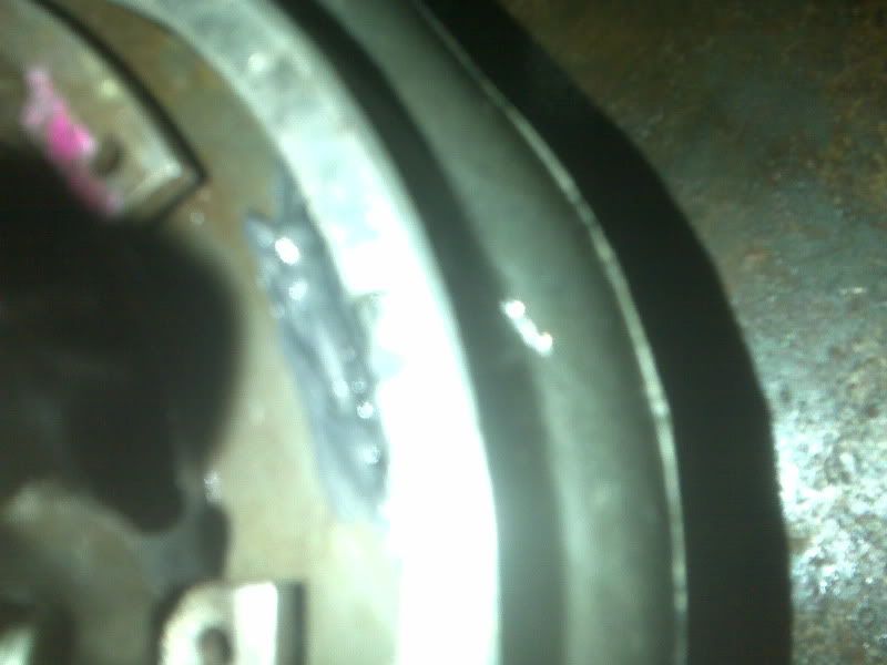

dude i did the exact same thing to my 14b the other day. like a week ago. and i almost posted a thread about it too.
hahah.
anyways heres what i did.
i just put some high temp gasket sealer where the break occured and then continued on.
i think it will be fine. i was pissed when that stupid snap ring wouldnt go in so i started banging it.
then i finally took it apart to see what the hell was stopping it and i saw this.
not happy. i just bought this turbo a few weeks ago.

hahaha yeaaaa exactly what mine looks like!
